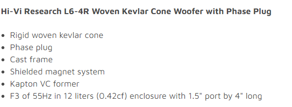

I have change my plan from a single 8" F8 drivers to a W(CM)W design. The plan above is with two Hivi L6-4R 6" mid/bass. There are two divider that seperates the midbass with the tweeter and midrange and they are closed. The volume for each bass section is 12.88 liters and tuned to 50hz with a rear port (3.5cm x 6.4cm long). I plan to use a adjuster port from Part-express so I can easily fine the port.

Below is the WinISD result
