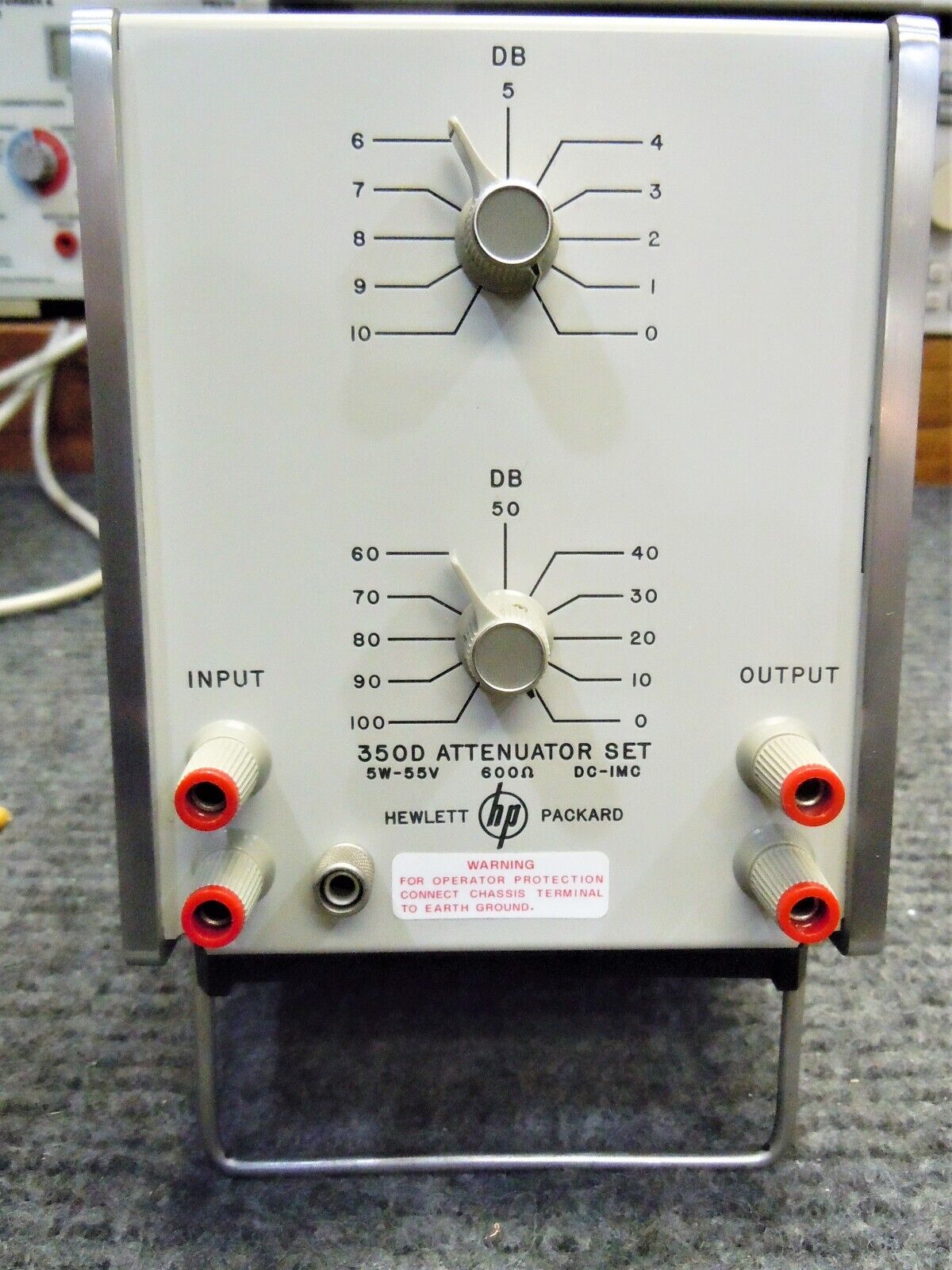

HP 350D Attenuation set
Jealous.

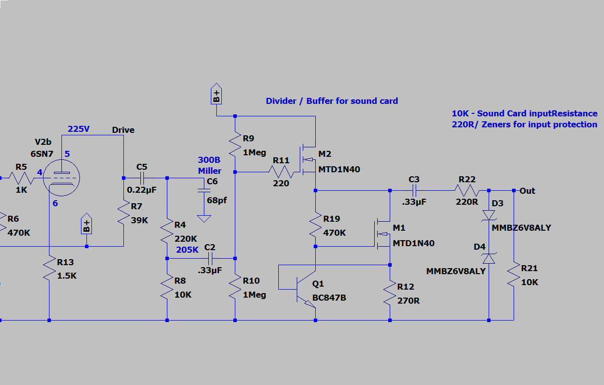

When feeding a signal from a HV source one should capacitively couple it to a resistive divider (representing the next stage input resistance) and again capacitively couple it to a buffer such as a FET on top with a current source on the bottom. Then couple it to a series resistor and a pair of low voltage (3.6V) zener clamps.
High voltage spikes when you turn on your amp can destroy the sound card. Don't ask how I know.
The resistive divider should be a high impedance one so as not to load the stage you are measuring. Choose the reisistive divider to give 1Vrms at full output (1Vrms or whatever your sound card will accept without it's input distorting). For example, my Xonar SE starts clipping on input at just over 1Vrms.
In my example, the 6SN7 under test is meant to drive a 300B, so I used about 230K for the divider in parallel with a 68pF cap representing the input capacitance of the 300B to drive the buffer.
Don't heavily load the UUT, or you will introduce additional distortion.
