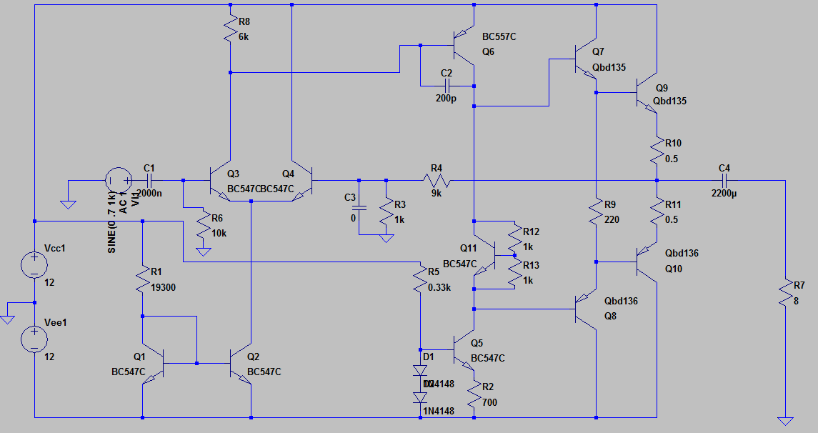

After building tube amplifiers for a while, and parallel to it, I want to design and build a simple SS audio amplifier. My target output power is just about 3W.
I'm about to build a JLH class A amplifier, and there're lots of good class A and AB designs out there. But in the pursuit of gaining understanding, I want to build something I can design and fully understand by myself. So, I'm seeking for some help.
Thus, I'm not looking for great performance, just decent sound quality, and on top of all, clarity.
I attached my design, as image and LTspice circuit.
The simulations seem good enough.
Suggestions are very much appreciated!

Well, there are a few points here. I don't know where the best place is to read up on the issues, but Self's and Cordell's books appear to be good places to start.
My "first thoughts" comments are:
(1) classical Miller compensation (your 200pF) and low input stage current (600uA per device in the input stage?) and 6k resistor do not seem to be optimum (the 6k needs 100uA, so the currents may be unbalanced) and likely to suffer "hard" slew induced distortion.
(2) I'm sure you don't really want 330 ohms feeding the bias diodes for the VAS load transistor which again is running low, (at around 1mA?), and too low to drive your compensation capacitor. More like 6k from 12v would supply 2mA which would be enough to bias the VAS transistor constant current load, which should probably run at 10mA. (Some would say 6mA but I've previously commented that I think that is too low too).
(3) Not sure whether BD139/BD140's can handle 1A with any gain. While some manufacturers rate these as 1.5A the gain spec. shows a fall-off at 500mA. I'd recommend using higher power output transistors. Several TO-220 types available.
(4) Current mirrors need balancing resistors (input stage tail current) as thermal coupling is not 100% and transistor mismatch can give rise to big variations unless carefully matched.

Since you have chosen to capacitor couple the input and output (which I think is a good decision for a first project!), you have the opportunity to simplify the power supply and save some big heavy components. Rather than plus-and-minus 12V, how about +24V and ground. Only.
I agree with the earlier commenter who suggests emitter resistors for Q1 and Q2, to ameliorate the effects of not-perfectly-matched transistors. The standard advice is to choose resistor values which give about 500 millivolts of voltage drop across the emitter resistors. Since you're already using LTSPICE, the necessary experiments are quick and simple.
I also recommend that you use LTSPICE to study the DC collector currents of the input transistors Q3 and Q4. Douglas Self's book is correct: you want these currents to be equal: within 1% of each other would be ideal. You may need to adjust R1 and/or R8 to get the perfect balance you seek. Remember that this will affect the gain of the amplifier as a whole.

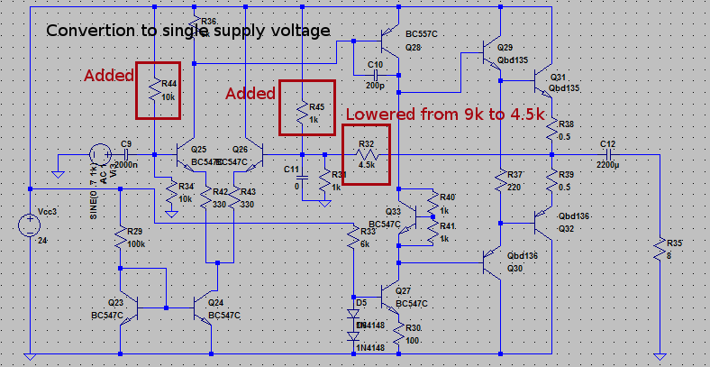

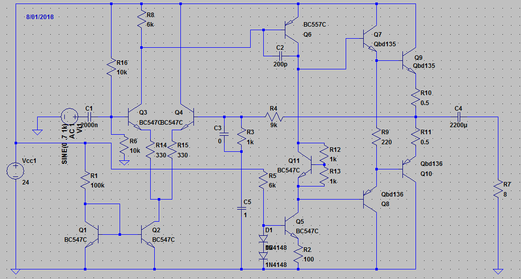

Following all of your advices:
- I added emitter resistors to LTP. (50 millivolts quiescent voltage drop)
- I balanced LTP currents, lowering the tail's CSS current.
- I raised VAS CSS current (>6mA) and lowered diode biasing.
Finally I thought on using to-220 tip31/tip32 instead bd135/bd136.
Now, I had some trouble making the single supply voltage modification.
I attached the related changes. I might have done something wrong.
Even though I suppose, I don't really fully understand why I had to half the feedback resistor from 9k to 4.5k.
The 1k feedback return needs to be AC coupled. This pretty much essential on a single rail amp because to not do so effects the biasing of the stage greatly. This is why you are having to 'fiddle' the operating point by altering other values around it.

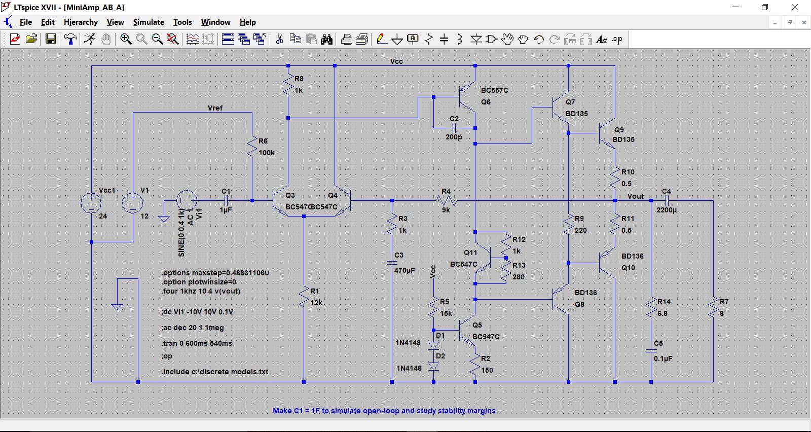

Have a look at this as a basis to work from. Points addressed...
1/ Input biasing is derived from a stable reference voltage rather than the main rail (which would allow injection of noise and hum into the amplifier input. The reference voltage can be a suitably decoupled zener, perhaps higher in voltage than needed, and with a preset to allow adjustment of the midpoint voltage.
The input impedance is now much higher as well.
2/ The LTP tail has just a simple resistor at this stage.
3/ The feedback return is AC coupled.
4/ The diodes are now fed with around 1.5ma
5/ The VAS current is increased to around 3.5ma via R2
6/ R13 is set to give around 40ma bias current.
7/ A Zobel network is added to the output to correctly terminate the amplifier by appearing as a load of reducing impedance relative to frequency. This greatly aids stability.
That was it! Thank you.
I just placed a huge capacitor, to fix the value later.
Use this circuit instead of the one I originally posted.
24 V single supply, and all the recommendations you guys pointed out.
(I posted this before seeing Mooly's previous post)
Definitely it has better performance than mine!

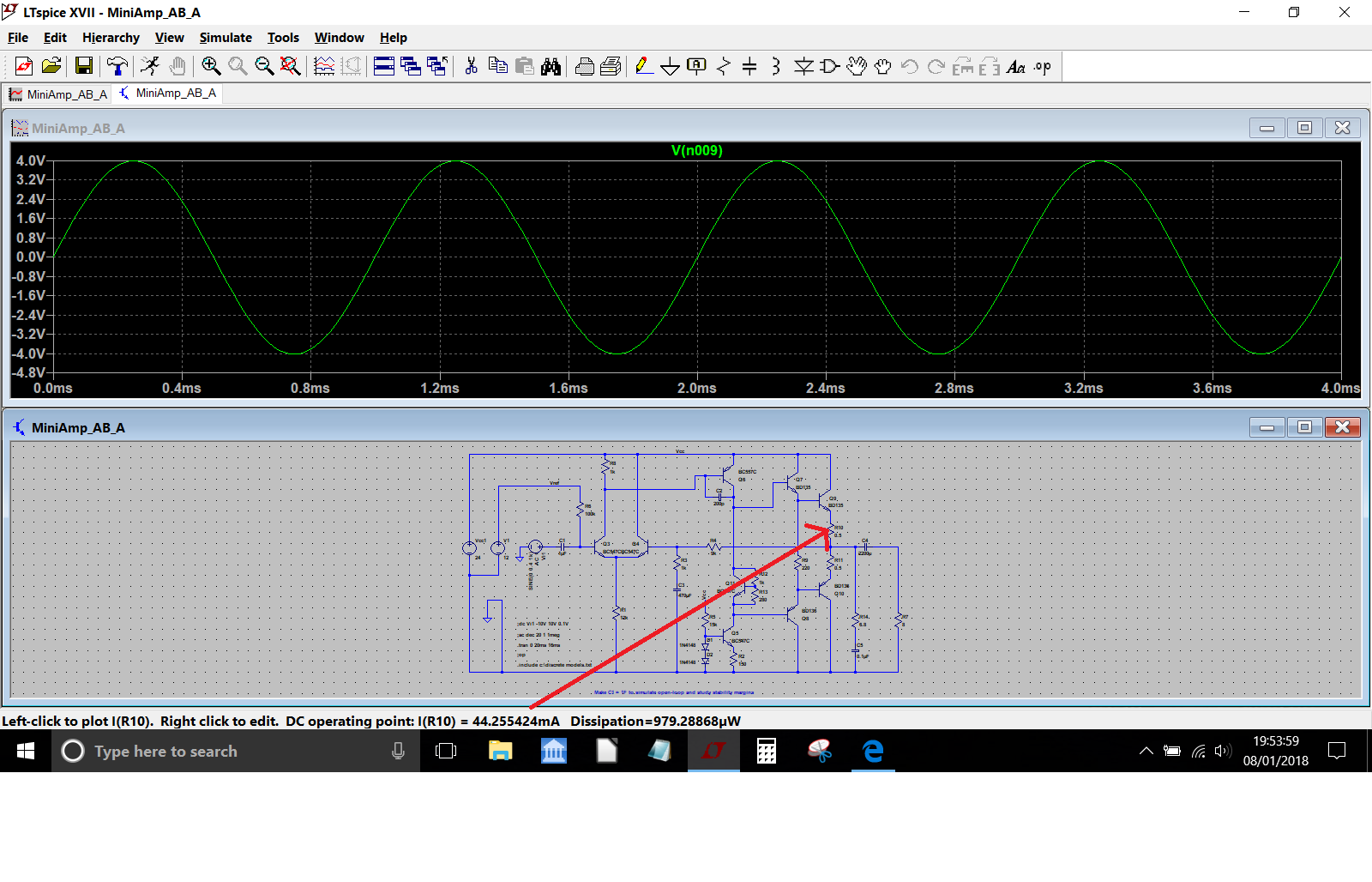

The only point I don't get is :
"6/ R13 is set to give around 40ma bias current."
The output transistors are idling at 9 W, and almost 800 mA bias current.
What 40 mA are you refering to?

In my simulation I set R13 to give a current of around 40 ma bias (current in the 0.5 ohms). This setting is hugely transistor dependent (and model dependent in LT) and so you must adjust to suit the devices used.
