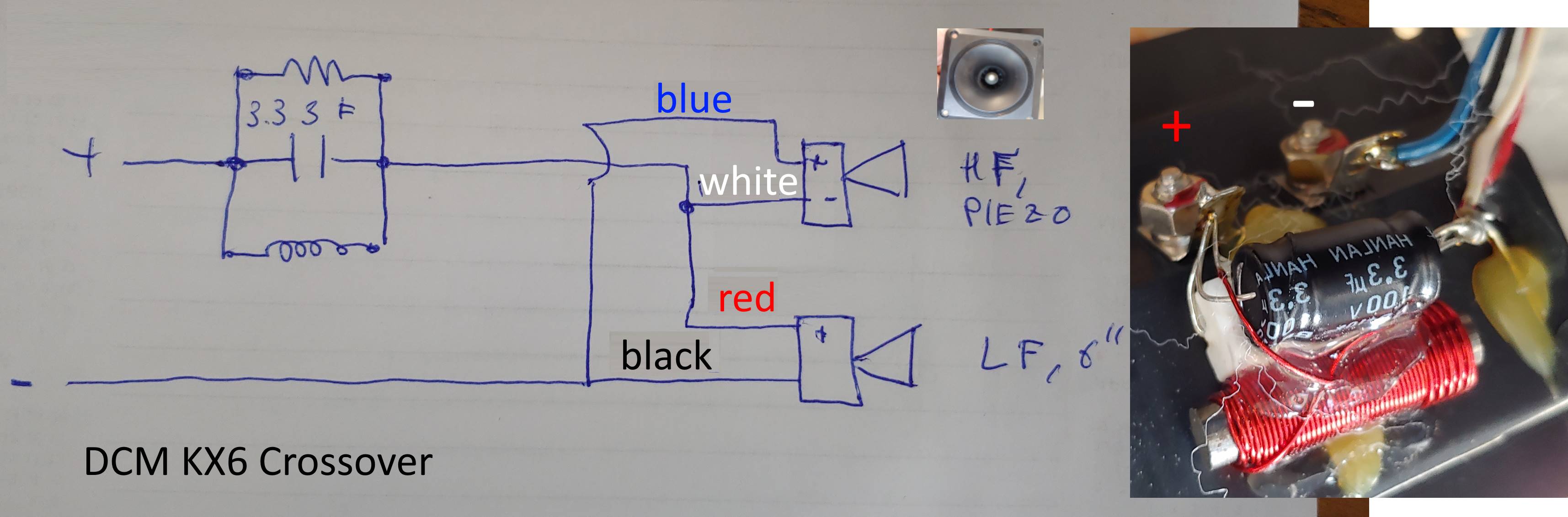

One of the motorola piezo tweeters of my DMC KX6 ( a sealed two way 6" woofer). The woofers seem to be ok, but upon testing with the meter, one of the tweeter reports as an open circuit. So time to upgrade.
1) I am looking for suggestions on what tweeter / super tweeter to use. Cost is an issue and I would like to be below $50 for tweeter and hf cap.
2) I was looking at the existing crossover and I do not understand how it works. Can any one elaborate?
