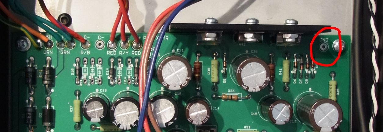

Dual screen windings (The first one, which is closer to the primary is directly connected to the core, which should have an electrical connection to the chassis and thus to mains earth. The second screen is meant to be connected to signal ground. This provides an even improved isolation from mains noise.)
I specified the first electrostatic screen to have an electrical connection to the chassis and thus to mains earth. I did this because this is how Thomas Mayer specifies his and I am using Tribute Transformers so I do want quality. VinylSavor: Power Transformers
My question is how does this affect my build, before I submit payment? Do I need additional steps to ground the chassis? If so how? Do I connect the chassis to the second ground in the attached photo?
Although it sounds as though it's more than they can handle.. did they understand it was for full-wave rectification?The 640vct @ 400ma is a fairly large VA and will heat no matter
Probably not. It wasn't Heyboer that sent me that response though.
With Heyboer I sent them the schematics. My main concerns are grounding the chassis and stray flux with a steel chassis (Hammond 10" x 17"). Steel since their aluminum is only 1mm thick and my Tribute OPT are heavy
