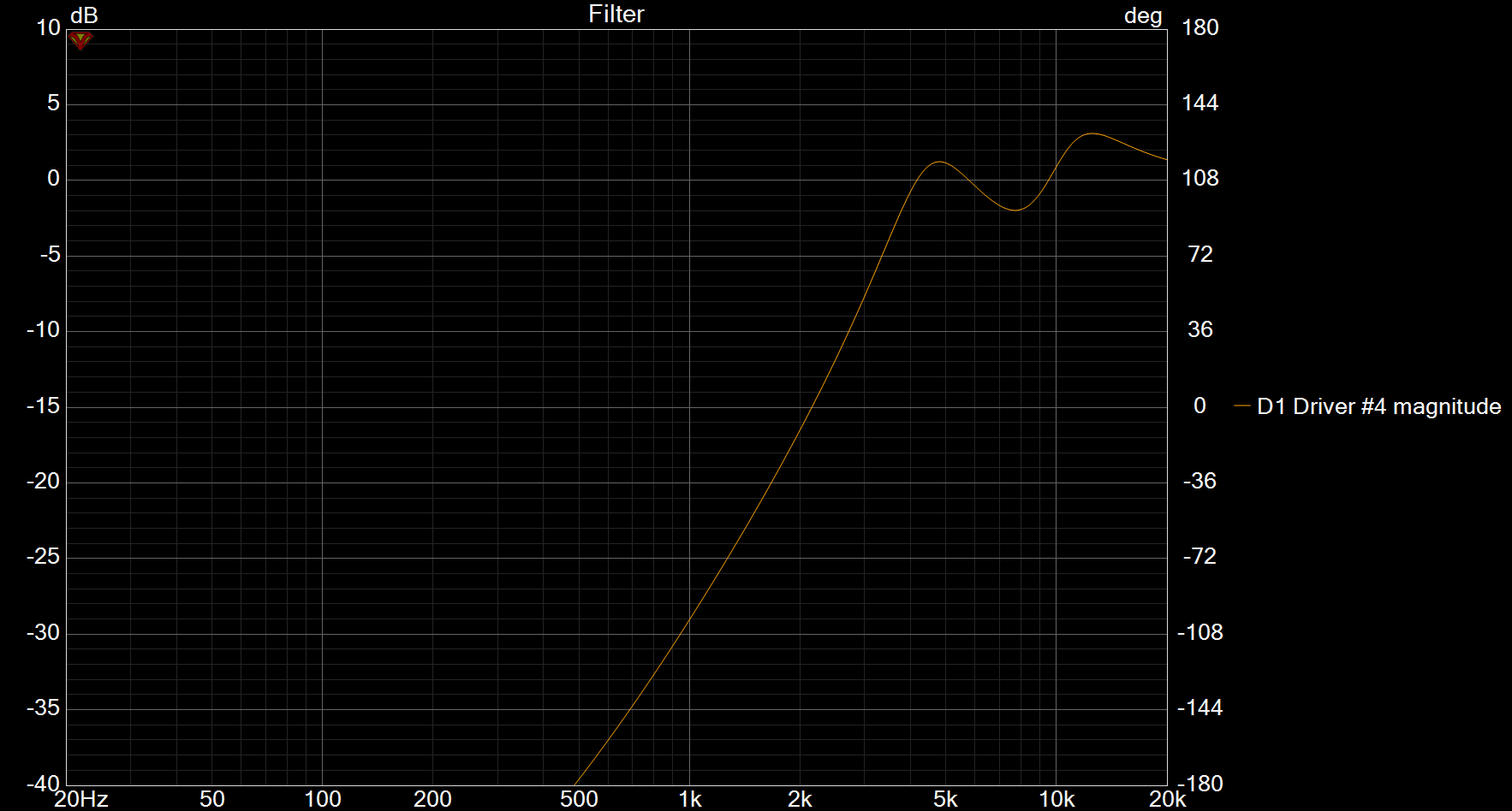

Trying my luck, and learning, to design a crossover for some drivers that I ordered and going to install in my car. I have chosen the Dayton Audio AN25F--4 and RS100-4.
I want to design a passiv crossover to get the most out of the install and tried my luck in Xsim. Pretty steep learningcurve and a lot of fun trying to adjust, to a point 😉
Maid a screenshot of what I have done so far. But not sure why the overall-line is lower than the original? Also tried to set a crossover between 3000-4000 Hz, but when I want to lower the dB on the tweeter with a resistor it goes to sh**, and it makes a massive spike below 2000 Hz which results in a massive peak og dip in the overall-curve.
Anyone go any tips for a good starting-point?
And, oh yes I am a total rookie!😀

your trying to pad at the wrong spot...and this seems a rather complex x-over, i'd start over and try to use the minimum number of components until you make a better correlation as to what is happening when changes are made.

To my understanding, a resistor in series lowers the "volume" on the whole signal. So resistor R2 lowers the dB on the whole, and R1 lowers it on the signal in the interval set by C4 and L3.

Yes, it increases the resistanse and therefor the dB on the driver become lower. Like restraining the level of the sound.
The tweeter plays much louder than the midrange, so the tweeter-level has to be reduced.

well i'm not sure what to say, your system response looks anything but flat, i had a look at the drivers published responses and wonder why you even need to add a tweeter to the RS 100.
trying to design a x-over when there is no measurement of the driver installed in a box or in this case your car is only going to lead you farther off course but that's just my opinion.
This is what your filter is doing....meaning, if you had a perfectly flat tweeter and put your filter in place, your tweeter response would look like this. Decreasing the 3 ohm resistor in the series notch will deepen that valley.
Adding series resistance does increase the source impedance as seen by the driver, and thus decreases the damping factor. Typically, that is more of a concern for a woofer, not a tweeter.i'm likely not the best teacher but doesn't that change your source impedance?
pads can be series or parallel.
I have had success with a series resistor being the first component of the tweeter filter. I also have had success using an L-pad on the tweeter side. Neither approach is wrong. Heck, for the Elac UBR62 speakers Andrew Jones, a highly respected speaker designer, put a series resistor between the two capacitors of a third order filter on the tweeter circuit.
I agree.trying to design a x-over when there is no measurement of the driver installed in a box or in this case your car is only going to lead you farther off course but that's just my opinion.
Mount the drivers, then take frequency response and impedance measurements, then design the crossover.

As far as the initial issue, the massive spike can result from inductor values
And padding methods. Usually a parallel resistor is also added with the driver.
So it behaves more like a typical L pad / Divider.
The amount of padding is much like a typical L pad / voltage divider.
But you can also control the impedance.
Not much different than using a 4 ohm or 8 ohm or even 16 ohm L pad to change the impedance.
It is possibly to pad before or after the filter, of course the series resistor will change the behavior of the filter.
Sometimes it is beneficial to pad before or after the filter with a series resistor. But there is additional impedance
control by adding the second parallel resistor
The massive response dip is likely a phase issue at the crossover point.
Depending on the filter orders you can either flip the polarity of the tweeter or woofer.
Or change the crossover point. So their is no phase cancellation.

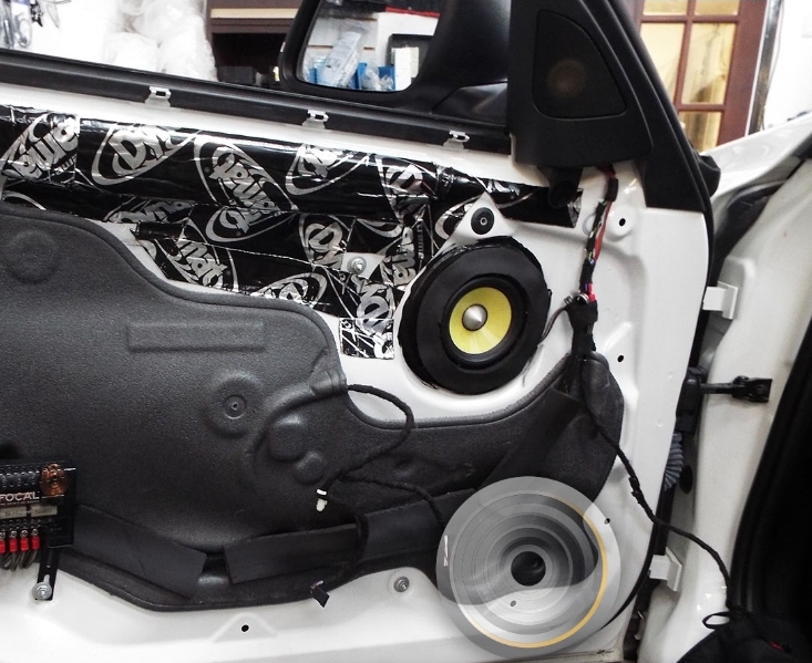

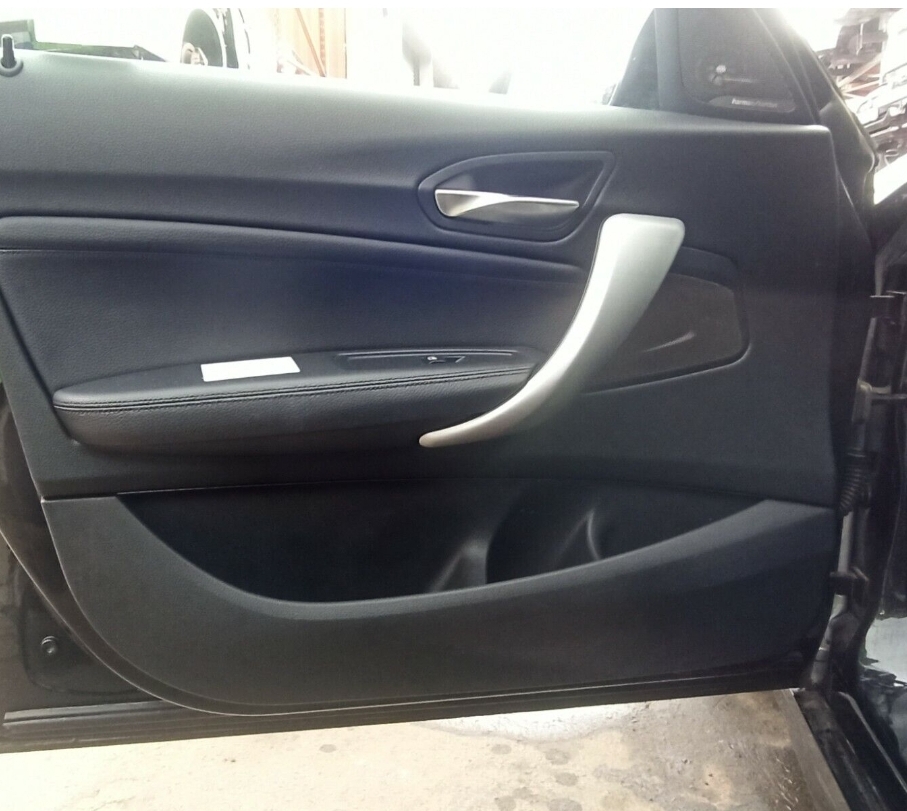

All mounted in the factory location because I like the originale style, see pictures (not my car, just copy frim the the internetto show location).
