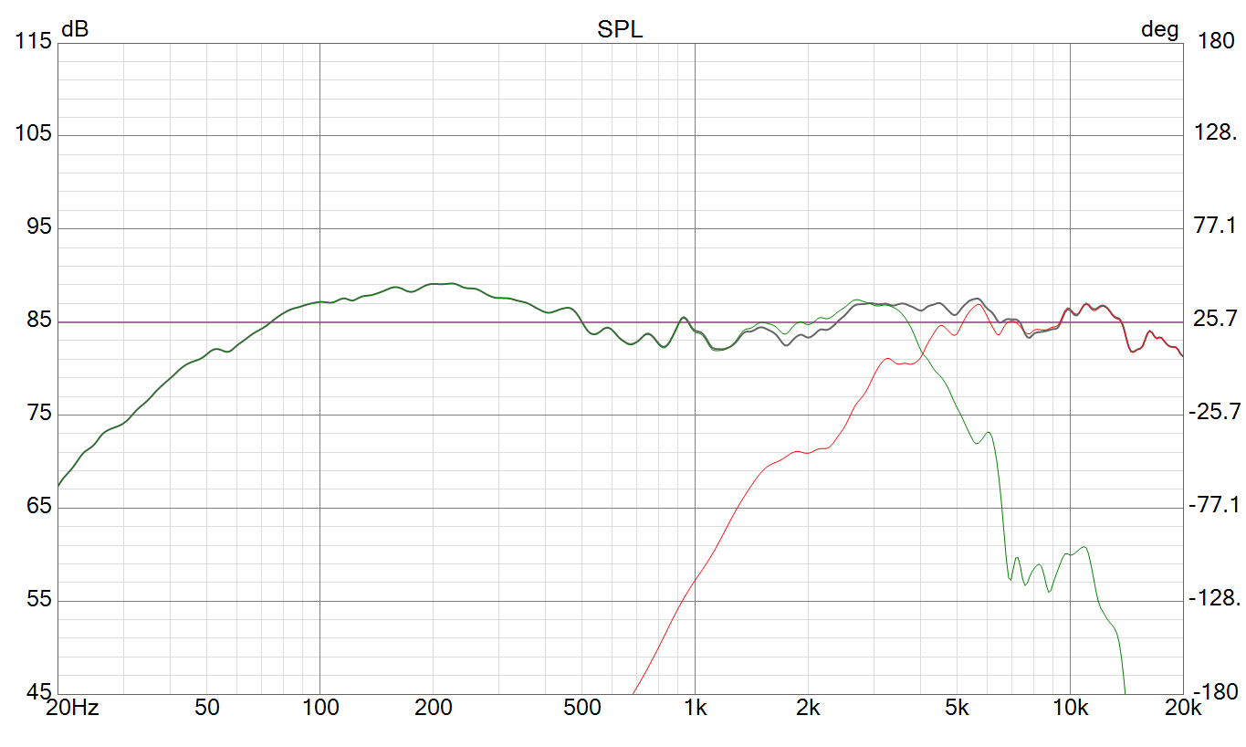

Hello! I want to make a 2 way sealed speaker using these 2 speakers :
Dayton Audio TCP115-8 (woofer)
Dayton Audio DC25T-8 (tweeter)
I made a crossover design in VituixCAD and i wanted to get some eyes on it to see if its a good design and if not what can be improved/changed .Thanks in advance !

If you turn on phase for these I think you'll find they are a little inconsistent.
Are these measured? Timed? If there's no baffle compensation then I'd consider dropping 2kHz and up to closer to 83dB, maybe with a further tilt.

Thanks for the feedback , you are right , I checked the phase graph in vituix and it's not smooth at all .What could i do about the phase issues ? I haven' taken any measurements , I'm just using the manufacturer's data . I also haven't added any baffle compensation , I'll try lowering the high frequencies like you suggested . Appreciate the help !
