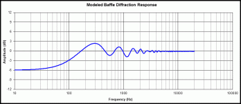

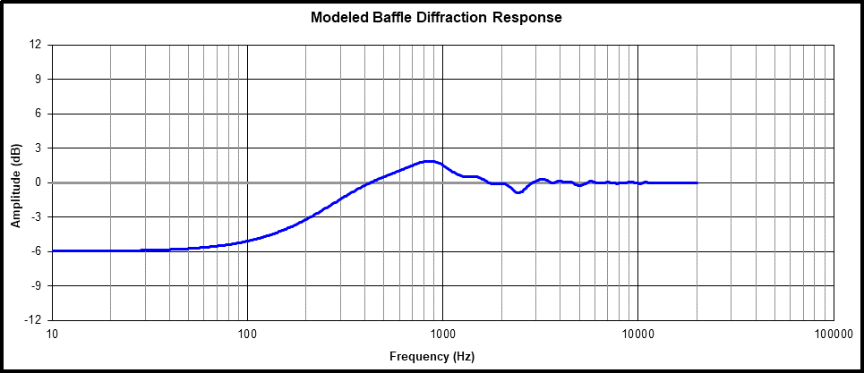

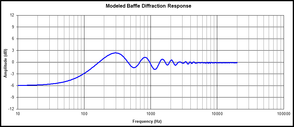

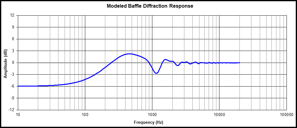

And here it is in visual form. You get about a 6dB loss in the low end and about a 2-3dB peak in the mids. Changing baffle width only changes the frequencies at which these things occur, it doesn't get rid of them. Even when you go as wide as 40".
1 - 8" x 30" baffle and a 5.5" driver at 20"
2 - 10" x 30" baffle and a 5.5" driver at 20"
3 - 20" x 30" baffle and a 5.5" driver at 20"
4 - 40" x 30" baffle and a 5.5" driver at 20"
Best to keep these in the walls or else do a re-design on the xo (with or without re-boxing them and changing the baffle dimensions).
