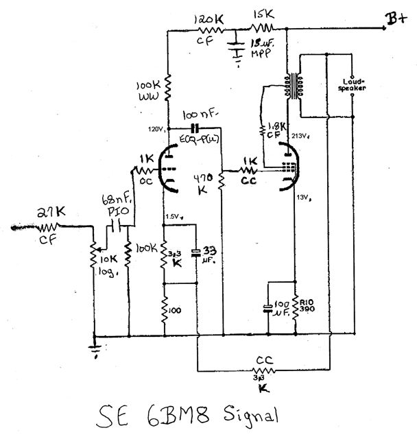

SE - yes, modest cost - yes, triode - no, it's ultra-linear (UL) and based on a Mullard setup for the 6BM8/ECL82.
Let me contact Jeff Yourison, who executed the design successfully, about this thread.

I recommend going for a little more power than the 6BM8, having built it along with others.
6L6 or greater dissipation with UL, or possibly plate to grid feedback would better suited for your listening preference with the Cornwall's. ( I almost bought a set in 1978, but settled for Hersey instead because I couldn't imagine the Cornwall's in a trailer in college.)

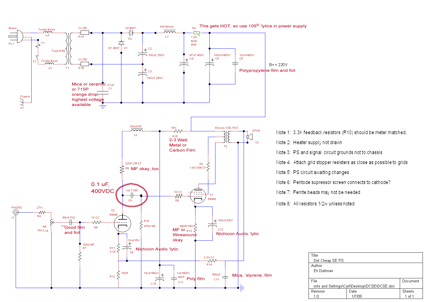

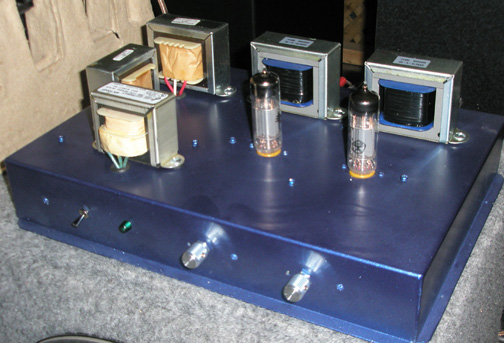

As promised, here is the implementation of a 6BM8 amp that Eli, me and some others worked on. It sounds pretty good, very easy to listen to. Loud enough to fill a room pleasantly (it doesn't crank to party levels).
And inexpensive, to boot.
Jeff

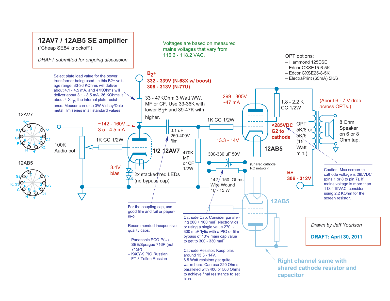

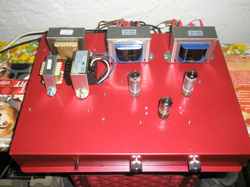

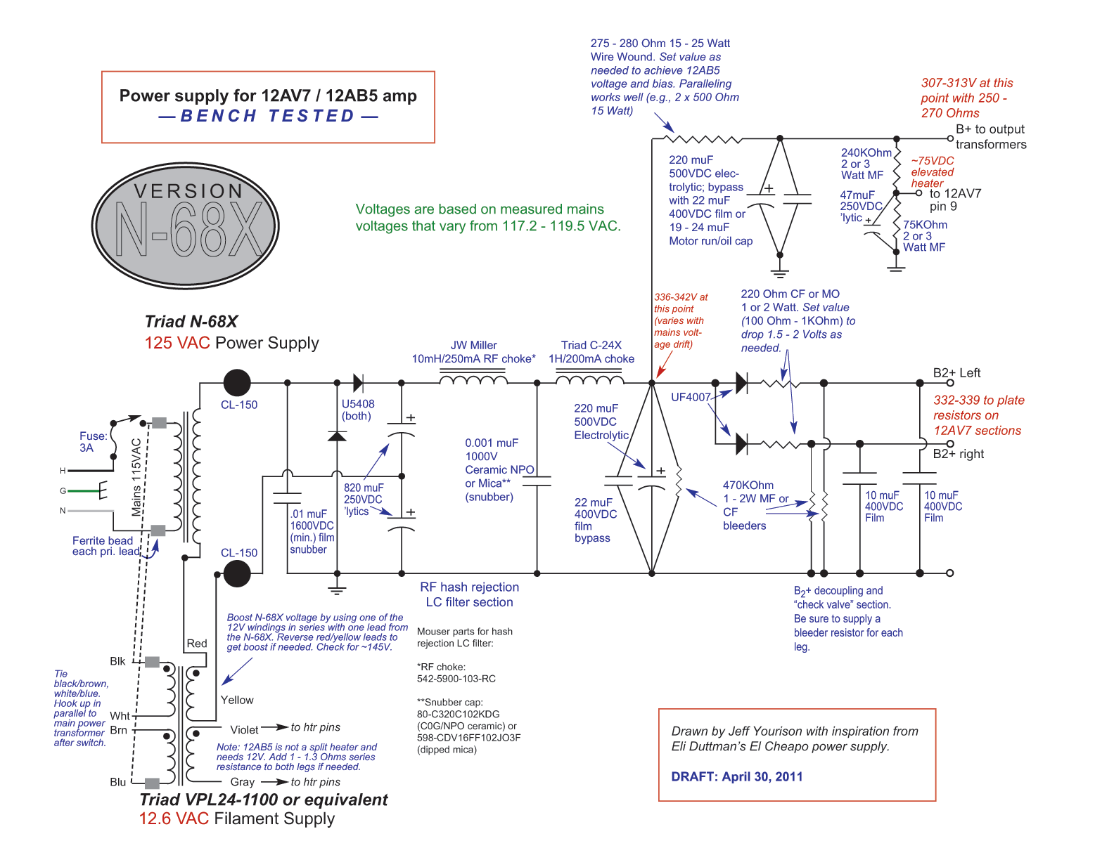

Danconway327,
Here is the 12AB5 amp I mentioned earlier. Eli intended this to be a cheap SE84 knockoff. It sounds very detailed and the trioded 12AB5s produce good bass and treble. This one is capable of higher volumes than the 6BM8.
Note: The amp schematic says "Draft" but it is the final build I implemented.

The remarks about the base cost of magnetics and the cost to ship them are spot on.
The 6BM8 amp takes a pair of $29.84 Edcor GXSE10-5K O/P transformers. The B+ supply uses a $16.37 Triad N-68X isolation transformer energizing a SS diode "full wave" voltage doubler arrangement. Include a filament trafo and (possibly) a B+ filter choke, to round the package out, and magnetics base costs are remarkably low. 😉
A build of the 6BM8 amp will not exceed budget. 😀 Less than $300 is a realistic expectation.
