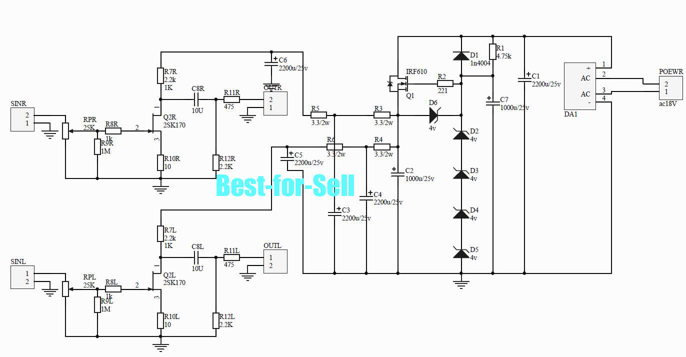

Folks:

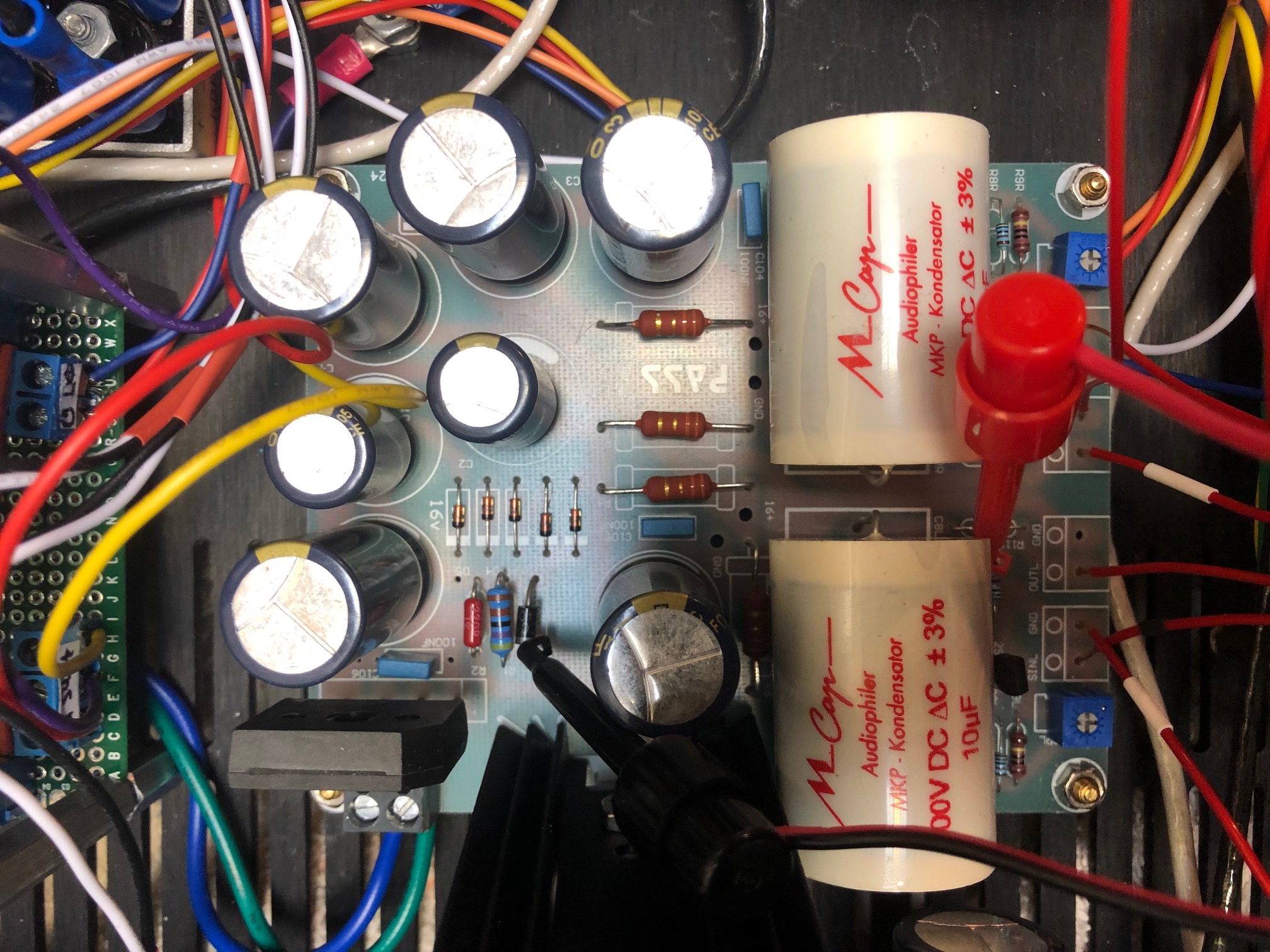

I'm building an integrated amp for my daughter, consisting of a Bride of Zen (jfet version) preamp and a bridged ACA. I am having trouble with the BOZ and would appreciate some guidance.
The BOZ pcb was purchased off of ebay (not something I would ordinarily do, but NP's patent on this circuit has expired); the schematic provided by the vendor along with a couple of photos are attached.
Here are what I believe are the relevant readings:
AC = 19.33V
D1 to Ground = 25.2 VDC
R2 to Ground = 11.65 VDC
D6 (Cathode) to Ground = 11.71 VDC
D6 (Anode) to Ground = 7.84 VDC
R3 to Ground = 7.8 VDC
R4 to Ground = 7.8 VDC
This is a learning opportunity for me: my assumption is that the power MOSFET (IRF610) is not functioning properly, but before I tear it out I thought it better to ask the question. Am I on the right path here?
Thank you for your patience and support.

........the voltage drop between gate and source irf610 should be around 4V........
looks good.
4 zener diodes with 4V sum up to 16V........here not.
a zener diode needs a current of 4mA or so (see datasheet). imho you can lower the 4,7k res to 2,2k.........
your 2200uF elcap at the rectifier can withstand 25V ......you measured 25,2V?
i think it is no good idea to combine nelson`s zen amps to a "new schematic".

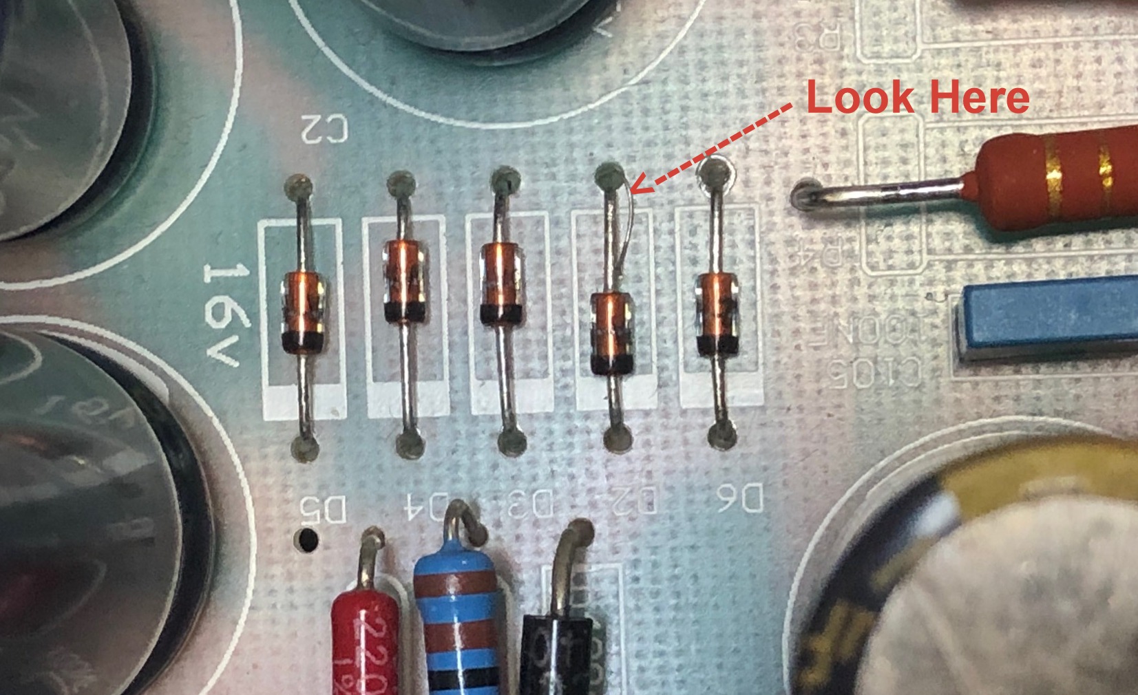

Alan4411:
Hmm, I didn't notice that before and it isn't there now. Must have been a piece of scrap. Is it possible the diode is fried? Having changed R1 and gotten the results indicated above, is it advisable to also replace D2?
Scott
Alan4411:
No reason it will have failed. I just wondered if the 'tail' was shorting the diode so you lost 4 volts from the string. Easy to confirm all are well. From ground measure the Cathode of each and you should see, about 4 volts, 8 volts, 12 volts and 16 volts at the top D2...
measure across each zener and you'll see which one is off value
though , they'll be probably more like 3V9 each or something ..... from top of my head , standard values are 3V9 and 4V1
replace what's suspicious

alter that diode string to have 16V at gate of mosfet , thus 12V for gain stage
insert one green LED in series , to add 1V9 , LED with cathode looking down (to GND)
inform us what's voltage at JFet drains ( reg voltage is what counts for it's operation )

25V input to reg
16.5V at mosfet gate
so 8V5 across R1 , in case of 2K2 , that's 3.8mA , which is enough .... leave it as is and forget
damn 25K pots on left side of schematic are volume pots , no setting with them
if you don't have approx. 6V or so at JFet drains , you got fakes
Hasta la Vista , Babe .......... buy again on fleabay , without checking first 🙂
