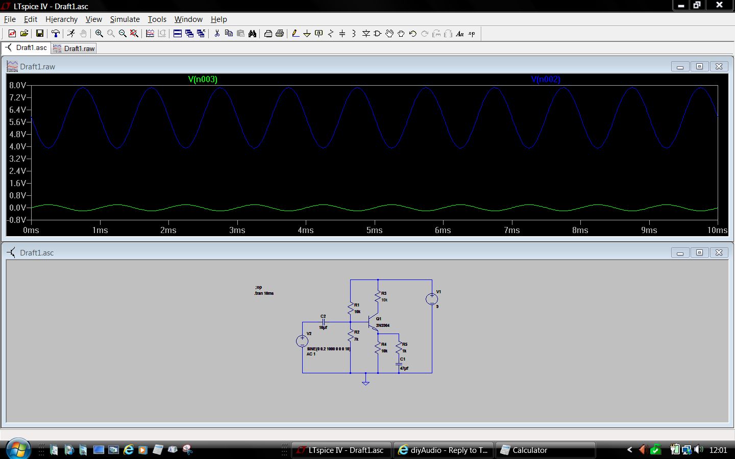

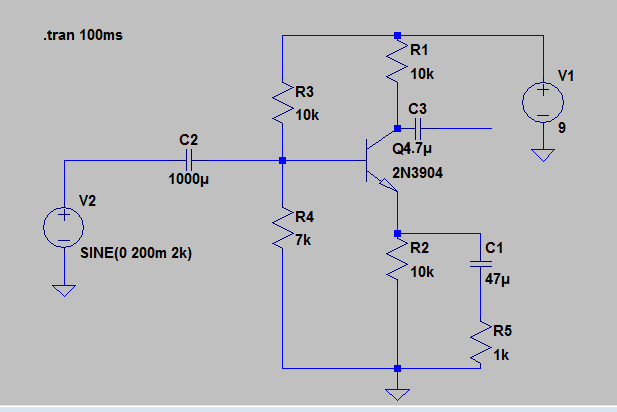

thanks for the suggestions guys, but I'm still having no luck. Attached you'll find a circuit I ran in LTSPICE and it appears to work. However I have this on my bench and I'm getting nada, nothing, zip... hopefully someone will give me a hand.
I have a scope and I see the DC biased signal on the base pin of my NPN. So I know I'm good to that point. But the collector is a flat line...
If you ask why my Caps are so high value... weird thing. If I just connect my music source to a cap then my speaker to the other side of the cap (connecting the grounds together, if I use .1U or .22U or .47U capacitors no sounds come through. If I use these "big" 1000U caps, I hear music. Weird, I'd think the larger the Farad value the more it would distort and "flatten" out the music.... Anyway. That's a secondary question I guess.
thanks for any help. I'm having so much trouble with this simple amp...

I don't know why the simulator shows your circuit to be working.
Let's do it long hand.
The total resistance R1 through to R2 is 20k. Assume Q4 has 1Vce.
Then the collector current is ~ {9-1} / 20k ~ 0.4mA
The emitter of Q4 will be sitting at ~4V
The input base bias sets the bias voltage to ~ 7/{10+7}*9 ~ 3.7V
The be junction of Q4 is reverse biased, i.e. switched OFF.

I didn't see anything wrong with the basic circuit so I'll work it out my way and see if we get the same answers.
Vb is approx 9/(10K+7K)*7K which is 3.7 volts.
Ie is 3.0/10K which is 0.37 ma. (The 3.0 is Vb less 0.7 volts)
Ib is small and hfe dependent and so I'm going to discount it and say Ic = Ie. So that gives 3.0 volts across the collector load resistor.
Does the amp work... yes, but as I mentioned earlier it has no real drive capability.
Next I'll so a Spice simulation and see (lol, can't believe I'm saying that).
And it seems OK
Vc is 5.9
Vb is 3.7
Ve is 3.07
Edit... top blue trace is collector volts, green trace is Vin
I wanted to start from the input bias end, and when I started it predicted such a low emitter current (310uA) that I thought I had better check what the maximum collector current could be (400uA).
That's where this circuit comes unstuck.
It is trying to operate at a tiny emitter current and with an output impedance of ~10k cannot sensibly drive any load.
It desperately needs a buffer stage.

Yes, it can barely manage 3 volts pk to pk into 10K but far worse is that the output voltage is very load dependent.
An output voltage of 2 volts pk/pk into 10K increases to nearly 3.6 volts pk/pk output into 100K.
Yes, the existing output impedance of ~10k virtually demands a load impedance of >=50k with near zero parasitic capacitance.
100k hung directly on the output would be an acceptable loading.

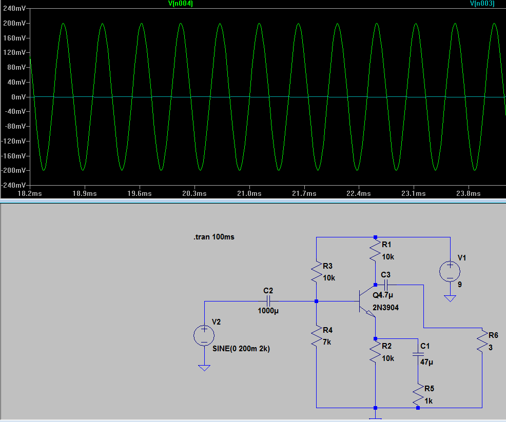

Folks, thanks for the continued support!! I guess I need to give some more detail. What I'm trying to do is learn a bit about amps and build a few small circuits. This is my first attempt. I'm trying to take the signal from an old blackberry and play it through an old speaker I have. NOTE: if I connect the phone *directly* to the speaker, it works fine and sounds fine. Of course, it isn't real loud, but it plays and all is well. So I'm just trying to build a simple amp and witness that the speaker plays a bit louder... Nothing fancy just witness that my amp does actually amplify. The speaker is a 3ohm load, that could be a problem? 🙂
A lot of you put a ton of equations into your response I guess I need a bit of help understanding how to apply that knowledge into my particular issue. Someone mentioned I need a buffer, does anyone have a *very* basic buffer circuit they can link to that I could add to this amp? I guess I could jump right to chip-amp but I'd really like to understand what's happening more. I get the idea from the other posts that I don't have enough current flowing? Should I just lower the value of all my resistors in proportion? Say divide them all by 10; or 100?
Houston we have a problem...
I'm digging around a bit more and on my sim I added a 3 ohm load to act like my speaker. My amplification went to almost a flat line. I'd say that's "bad" 🙂
Why does the phone work directly connected? Can I make some modifications to make this thing drive? Or almost as import can someone explain in terms a dumb guy like me can understand why the voltage drops to almost 0 with the load?

Are you trying to make a poweramp or a preamp ? To me it looks like a poweramp and i have to say your way off. Take a look at the poweramp schematics posted on this forum.
There is no way 10k ohm (10.000 ohms) is gonna push any current through a 3 ohm load, it just aint gonna happen, a 2N3904 is a small signal transistor rated to just 650mW absolute max dissipation and max ~300mA collector current.

You need to start right back at basics. Ohm's law, for example. Learn about power, and Class A amplifiers. Find out what output impedance is.
Alternatively, find an existing circuit and build it. Worry about understanding it later, but you may learn a bit by debugging it.
My advice:
don't try to learn via a simulator.
Do it long hand.
Pencil out a sketch.
Add in the currents you want to flow.
Determine the resistances to allow those currents to flow.
Then see what trimming of resistances are required to get the operating voltages that you need.

Thanks. You bring up a good point. How much current is enough? May seem like a dumb question but how would i go about calculating the required, or desired current? Again, for my first experiment im just trying to make my blackberry "louder".
How "loud" is your Blackberry i.e. what is its output power and into what impedance? You need to know what you are starting from. This sets a lower limit. How much power can your speaker cope with? This sets an upper limit.
Are you trying to run from batteries or a mains PSU? Do you know how to solder, or are you using solderless breadboards? Are you aware of the possible need to provide heatsinking? Are you aware of any safety issues?
