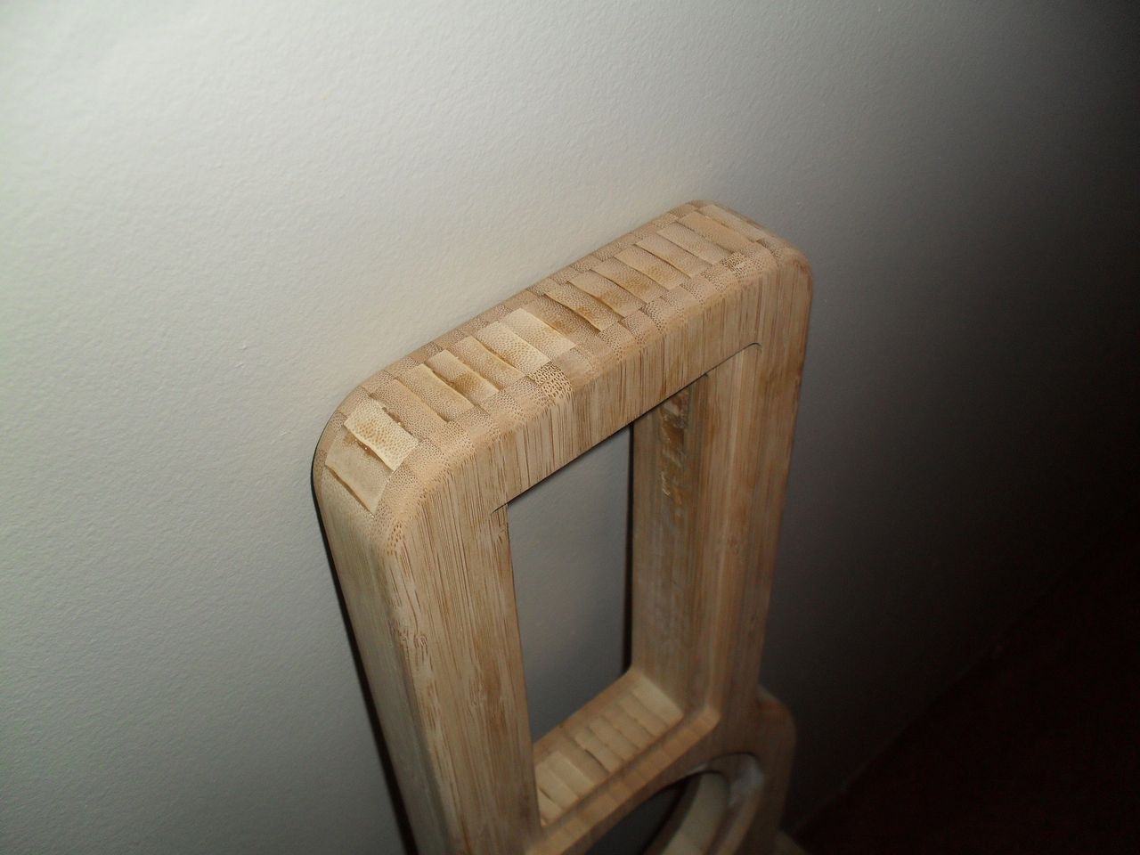

If that photo you posted is the product you found at Lowes, that's definitely not the countertop board I bought. What I have is vertically laid bamboo not horizontal, and construction just like the image in your first post, though the product in your first post is still a horizontal bamboo structure for the top layer. I'm attaching a photo of the product after I filled some gaps.
Just FYI standard baltic birch is 5ft x 5ft sheet, though sometimes you can get 4x8 sheets however I worry because that size would have been made specifically for the American market. If there is Windsor Plywood in Toronto I recommend you check them out.
That picture I posted that is the pair of the cutting board I used it at my bookshelf speakers and cracked after few days.
I never used these at all and even these cracked several places.
The lighter color also bamboo.
The grain of the wood has different direction to hold the hole piece together and even like that is a mess.
When I purchased those they were wrapped into foil just like the counter top at Lowes.
The problem after the unwrap it dry out and do crack. I saw it yesterday, one piece was unwrapped on the top (may be someone returned it) and both side was damaged.
Yes you right your piece is from the counter top. You see the grain of the bamboo goes the same direction and that can crack easily.
The island look more solid, very likely just the side of the panel inside same as yours.
Actually I am surprised yours still is intact.🙂
Sorry but when I invest into something and work on it (invest some time) and out of my fault turns bad after I'm very cautions.
