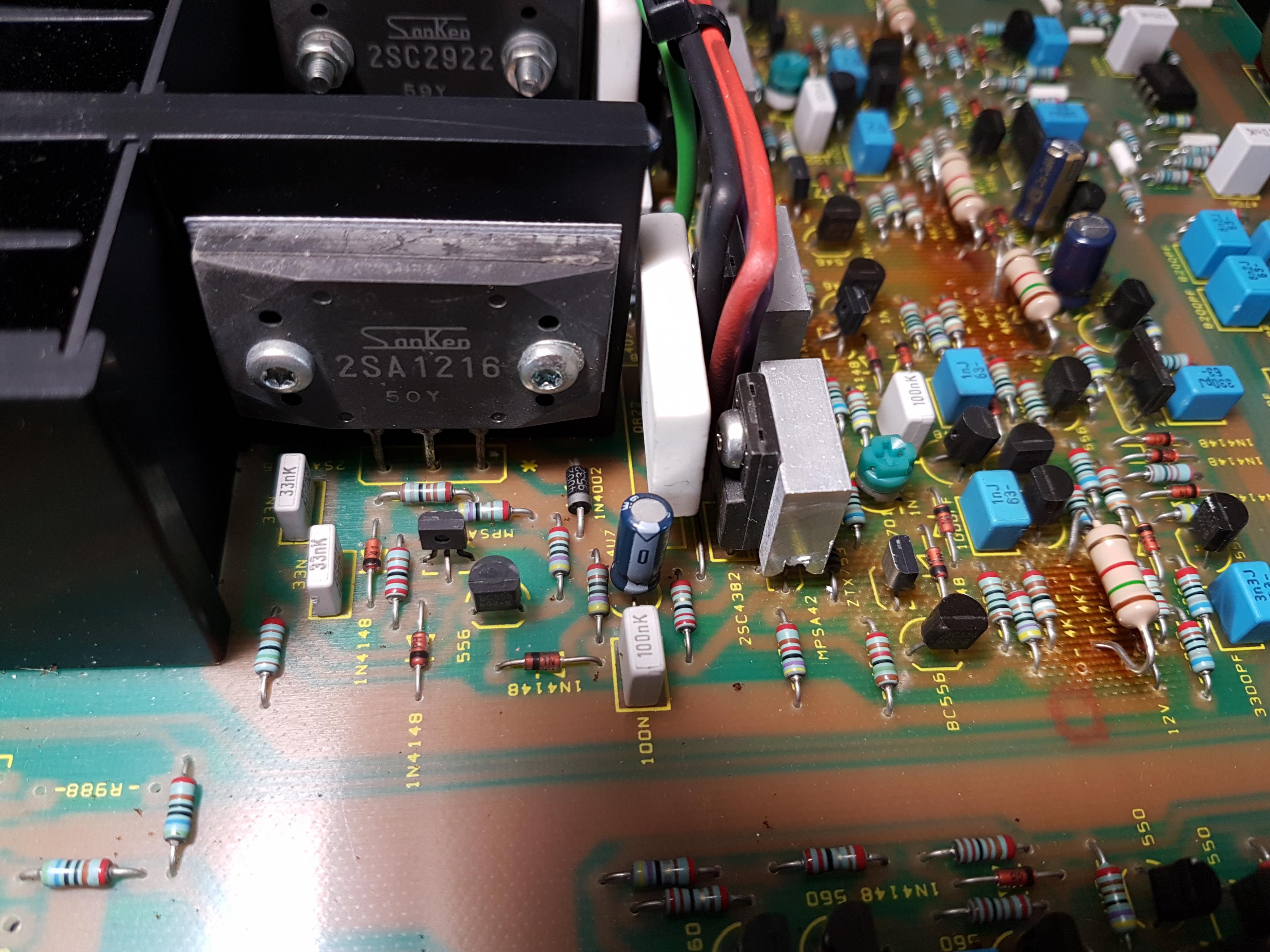

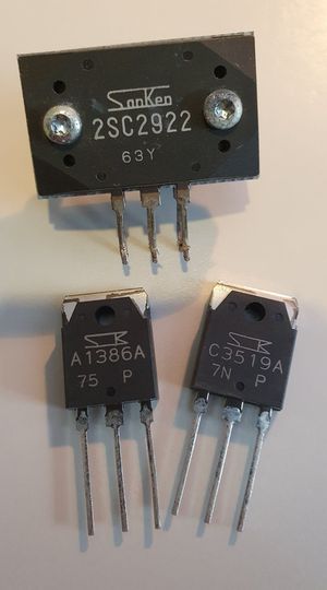

Hi Kaibosher, I have rebuilt a number of Audiolab 8000a and yes there are a number of variants. I have attached the earliest service manual I have been able find.
Output devices were originally Sanken 2SA1216 and 2SC2922, the large double sized package which have been discontinued. I have successfully used Sanken 2SA1386A and 2SC1386A available from Digi-Key.
Worth a rebuild, I run the bias a little higher than suggested but as you mention Audiolab worked on the principal of a closed box to get all components up to temperature and a number of them suffer. Especially the three 4K7 resistors in each driver circuit which burn the circuit board. I replace these with a single 1K5 3W and stand it well off the board.

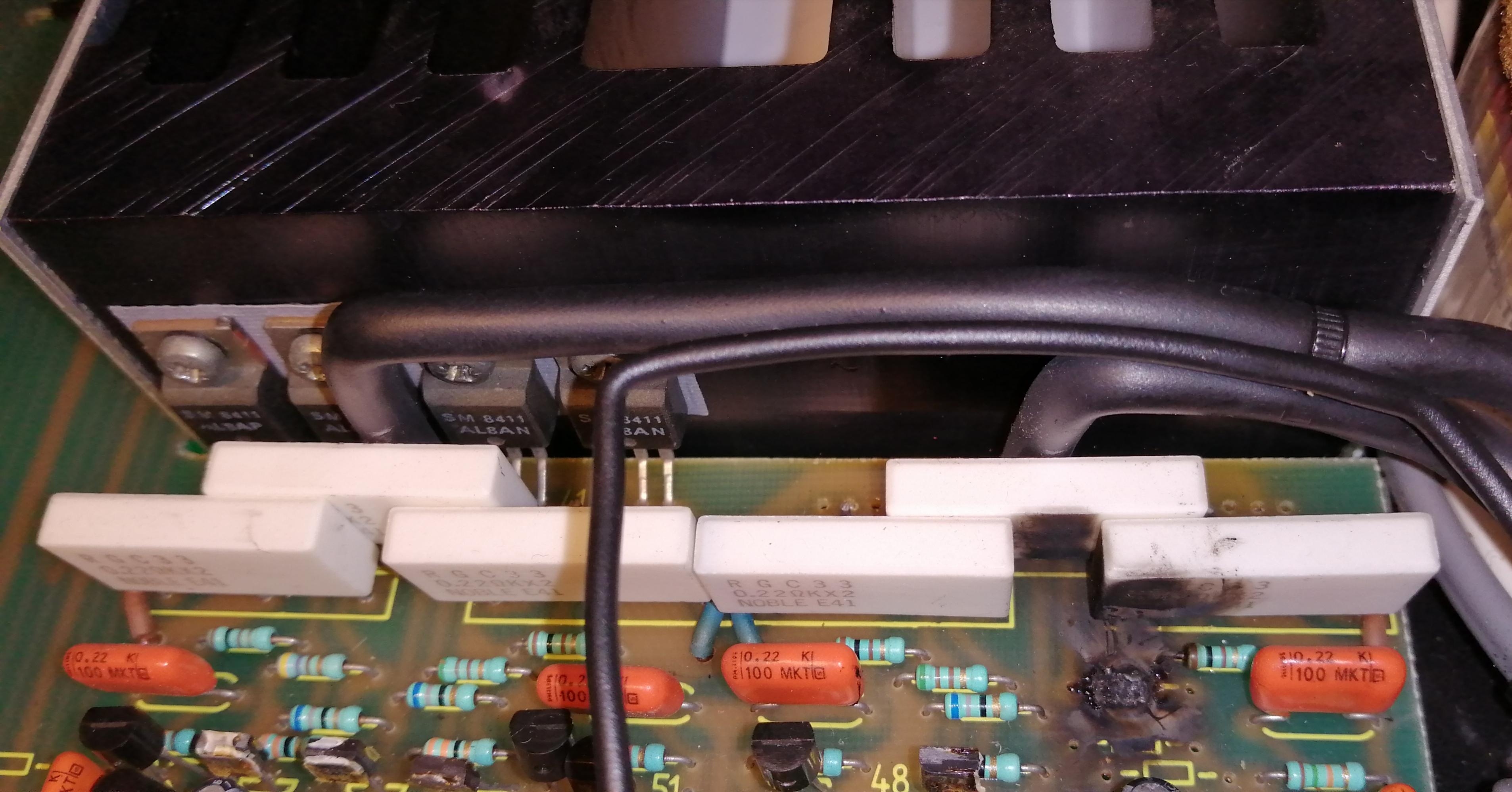

Update:
6 blown pre's, drivers, and outputs - bc546, ztx653, mpsa42, and AL8AN / P.
5 bad resistors too.
Basically, one side of that channel taken out.
Referring back to Repair Briefs 5 ...
These early amps seem prone to oscillation. That link describes adding some decoupling electrolytic's before the predrivers,
(There are no amp decoupling caps in this version - 47uf is added later).
I'll try to repair and see if it makes bad shapes before any modding.

I've never had any oscillation but you're right there is a mod to add decoupling caps across the 12v zenners. Make sure you rate them higher than the main rail voltage. First time I just grabbed what I had, 47uf 16v, well they are only 12v zenners. Two of them went short on me after a week and I thought from the sound I had killed a speaker but it survived. Interesting about the Two x 220s, has someone used two of these in place of the original MT200?
Nah this amp definitely utilized 220 types from factory. I speculate Audiolab used to220 Sankens in very early editions, ran out, then used AL8A for a short while before updating the circuit for larger (and less) devices.
Check out package list on page 6 of 'model 207' manual.
The MT200 type outputs are something like dual transistor sziklai pair packages, and replaced the individual sziklai paired AL8A.
There is no room in there for anything but 220's, look how tight it is in attached photos!
