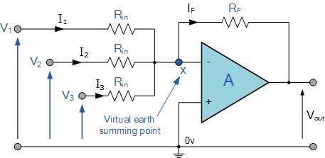

An LM386 is a small audio power amplifier IC rather than an op-amp. How did you get it to work as a summing amplifier and filter?
Yes, Marcel has a point. It may be better to use a summing/mixing stage before the power amp as below. The output voltage is given as:
Vout = -Rf / Rin [V1 + V2 +V3]
