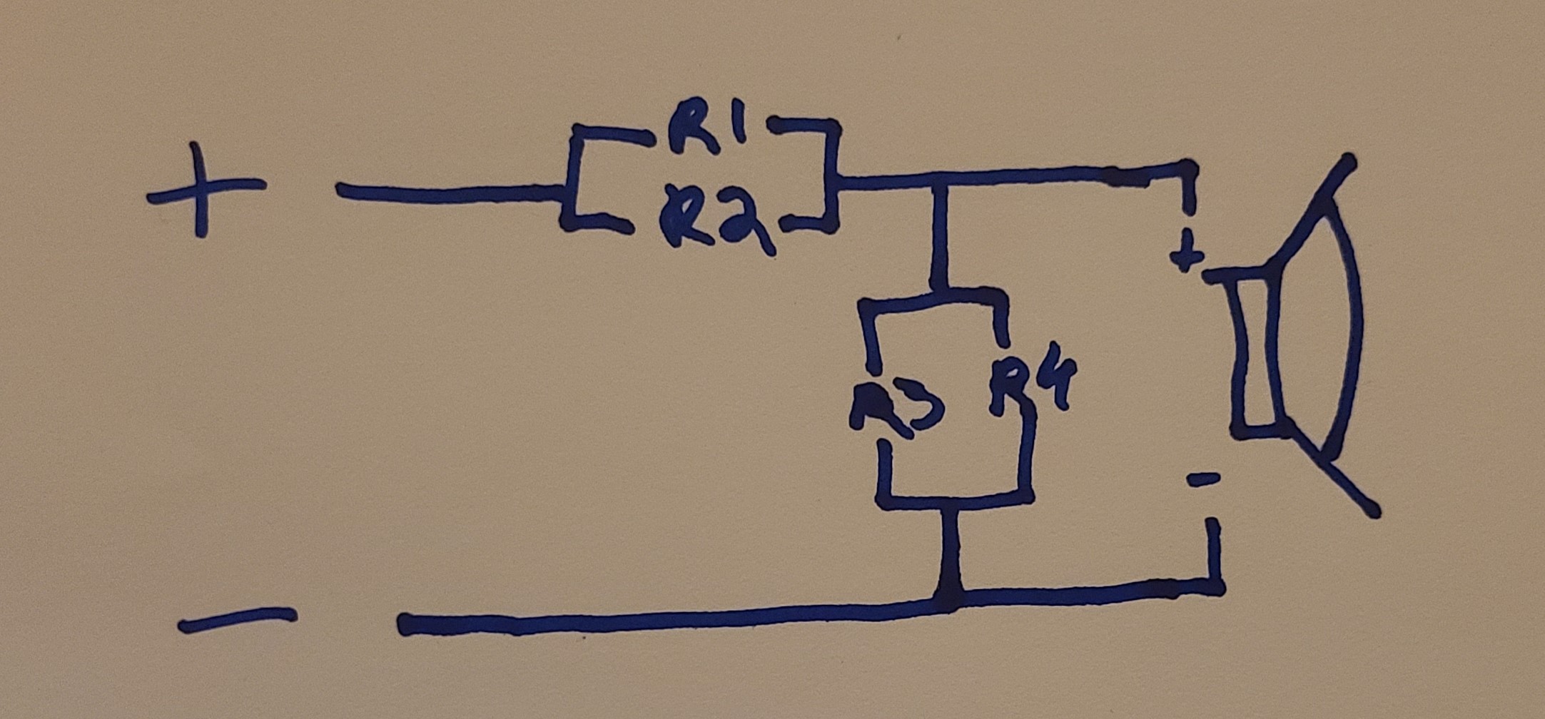

For the parallel resistor can I just run it along the neg and pos binding
posts and then one from the pos inside the speaker?
Using this chart from Solen I've determined the following values: Solen Electronique Inc. | Values for L-Pads
tweeter - 9db attenuation: series resistor 3.9ohm parallel 3.3ohm
mid - 6db attenuation: series resistor 3.0ohm parallel 6.2ohm
woofer - 3db attenuation: series resistor 1.8ohm parallel 15ohm

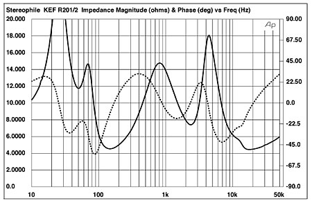

Ive attached a pic of the speaker impedance chart. Should I be ok with this?

You have to reverse the order of the resistors to make an L-pad. Series first, then shunt.
Otherwise, probably this will work ok, if the volume is kept low.
Most would want to use large series capacitors on the mid and tweeter for protection.
You may want to do that at least for the initial testing and setup.
Most would use large series capacitors on the mid and tweeter for protection.

The 16W rating should be fine for the tweeters, but for the mid and woofer it could be marginal
if the volume is turned up very much. I'd consider paralleled pairs (of equal values), for each series
and for each parallel resistor, to be safe.

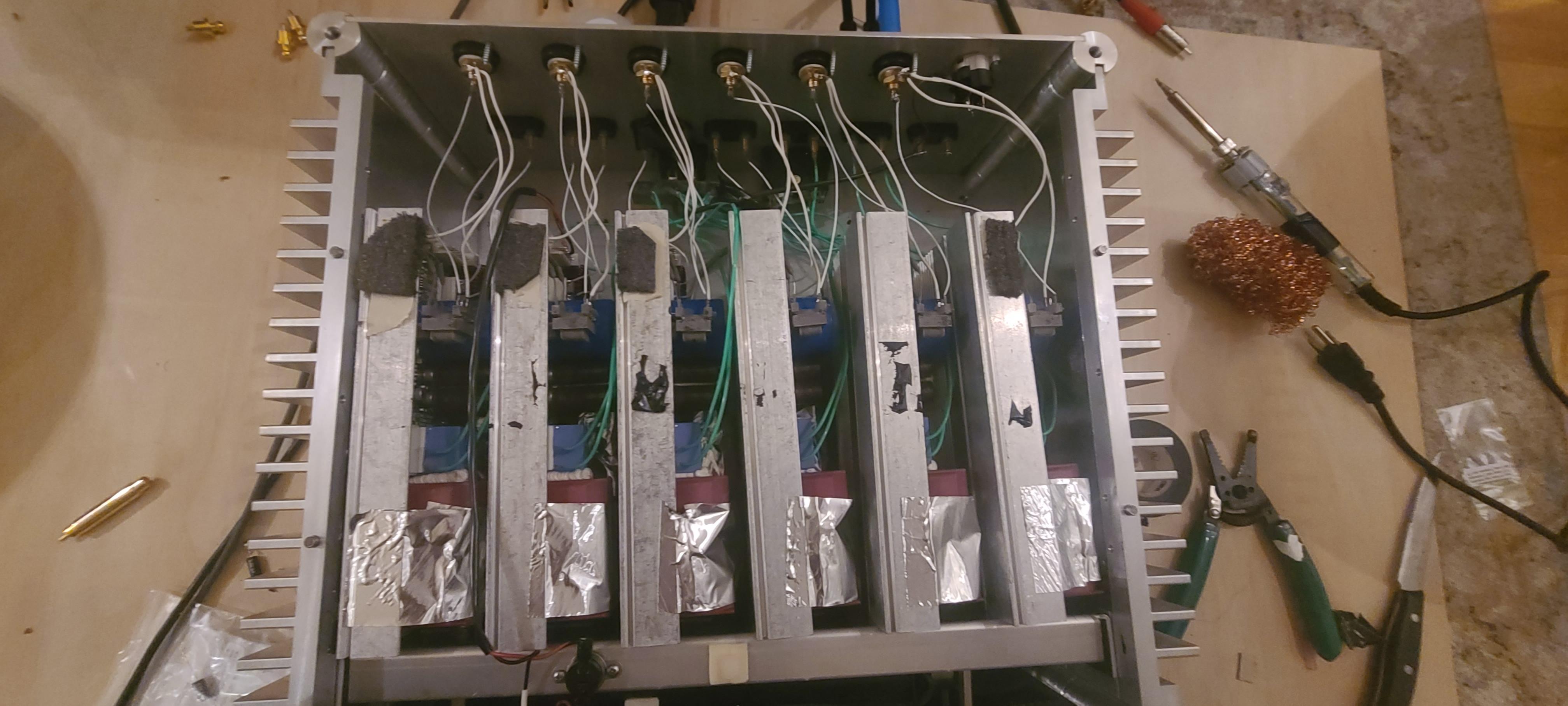

Here's a picture of the inside, I had someone who does mods professionally
help me with upgrading the internal wire and adding some input transformers to raise the input impedance, but the hum did get worse. Could twisting these wire and resoldering them potentially improve the hum? I think its mostly 120hz.
Here's some pics:

Throw your scope around, measure the outputs with the inputs shorted, look at the supply rails.

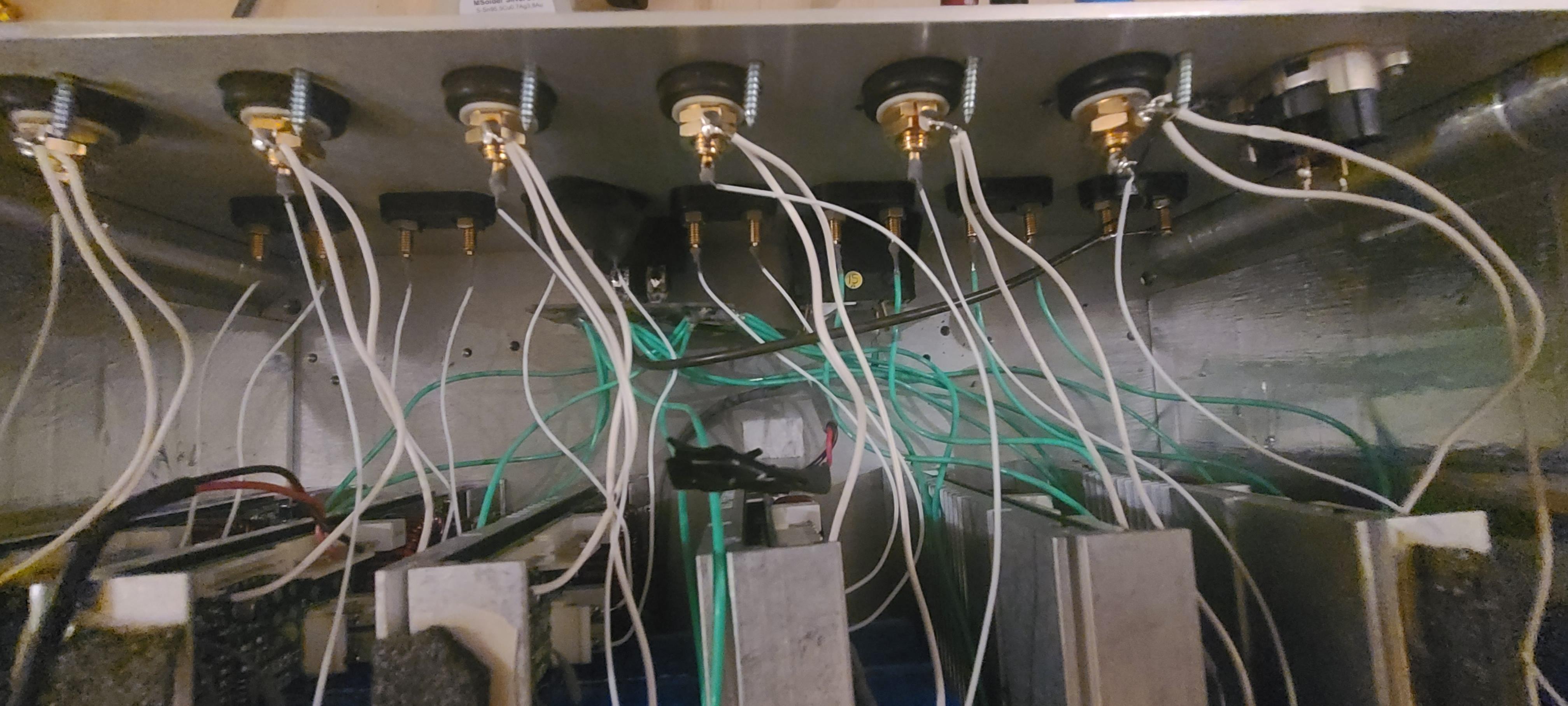

From the looks of that chassis, it's no wonder you have hum problems.
That thing's a slop mess.
First off, those input jacks should have shielded cables running from them to the PC board(s).
As for compatability, using an amp with so much power to speakers is nuts.
If a speaker system is rated for say, 100w, you stick with a similarly powered amp.
If insisting on direct speaker hookup without crossovers, the same applies.
Anything else is asking for trouble.
My opinion, of course. 😉
The audio input transformers could be picking up hum from the AC line wiring.
Of course, the input leads should be twisted or shielded also.
