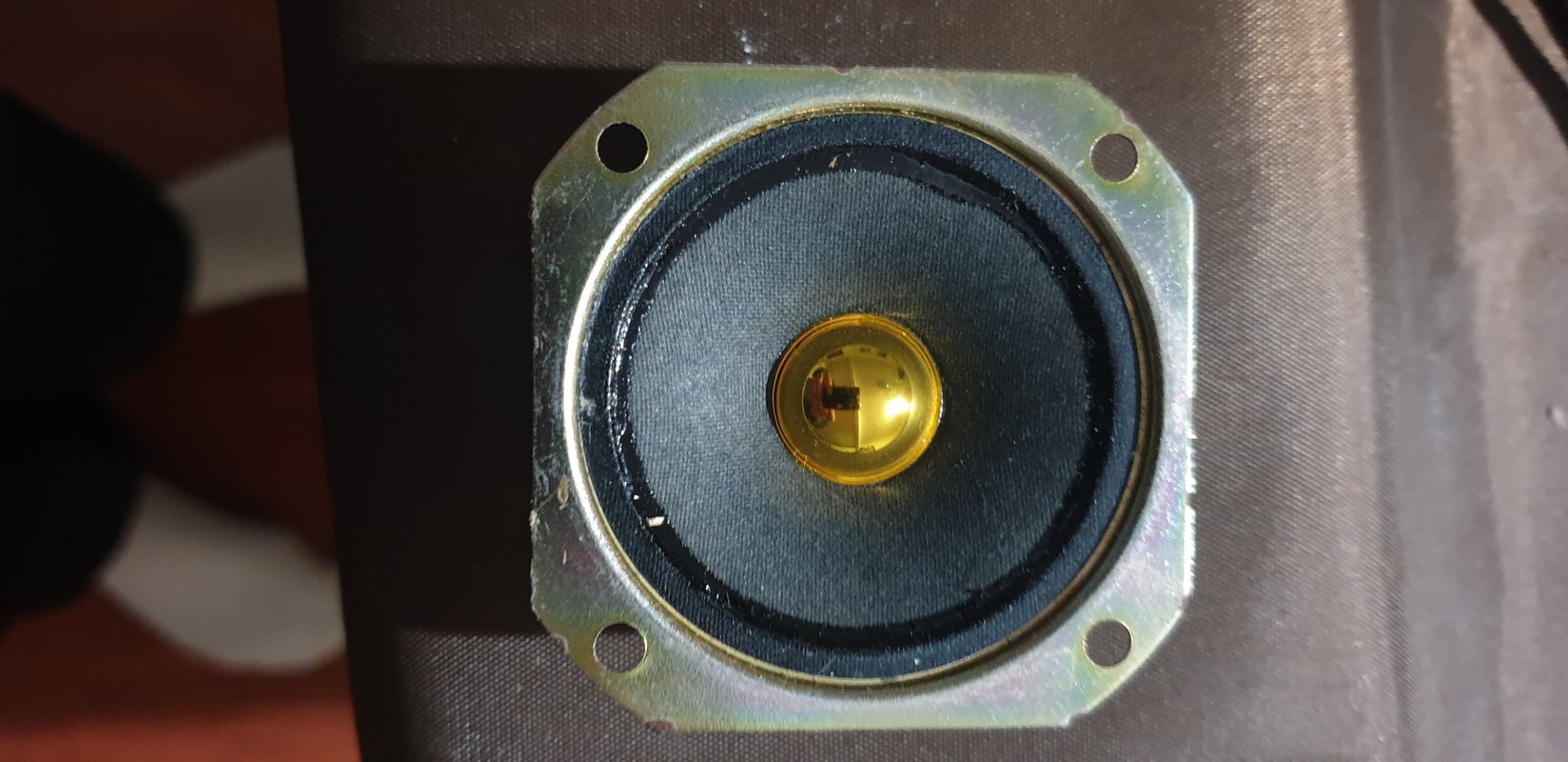

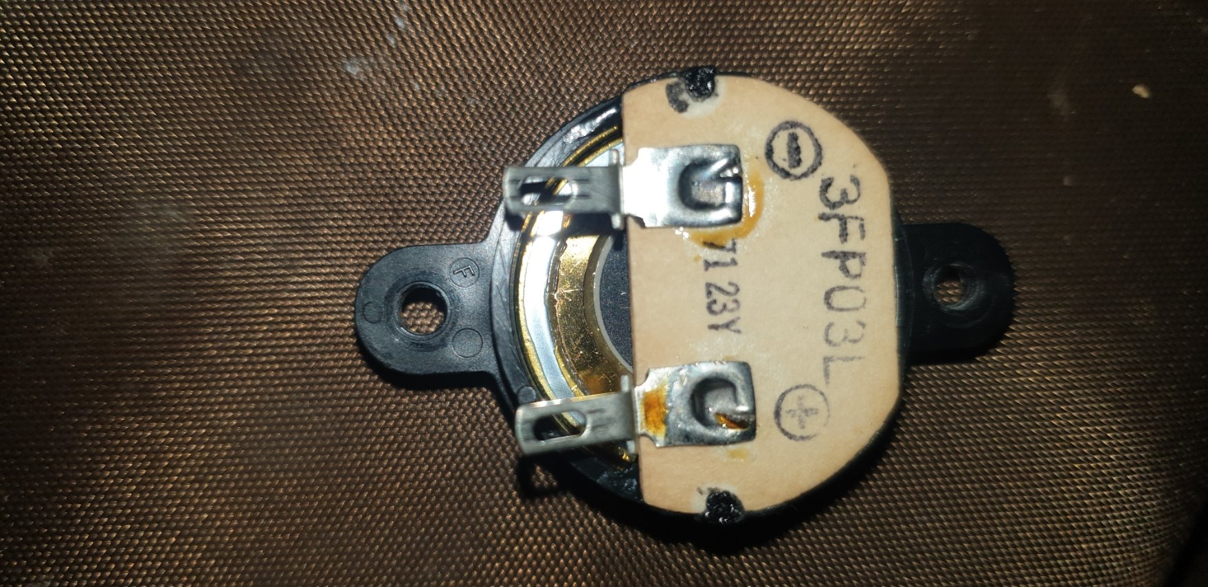

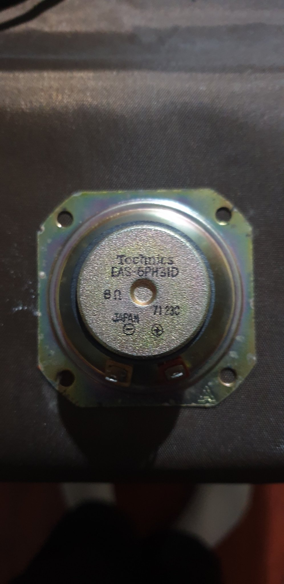

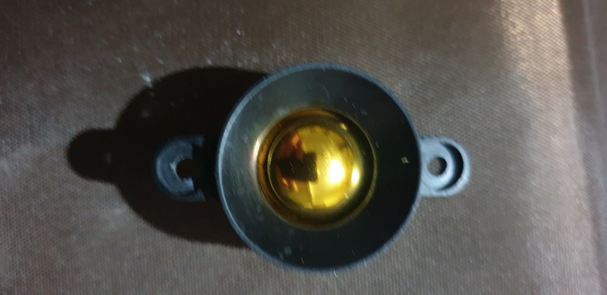

I may have a set of those drivers here, branded Akai but I think they are the same. Could you post pix of the speakers and the drivers you have pulled out?
I'd have to have a look but I think my Akai tweeter has a 1uF cap soldered to the input tab.
Yes, a 1 uF bipolar capacitor wired in series with the tweeter would make sense.
The cap would allow only the highest frequencies through to the tweeter rather than having it reproduce all the frequencies reaching the mid.
@Moondog55 - The tweeters are piezo style and apparently the mid is meant to be a closed cone tweeter, so really, these arent 3 way speakers. There is no 1uf cap in series with the tweeter.
I have replaced the mid in both boxes (as both were dead) with a Visaton TW70 (recommended in these forums but for a different model of Technics Speakers, that used the same Mids as mine). The TW70s do both the Mid Range and Tweeter frequencies, and the speakers sound great. However, the tweeters in both are not producing any sound (maybe I cant hear anything that high but they do when I disconnect the mid - so same situation as mentioned above, but the sound is very low). Anyway, the TW70 covers all the ranges so those tweeters are not needed now. I know these are not anywhere near a good set of speakers, but for my application the are perfect.
Here are photos of the Mid and Tweeters that @Moondog55 requested - Sorry, I dont have any other photos.
Tweeter
Mid
Tweeter
Mid

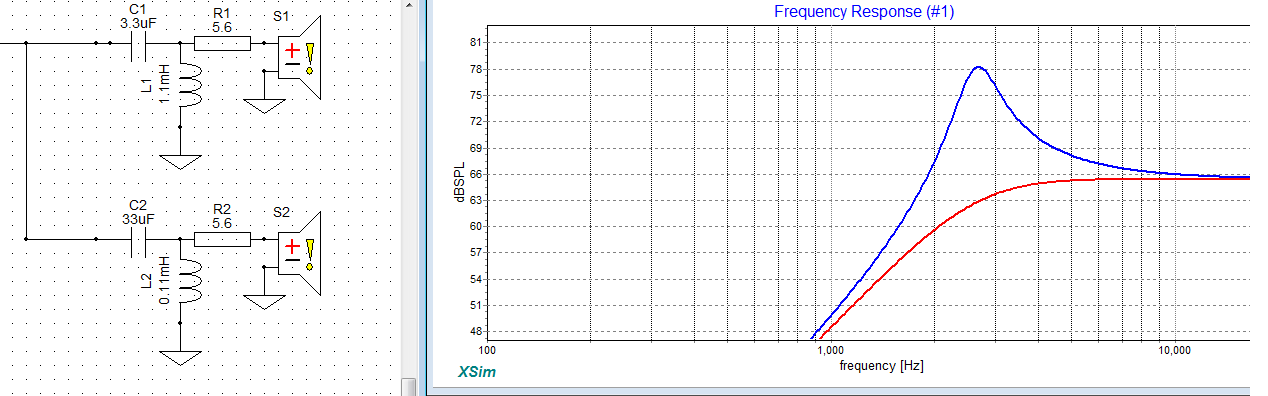

Strange one. My first thoughts after reading the first paragraph were unreliable connectors. Other thoughts include amplifier misbehaviour (DC, instability), or circuit board shorts.
If I could maybe build on Charles' post with a simulation. It is not the direct equivalent here (trying to work within the simulator)... It does suggest a filter becoming unloaded and its damping dropping significantly. In this case increasing the signal by 12dB, with the amplifier seeing a low impedance.
...with the amplifier seeing a low impedance.
I read that if a 2nd order filter is unloaded, it will present a zero ohm load to the amplifier at the crossover frequency (or some multiple of the crossover frequency), leading to the possibility of amplifier damage.
Hi Allen... I have checked/cleaned or contacts and checked connections. They didnt look the best.Strange one. My first thoughts after reading the first paragraph were unreliable connectors. Other thoughts include amplifier misbehaviour (DC, instability), or circuit board shorts.
