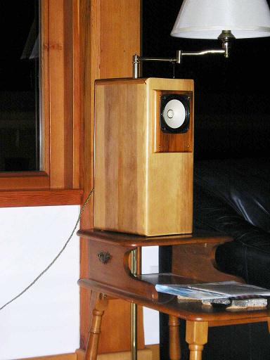

Two comments:
I was working with a young fellow making a set of fe127 MLTL. He marked the location for the driver holes in the wrong place. I did not pick it up until we assembled and were beginning the finish. The wood was grain match so I could not make a new cabinet. So to solve the proble I took a piece of contrasting wood and made a face plate for each cabinet. It worked well and create a nice accent feature.

I've gotten those same speakers built as far as the MDF glued together and speakers put on(though I put NSB's in them). I'm waiting for warmer weather to finish them. If you hadn't said that the face plate was to fix a goof, I'd never had known. I love the look of them the way they are!
