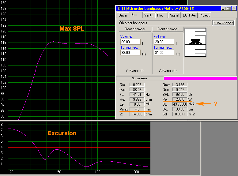

Hi, a few points i noticed.
BL = 43.75 NA Seems very high, but if correct i'm impressed !
No Xmax ? Did you omit it, or can't you get it ?
I inputted 4mm just to see, & i expect it should be at least that !
No Pe ? Did you omit it, or can't you get it ?
I inputted 200W just to see, but i "expect" it may take more ! And it appears to be back vented 🙂
See my screenie for my design with a 6th. Not massively different, but maybe more what you're looking for ?

yeah that looks good. I have added some more parametres to the WPR and uploaded a updated version:
http://pix.minirig.org.au/main.php?...2_GALLERYSID=a27649786e430f46cb14dc9af4bfaf87
The new version has pe and all the basket dimensions. I couldn't get xmax but by pushing on the basket I would say atleast 5mm. When I measured the driver using WT3 I wired the 2 voice coils together (series) and then in WinISD treated it as if it only had one voice coil. I'm assuming that is correct.
Thanks 🙂
It seems to be identical to me ?
They would be in the WinISD .WDR file which you didn't upload.
I couldn't get xmax but by pushing on the basket I would say at least 5mm.
Not far off my estimate of 4mm.
You can wire them in Series, or Parallel.
Compared to a single VC driver SPL @ 1W, Parallel = + 3dB, Series = - 3dB
Series Voice Coils
Revc, BL and Levc = Double of one voice coil.
That's why we see BL = 43.75

Got it 🙂 I notice that you havn't updated the .WDR Driver file to include Xmax & Pe ? Anyway i inputted the same data as previously, & also estimated 2mH for Le.
+-1 1/2dB 41Hz - 102Hz looks fine on screen 🙂 Please be aware though that BP6 are very intolerant of TSP/Box/Port errors. If you are able to test the driver & get accurate TSP's, so much the better. If they differ by more than a few % then a redesign would be wise.
If you are unable to do that, but already have the wood, or can get it cheaply, then building it anyway would be an interesting exercise i think.
I recommend that you use an Active Xover @ around 80Hz.
