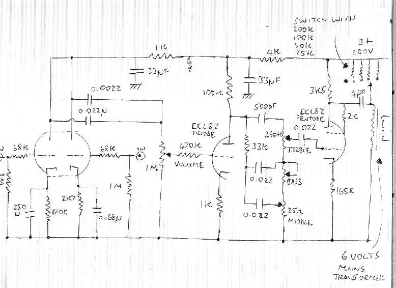

There was a discussion on this idea some time ago. I came up with an idea which I think is superior to the use of a voltage divider for the tube stage and is still cheap.
Firstly - make absolutely certain that the gainclone never clips. This will sound horrible.
Second - use solid state rectifiers and place resistance in series with them, they will behave in prity much the same way as tube rectifiers as the main difference between tube and solid state is their impedence. You will get the rail sag you are looking for.
Thirdly - use a parafeed interstage transformer to drive your gainclone. This will take care of the step down. This has a number of advantages. Namely it will introduce transformer distortion which is the main characturistic which makes a quitar amp sound as it does( along with speaker distortion). A small amount of DC can be introduced into the primary to encourage transformer satuation. This can be controlled by a wire wound pot from the HV rail. The transformer will perform better the cheaper and smaller it is, this is because it will have more High frequency and low frequency roll off. It can be a mains power transformer.
Fourthly - take the trouble to introduce a Marshell style tone stack.
Use back to back transformers for a cheap power supply.
The bottom line is that a simple tube preamp will never distort in the way that you want it to, and quite frankly you are waisting your time. People have done it and have never reported great results.

Because your not asking the transformer to deliver any significant power, you can choose your output tube such that you can resistively load it. I did this with a headphone amp (using an ECL82) and used a 3K5 resistor as the plate load. Works well and is simpler than a choke or constant current source load.
Shoog

So, how do I apply this to a (simple) guitar amp design like the Skylark, and how do I build a Marshall tone stack (whatever the heck it is?)
The schematic, untried.
Shoog
