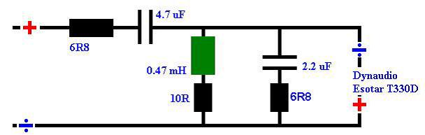

I'm going to build a Totem Model 1 clone and I wonder if anyone has a diagram of the crossover.
I got the drivers pretty cheaply. Dynaudio 15W75-4 and Seas 25 TA/WGB-TO. Does anyone have the T/S for these drivers? I haven't had any luck searching online.
I'm new to crossover design so I'm going to design my own then compare to the original design. Any help appreciated.

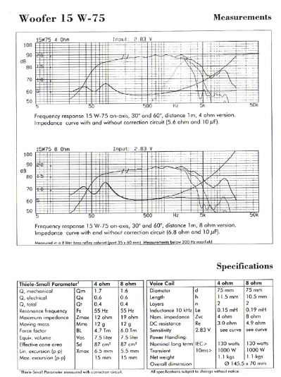

I haven't got a lot of stuff on that woofer:
705063d1537644466-built-totem-model-1-clone-dynaudio-15-75-jpg

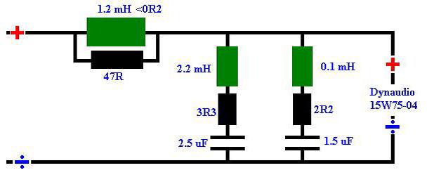

The bass filter is usually about 1mH coil and 4.7R plus 10-15uF impedance correction, relying mostly on natural rolloff. About 7-10L reflex you'd think. Dynaudio used to do quite complicated tweeter filters, but not set in stone IMO. Probably a third order would work well enough.

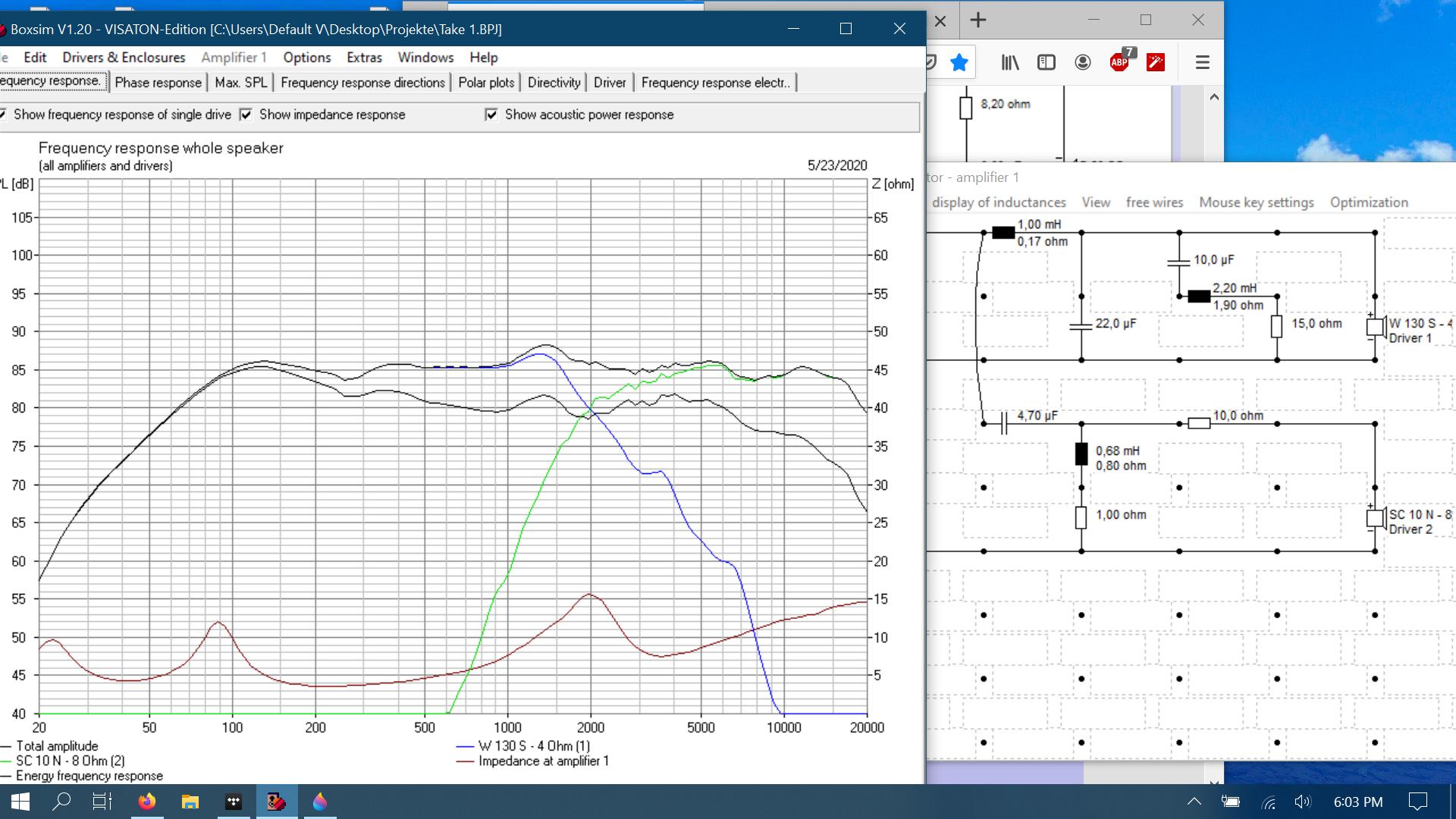

The tweeter is standardish 1" SEAS metal stuff. Shouldn't be too hard to knock up a 3kHz crossover. I'd set up a sim to see how it looks:
Software | Visaton
The Visaton SC10N is not hugely different from SEAS 1" tweeters. The W130S-4 might give you an idea too. After that you just wing it a bit.

Your crossover will look a bit like this:
694035d1532786073-sb26adc-compared-sb29rdc-3rd-kef-style-png
But different bass filter, drivers and positive polarity on tweeter. Shouldn't be hard to modify the default project in boxsim to see how it works.
Crossovers aren't hard. You just get the two drivers playing nicely together!

That's a reasonable 3.5kHz SEAS tweeter slope. It's going to sound good. Now you've just got to get the midbass to do the right things to join up.
The W130S-4 is a bit different from the 15W75-4, so stick to 1mH series followed by our guess of 4.7R and 15uF shunt for the bass. Dynaudio have done the work there already! No need to reinvent the bass filter.
The 1.4kHz lump in the W130S-4 is just what it does. We are only guessing here. Getting a feel for it all, you see. What I am hoping is if you get the tweeter to cross at about 3kHz for 6dB down, it should join up with the Dynaudio midbass.

You just fiddle with the details for particular drivers. Possibly R1011 and C1031 are the only two tweeter components that then need a little tweak.

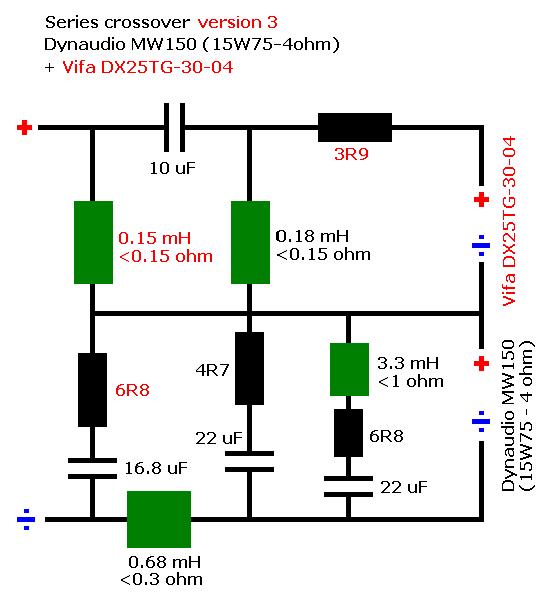

And just as a marker, before I forget. Some other tweaks to series filters I uncovered from reading the late, great Jeff Bagby, impedance comes out nicely with a sort of 3:2:1 ratio on component values for series filters:
591258d1484013729-flat-impedance-flat-power-response-design-flat-impedance-series-filter-circuit-png
591257d1484013729-flat-impedance-flat-power-response-design-flat-impedance-series-filter-fr-png
Might help later.

So we have something like this:
610158d1491571296-crossover-help-dynaudio-17w75xl-ohm-d260-dynaudio-sirius-17w75-jpg
The two impedance corrections to the right will be optional. I expect a 0.3mH coil added would work for a second order tweeter. But that's a guess.
I have the 15W75 datasheet in front of me, and Dynaudio recommend 5.6uF and 10uF as the 4 ohm woofer impedance correction, 6.8 hm and 10uF as the 8 ohm impedance correction. Vas is 7.5L, Fs is 55Hz. Qts is 0.4.

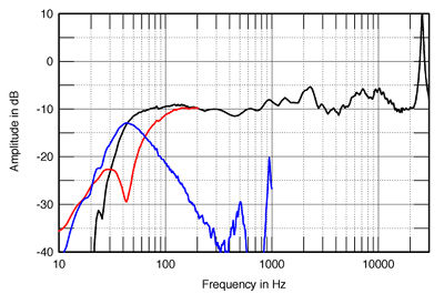

Dyanaudio did better with the Focus 110:
SoundStage! Measurements - Dynaudio Focus 110 Loudspeakers (12/2006)
After some digging around, I found out enough about the Totem crossover to have a stab at this. It's second order around 2.9kHz.
The Totem bass filter looks resistance underdamped, hence peaky around 2kHz. Dyanaudio's impedance correction looks better. The woofer rolloff is quite steep. The hole at 4kHz comes from the shallow slope of the tweeter filter. Really third order would work best, IMO, but there it is.
So I reckon Ryan200 wants 1mH bass coil, and 4.7R or 5.6R plus 10-15uF shunt here. Tweeter filter might be about 5.6R plus 4.7uF, and 0.2mH shunt. Simple as that. Fiddle with the 5.6R for tweeter level. Always a matter of taste. I'd use a NP electrolytic in the bass filter.
