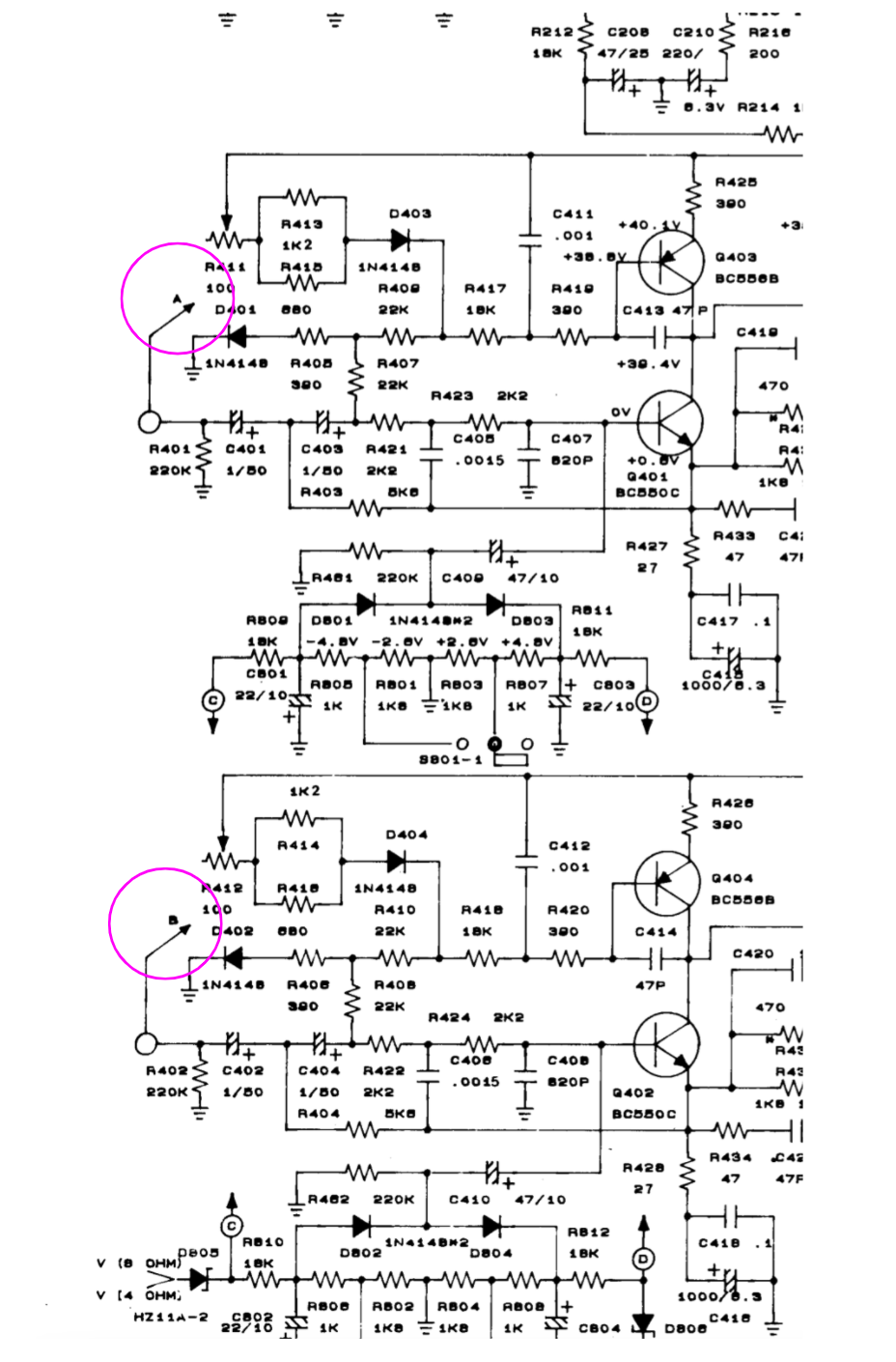

Hi there, do you mean these 'A' and 'B' points on the circuit diagram on the attached screenshot?
If so, I'll need to open up the hood next and try and identify where these are.

Points marked A&B are the inputs to the power amplifiers and these also connect to points X&Y at the outputs of the preamps. Those points are perhaps easiest to identify and access at the left and right side pins of the balance control.
Essentially, if you want to use the NAD as a control preamp, the output must be taken from those points located just before their power amps but after all the preamp controls, including the volume, tone, muting and balance controls. The input sockets may also have tape-out connectors grouped with them but these are at fixed line level, so they're unsuitable for a direct connection to an amplifier.

Following the preamp schematic it is not advisable to separate the preamp and the power section of the NAD. A balance pot is right at the output of the preamp, which means relatively high output impedance. And the tone control network sits right at the output of the preamp stages and is not buffered.
All in all: No to separation. Not a good idea, sorry. Leave the amp as it is and probably upgrade the aging capacitors, etc.

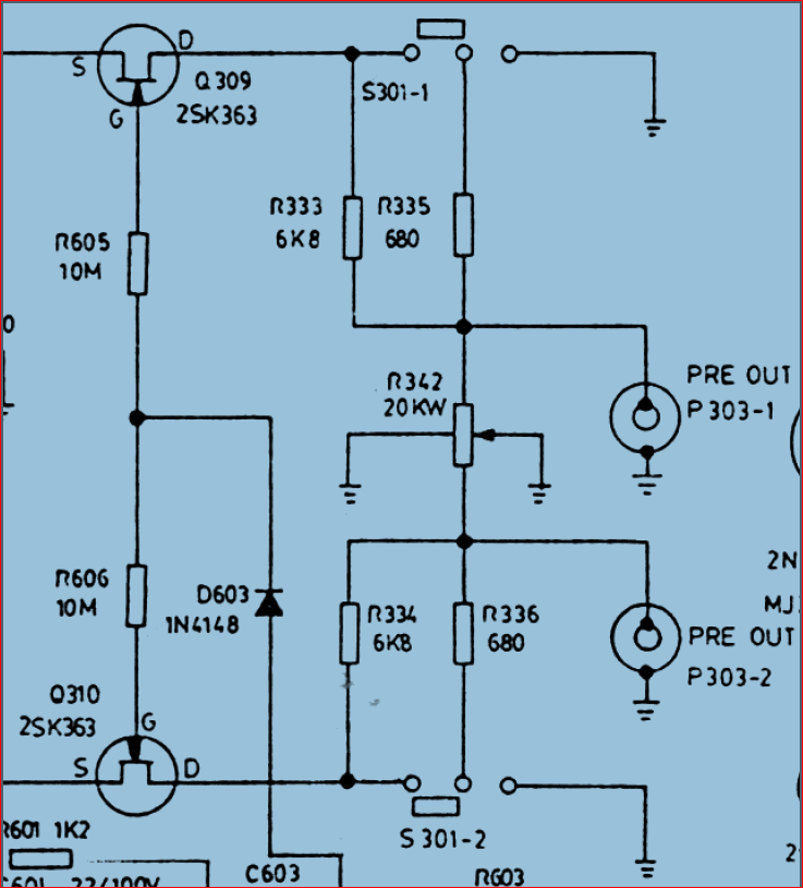

The NAD 3020B, for example, has much the same schematic and connections as the 3020A,i,E etc. but already incorporates "pre out" sockets with heavy wire bridges to the internal amplifiers as often described. Presumably, you just switch the speakers off or remove the connections to use the external power amplifier(s) alone. It's all a bit basic but that's the NAD way of doing things and it assumes a moderately high impedance input to the amplifier(s).
I should also have mentioned that the "pre out" and "main in" sockets are located adjacent to each other at a standard centre spacing of (I think) 3/4" or 19mm so that a "U" bent heavy gauge wire bridge could be inserted to each pair of out-in sockets on the rear connector panel. By heavy gauge, I mean the size of an RCA plug pin. Unless you have some workshop skills and a clean, short length of 3.2 mm galvanised wire, I think very short RCA leads may be the easier way to go.
