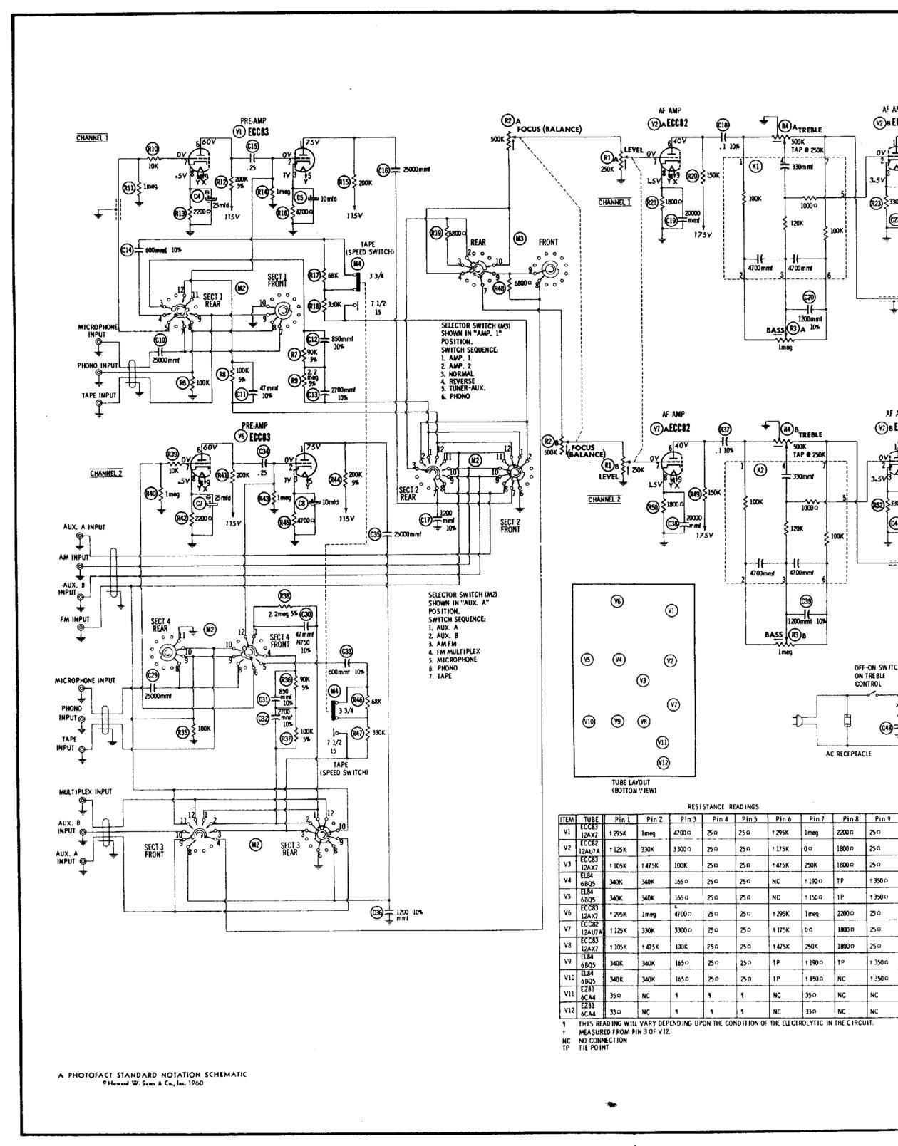

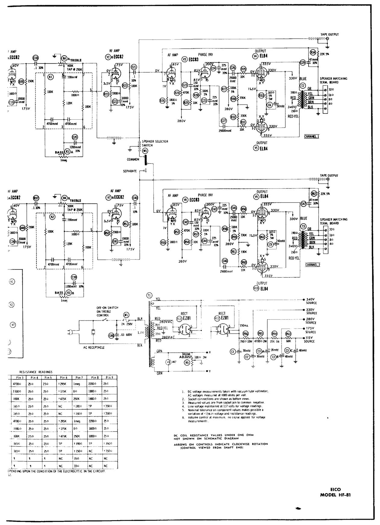

Got a hold of the eico manual - excellent - and measured resistances and voltages..
Power supply is at 116 V AC - I would think this good, not too high.
Filament voltage is right at 6.3 V.
Per the manual, measured all resistances from the pins, and they all check out ok, more or less within 5-10%.
Voltages check out pretty much too.
The only outliers are:
- V1/V2 grids low. V1(1) at 9 V but should be 80 V. V1 (6) at 40 V, but should be 60 V. V2(1) at 17 V but should be 80 V, and V2(6) 43 V but should be 60 V. (I believe V1/V2 are for phono only..)
- power tubes V7/V8/V9/V10 a little high. On average they measured ~370 where Eico states ~330 V. (Based on my limited Fender guitar amp experience, that should be ok.)
Pre-amp tubes V3/V4/V5/V6 measured reasonably close to Eico's spec. Also rectifiers (V11/V12) are at 300 VAC, eico wants 290 V, and 380 VDC, eico 340 VDC.
Note that these measurements were done with V9/V10 power tubes out of the amp.
Since they flash and I believe the amp goes into oscillation with them in, I left them out for these measurements.
I did try switching around tubes, to no affect..
The bad channel output transform stays completely cold.
When I hook up a (cheap) speaker to the bad channel, a high pitch sound comes on. Equals oscillation? This happens about 15 - 30 seconds after turning on the amp. Thereafter the power tubes start flashing. I always turn the amp off quickly.
Could it be I have a bad output transformer? How can I test for that?
If I get (oscillation) noise out to the speaker, doesn't that mean the transformer is ok?..
The bad channel power tubes don't seem to light up correctly when the amp is turned on. They flash white briefly, then there's no light at all. They seem almost not to be on, but then when the oscillation occurs strange flashing occurs inside them.
I double-checked the filament voltage to them but it's ok.
Thanks for any advice for next steps,
Paul
