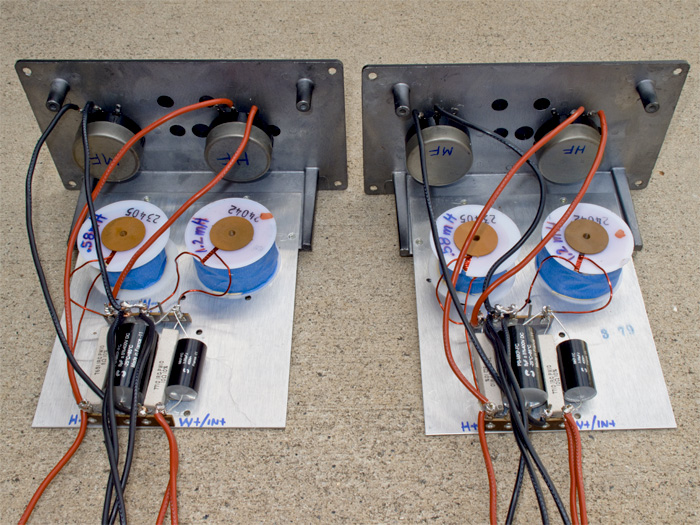

I replaced the caps w/ Solen and rewired it. Upon reassembling the speakers the sound is now very quiet.

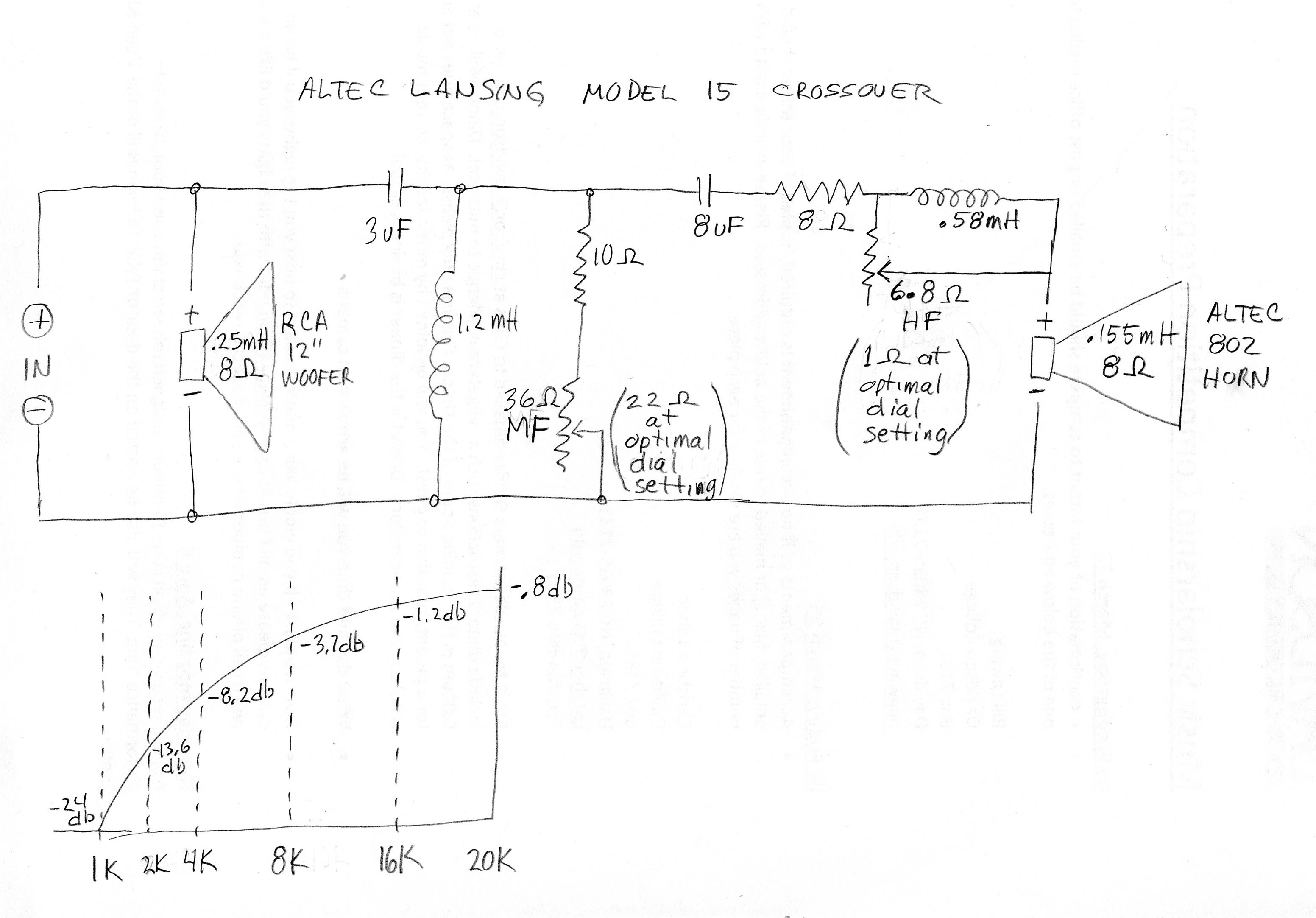

I rechecked my assembly hookup to my hand drawing of the factory x-over schematic. (The schematic and crossover photo posted below) Note that the woofer runs full range and the crossover only affects the horn.
When I hook the speaker wire direct to the binding posts it produces an almost un-hearable volume. When I touch the speaker leads direct to the woofer I hear the same until I remove one of the x-over leads, then the woofer sounds normal, of course I can test the horn. So the problem is with the x-over. 🙁

x-over drawing
x-over rebuild photo (I since redid it in its entirety from scratch but using thinner Kimber Kable instead of the 14 ga. Audioquest as in the photo.

I don't see any problems in the schematic, hard to tell in the photo.

I doubt you hurt the inductors or the pots, maybe the caps. But even if the caps were shorted, it should not cause a short from + to -. If connecting the crossover causes a big drop in woofer volume then you are right to suspect a short.
You may have to look hard and start unsoldering some stuff.
Double and triple check your wiring (yes, again) then start unsoldering the parallel elements one at a time. That would be the pots and the 1.2mH inductor. That's the way to start.

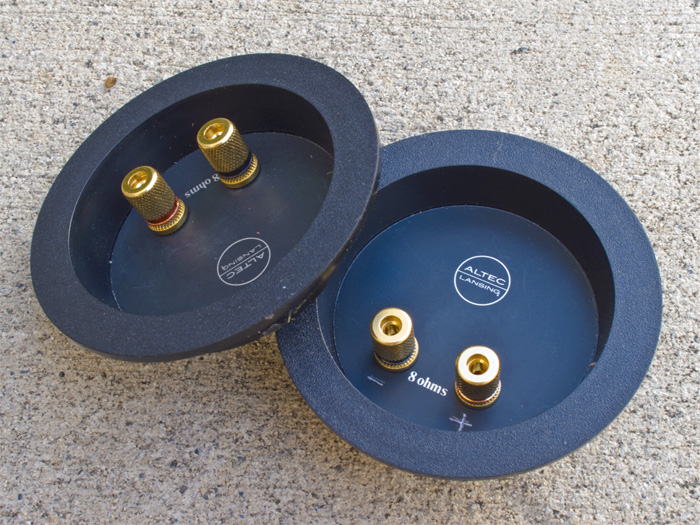

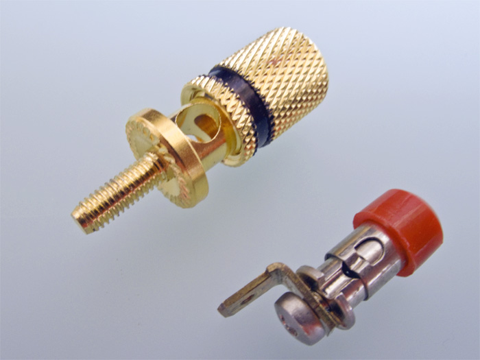

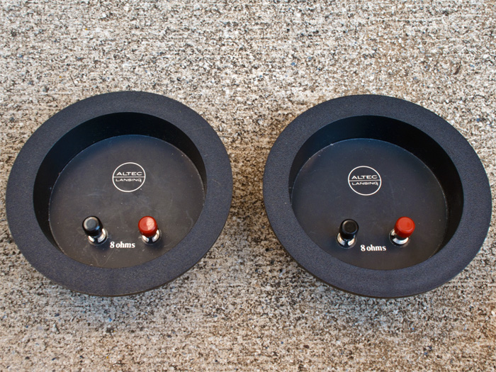

The cup that the binding posts are mounted on is conductive. (see attached photo of cup) It doesn't feel like metal, but if it is painted cast aluminum it is conductive through the paint and a poor design. This is why the x-over worked with just the x-over and speakers when testing with my friend, and didn't work when installed in the speakers at home.
I replaced the cheap factory push-spring speaker wire posts for beefy gold plated brass posts that bite the cup firmly. (see attached photo) I was so concerned with x-over issues I didn't notice the cups. Now I will need to coat the through-bolt and use some type of insulator on the front and back of the cup. What is funny is that the factory speaker pot metal wire posts didn't use insulators either, but the posts I installed dug in and make a good contact. When I tested resistance with my $10 cheapo MM on the post cup I get a small reading on the cups surface, and the same reading from + post to - post. Crazy isn't it.
