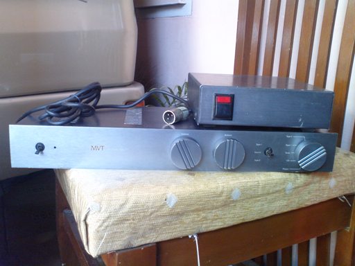

Musical Fidelity MVT class A Photo - Canuck Audio Mart

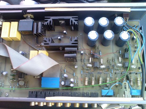

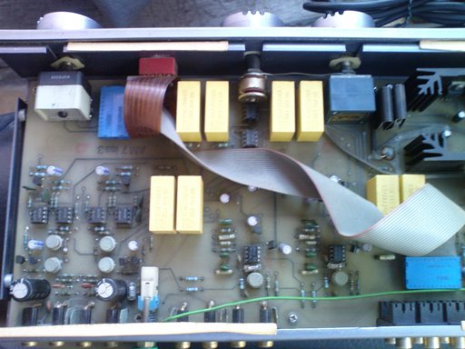

Just got the inner view of MVT,my first impression is that the allignment of the components a little bit messy and the component that are used maybe standard ones.
Should I buy this vintage preamp ?
