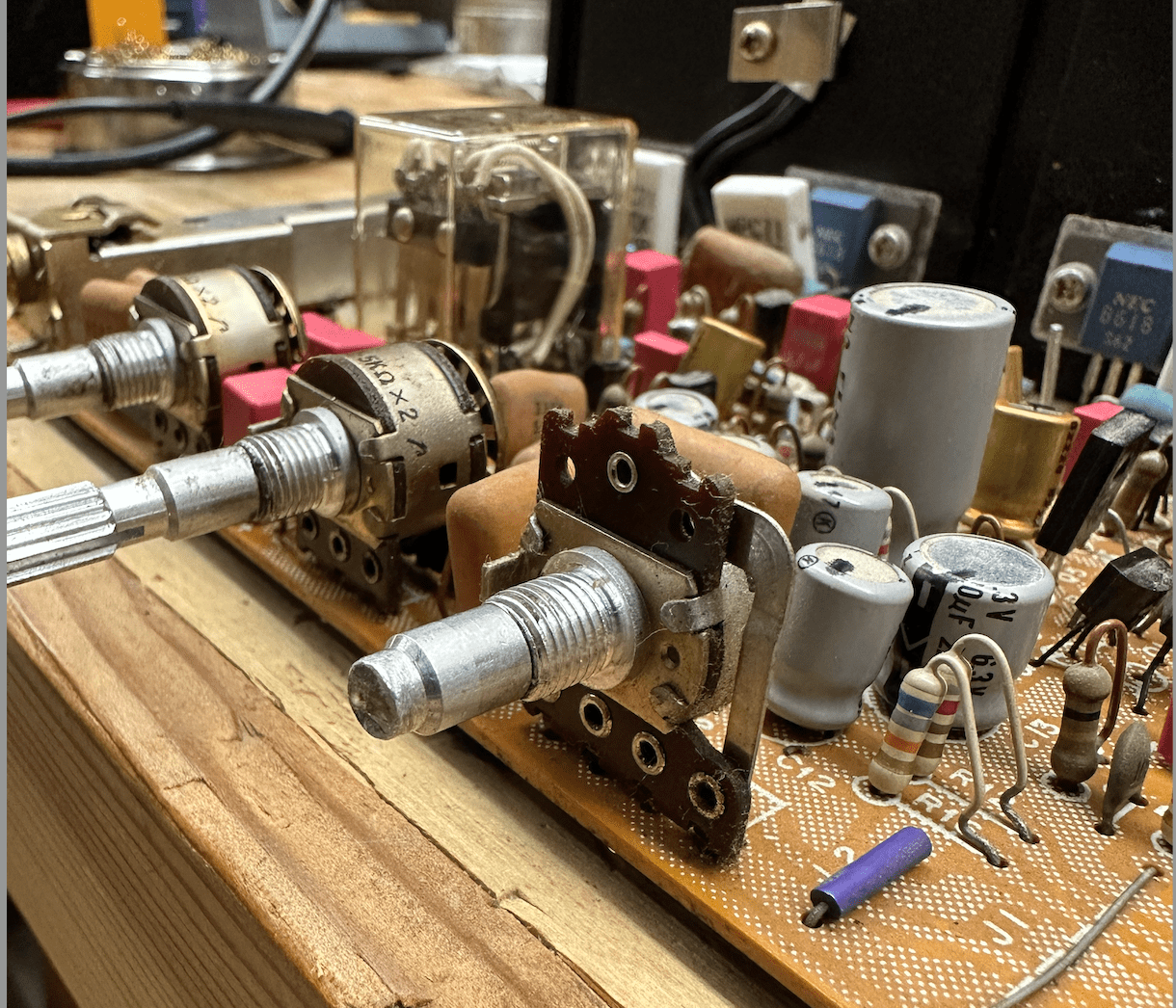

1 - It would appear to be a pot with a centre tap - am I correct? Count the terminals - are there 4 rather than the usual 3?
Note that connection 3 (ground) goes to the centre of the track AND to the wiper.
At centre position, the wiper matches the position of the centre tap.
Each channel signal has a 100k path to ground.
Move wiper up and lower channel still sees same 100k to ground so is unchanged.
Upper channel sees lower resistance to ground so is progressively muted.
The idea being that rather than raising one channel and reducing the other, one channel is reduced while the other remains constant volume.
2 - is the pot mounted on a pcb or wired? Obviously pcb mount reduces your options although you may be able to hard wire a different pot to the pcb.
3 - centre tapped pots are rare as hens teeth.
It probably also has a centre detent.
Whatever you choose to do, trial it first by linking the pot to the pcb by just dobbing some wires on the track side of the pcb so you are not repeatedly soldering & removing the pot from the pcb which may damage the tracks.
Just wiring a normal linear pot will work, just a little differently.
A 200K pot in its middle position would be electrically identical as the current pot.
In service I expect you will not move it far from centre for subtle changes therefore the difference in operation will be neither here nor there.
30mm spindle appears to be the limiting factor, can you fit an extension to a shorter shaft?
Using the 100K pot, the loss would be greater - you would turn up the volume to compensate.
Add 50K in series with each end and centre position gives the same as original loading. Turning would reduce one channel while raising the other but you would not completely mute one channel.
Adding less than 50K increases the loading at mid position. Worth experimenting. Remember what the remote wiring was for?

Thanks russc. Yeah, the pot has a center tap (4 terminals total) and a center detent. It's pcb mounted too. I forgot to attach a pic of the pcb/pot. I'll do that now.

As for experimenting, it's going to be difficult because it's very time-consuming to remove this board from the receiver. It also involves several wire-wraps (which I've never done before but have a tool on the way), and the wires are a bit brittle now. I'm hoping I can figure out a good solution without having to try it in the circuit multiple times. That might not be realistic though.
