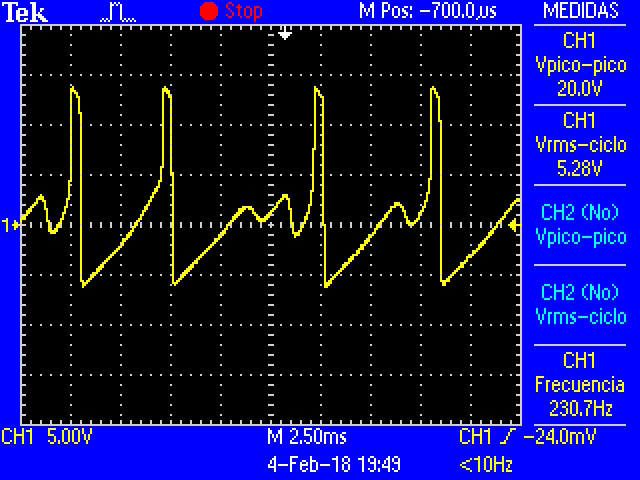

NOW, this is what I get (attached).
Connected to a test speaker, the sound is unbearable. 🙄

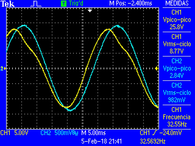

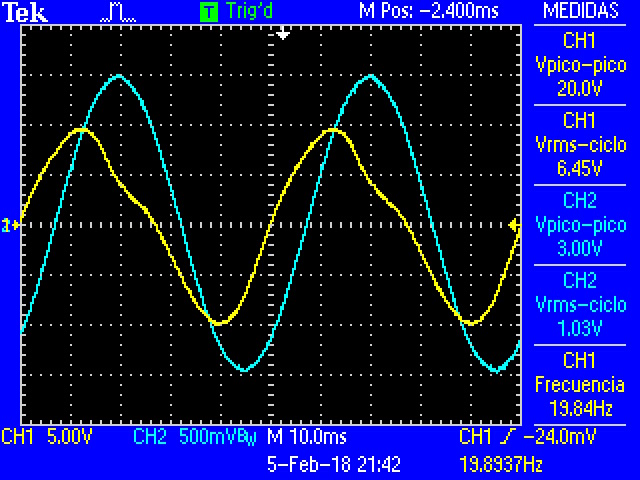

I've been taking some measurements of the amplifier/OPT, in search of core saturation, to validate my air gap. This is my first air gap, so I'm seeking for some feedback.
I've attached two scope captures.
One is with output tube working in UL (25%), the other one is triode strapped.
Cyan is input signal.
Yellow is output (to an 8 ohm dummy load).
Both are very close to full power.
I decreased frequency, in search of core saturation (to validate the chosen air gap), until I got this distorted waves.
Are they showing core saturation? Or just inductive loading on the output tube?
With triode, it happends at a lower frequency, so it makes me think this is just the primary inductance loading the stage.
Is there any other way I can check my air gap?

Which is the power and the plate current you wanted it to be designed for? Anyway, a 75 µm air gap appears to be rather narrow. I'd expect somewhat in the tenths of millimeter's range. Try 0.5 mm.

8W and 80 mA quiescent current.
It's a 0.15 mm aire gap. The sheet of insulation is 75 µm.
It gets down to 20 Hz, full power (triode strapped).
But I'd like to learn how to measure the saturation frequency, or the low cut-off due to the inductive loading of the primary.

6A3sUMMER , thanks for you very detailed reply.
After some more study, I got some nice results.
Just to share them with you, here they are.
Primary inductance (measured under working amplifier, and dc current):
13.08 H
Core saturation frequency (at triode full output power):
20.2 Hz
Core saturation frequency (at -6dB full output power):
14.5 Hz
The low cut-off frequency due to inductive loading of the primary, is 34 Hz.
So the air gap is perfect!
If I increase it, primary inductance would fall, and with it, the low cut-off frequency would raise above 40 Hz, much before saturation effects come into play. Don't want that.
More primary turns would be needed to use a bigger gap, and get better bass response overall.
Or decrease primary impedance, which I can't (it is already low, near 2k5).
As I filled most of my winding window, this is my best right now.
So, I'm quite happy with this, my first SE OPT 🙂

14.5 Hz

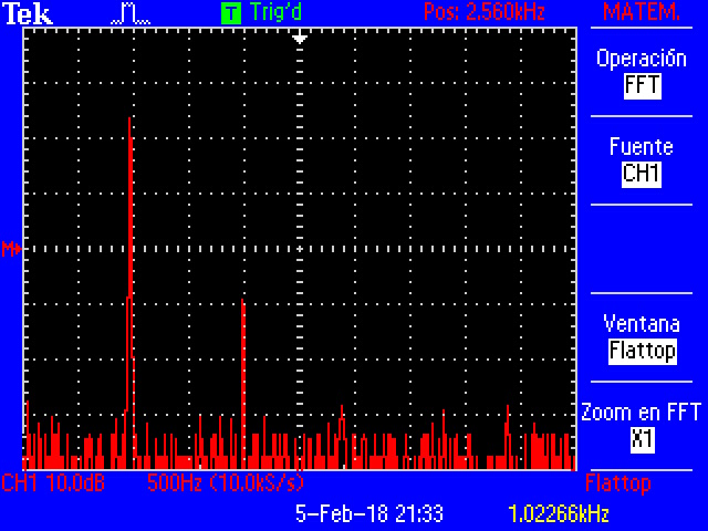

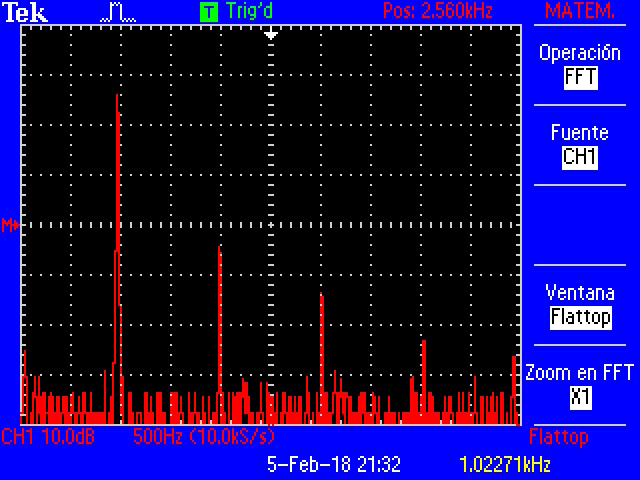

Listening to my first SE OPT. Lacks bass and power.
I just finished a SE amplifier which uses my first handmade SE OPT on one channel, and another profesional OPT on the other.
My OPT seems great in basic tests using generator/scope, and it didn't saturate, even at 30 Hz, full power. Voltage ratios (anode, and UL tap), as expected.
Now, it doesn't sound really bad, but comparing it to the other pro OPT, there's a definite loss in bass and volume, and a bit "trashy" sound (though no distortion, and relatively clear voices).
I tried both ultralinear and triode modes.
I'm planning to dissasemble the enclosure to add some more gap, and re-test (I already did this in the scope test, and the gap seemed to be just fine, but this time I'd a listening test instead).
Appart from this, is there anything I could? Any advice?
Thanks!
Thanks!
