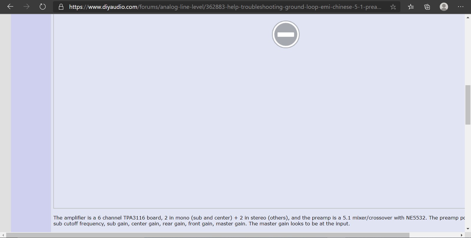

I have deleted your URL for an image because not only was it blank but it is also pushing the margins into the next room 😉 as you can see.
Please attach images correctly like this:
How to attach images to your posts.
Strange. This is how I saw the preview and it looked great to me. I'll do it that way next time. Thanks for letting me know.
I tried to update the post as requested but after the update, when I got back to the thread, my whole post was gone

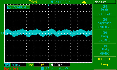

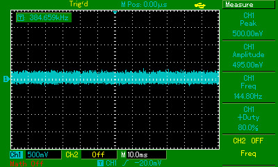

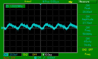

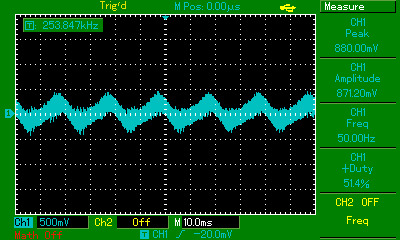

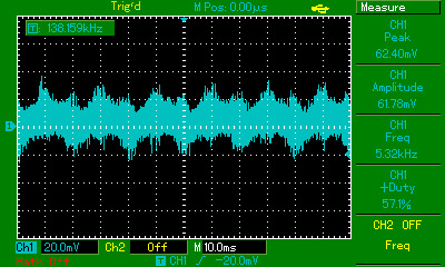

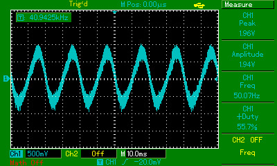

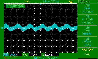

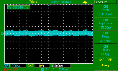

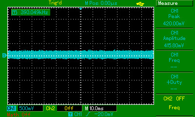

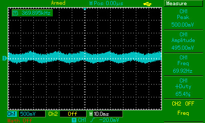

Hi. Some scope images.
All scope images were taken with the setup as you see on first post's picture, except no input flat cable connected and amp's input signal ground coupled to power ground. Measured at amp's sub out and will all pots at max, unless otherwise stated.
1: all pots at max, touching no where;
2: ", touching any pots's shaft;
3: ", touching any ground point;
4: main volume at 50%, no touching;
5: main volume at 0%, ";
6: sub gain at ~50%, ";
7: sub gain at 0%, ";
8: all pots at max, measuring preamp's sub out;
9: disconnected preamp from amp, measuring sub out;
10: ", measuring preamp's sub out.
After this I can see the 50hz noise is mostly on the preamp. I can also see that the noise is most affected by each channels' gain and no so much by main volume.
Does any of this makes sense?

I think this one may sort itself out once you:
1. mount everything in a metal chassis connected to audio ground via the RCA jacks, with pots screwed in.
2. twist your secondary-side wiring properly
3. get power transformer leakage current addressed (how is the TPA3116 supplied?) - try connecting power supply ground to a maybe 10 nF Y2 rated capacitor to protective earth (PE), obtained via a corresponding 3-conductor mains cable.

1. I confess I got demotivated once I notice the noise and didn't even bother to put everything together in the box. I'll try that soon!
2. I'm not sure how to twist these 3 wires and I couldn't find any useful info on that too. This is a centered tap transformer. Can you please give me a hint?
3. The TPA3116 is supplied with a 24V SMPS with the PE connection floating by now and the ground (V- or 0V) connection is coupled to the preamp's ground on the TPA3116 board by a solder jumper. If I connect PE to the SMPS PE through a capacitor, how do I connect the chassis ground to the PE - I mean, to which side of that capacitor? FYI, my home doesn't have PE on most outlets.
4. Should I be worried about screwing the SMPS case and the transformer directly to the chassis?
