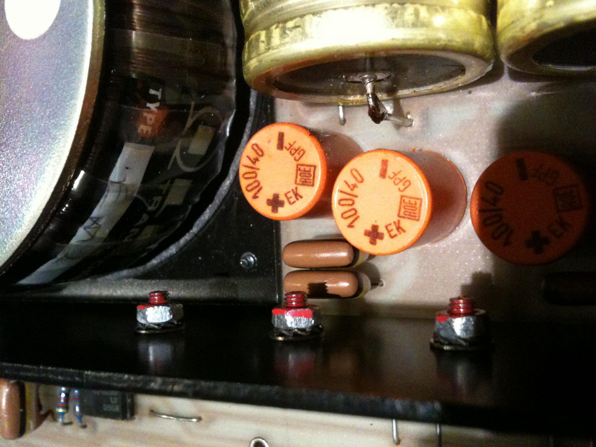

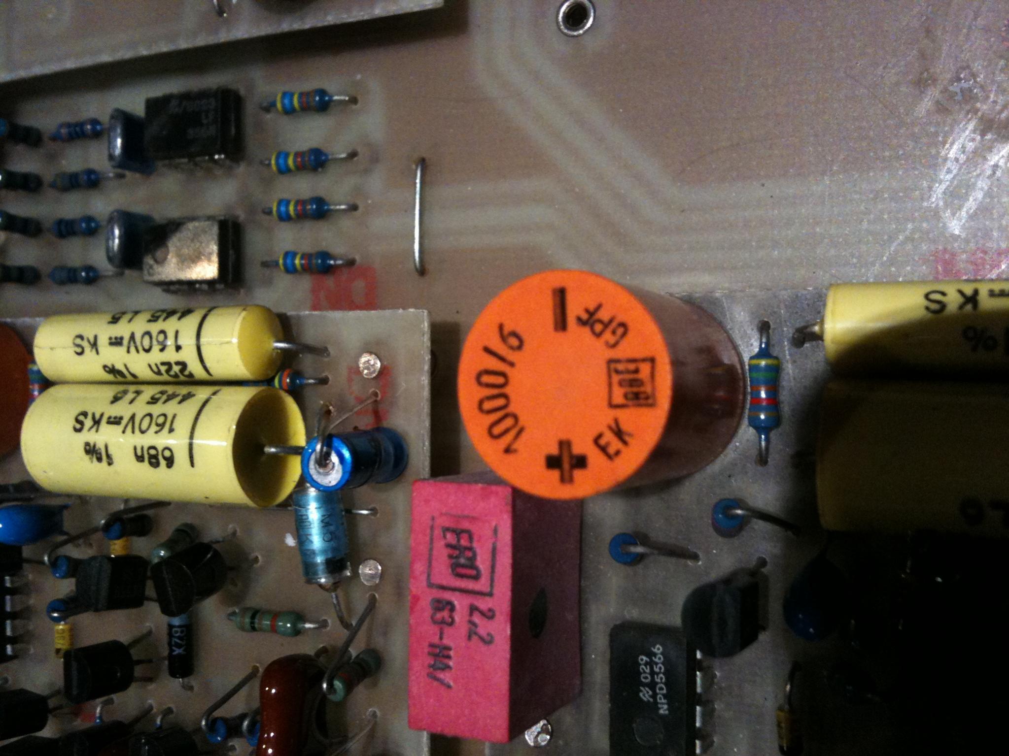

I like to recap my 20 years old preamp. However there are some capacitors I never see them before. Can someone tell me what they are so that I can get the proper replacement capacitors?
They are Al Elko's in a thermosetting case. Excellent quality, should be in pristine condition after 20yearsI mean the capacitors in orange color.
1000uF/6V. It might be difficult to find a 6V cap (small size), especially at the same quality as the ROE.

The preamp is about 25 years old and the audio sound coming out is very good and sweet. Should I still bother to replace them or not? If I should, what brand of replacement caps should I get to keep up with the high quality?

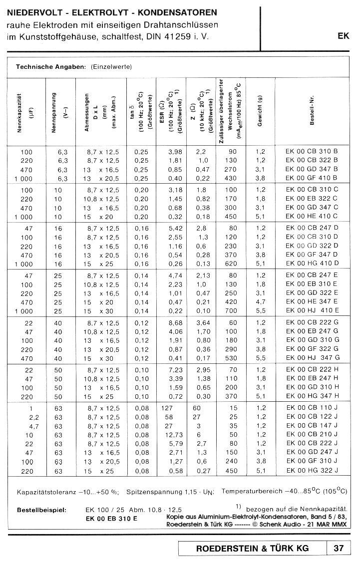

they're Roederstein EK series (5mm pitch, -10% to +50% , -40C to +85C)
(yellows are Philips KS445 series polystyrene)

The GPF print on the electrolytic caps is a DIN code, the EK series are switch tolerant types (what German lytic cap manufacturers commonly refer to as "schaltfest")
Capacitance of these caps doesn't deteriorate at switch-offs, comes in handy at phono board locations.
Replacements are smps suitable lytics, or if it's supposed to remain something German, a Frolyt : FROLYT Radial Lead Type
