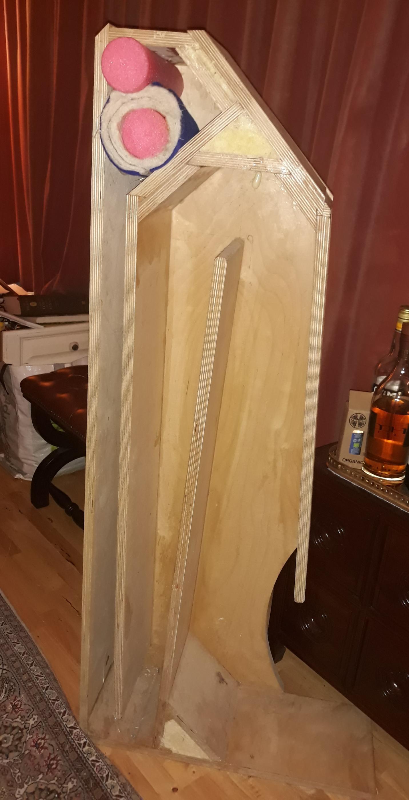

Apologies for not including more helpful details in my first post. Attached is a picture of one of the speaker cabinets which looks very much like the one planet10 linked to. I believe we have the parts for the inside (the Fostex speaker looks incredible familiar).
As it stands I have the cabinets and what I think are if not all, most of, the parts to fit the speakers together. What would you suggest - does anyone know who could build them for me?
Yes, that sure looks like Austin A166. That speaker looks like it only needs a second side, the deflector, the supraBaffle, some sort of finish, and the driver. I question the amount of damping in the Air Cavity thou. All the hardest parts look done.
Well worth finishing, the speaker, driven by a suitabel amp, will bring joy to you and your family.
What assocoated kit do you have?
