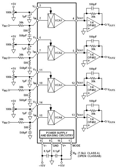

Hi!
I've been reading, searching, testing, trying to learn PIC and AVR programming, burning some chips and my neurons, among other things.
Finnaly, I've found somo interesting: the Analog Devices SSM2164.
This is a quad VCA with low distortion, operating in Class A (adding a resistor).
The moral of this history is the following one:
I need to control the volume of my six inputs (5.1) amplifier - I'll use it in the pre-amp.
My question is this, as I can't find the answer in the datasheet:
The VCA is controlled by a 100k pot. If I connect pins 3, 6, 7 and 14 of IC1 and 3 and 6 on IC2 together (control pins) and connect them to the central tab of the pot, does it work like a "Danish Audio Connect" CT2 ??
Down here is the basic schematic of one SSM2164.
Regards
Pedro Martins

As nobody answered me, I've tried all by myself.
And I've got good results.
Low noise and no distortion audible. I'm going to measure the outputs with my PC and some cute software to check the %'s.
I'll use a buffered pot to drive all the control inputs.
Thanks anyway
Pedro Martins

Thanks for all replyes!
I attach my first design of the preamp and if someone can comment, or help, I'll apreciate a lot.
It's 'very' uncomplete
The volume control is a pot connected to + 5V and Gnd, where the center tap connects to C33 and the control inputs of the SSM's.
The outputs are taken from U7, 8,9 and 10.
I'll post the complete schematic as soon as I test the output configuration.

Hi ppl!
The sch is complete!
Changes:
- Output opamps;
- Connector to the VCA Control ('para o controlo de volume' at the bottom);
- Connector to the L+R summing and low pass filter to the sub (on top 'para o filtro de subwoofer');
- Switches for audio listening and dvd viewing
COMMENTS??? ... are welcome
