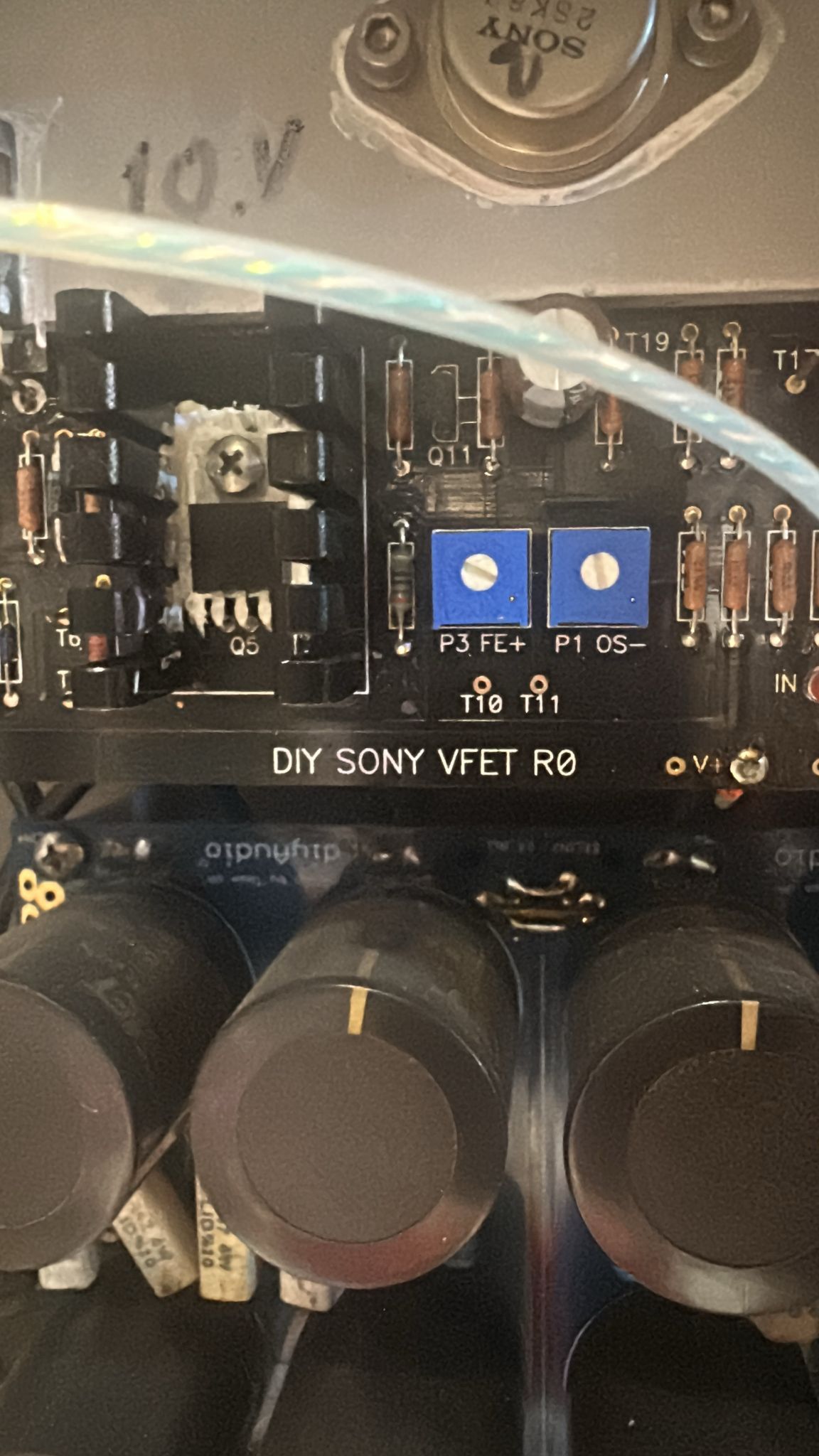

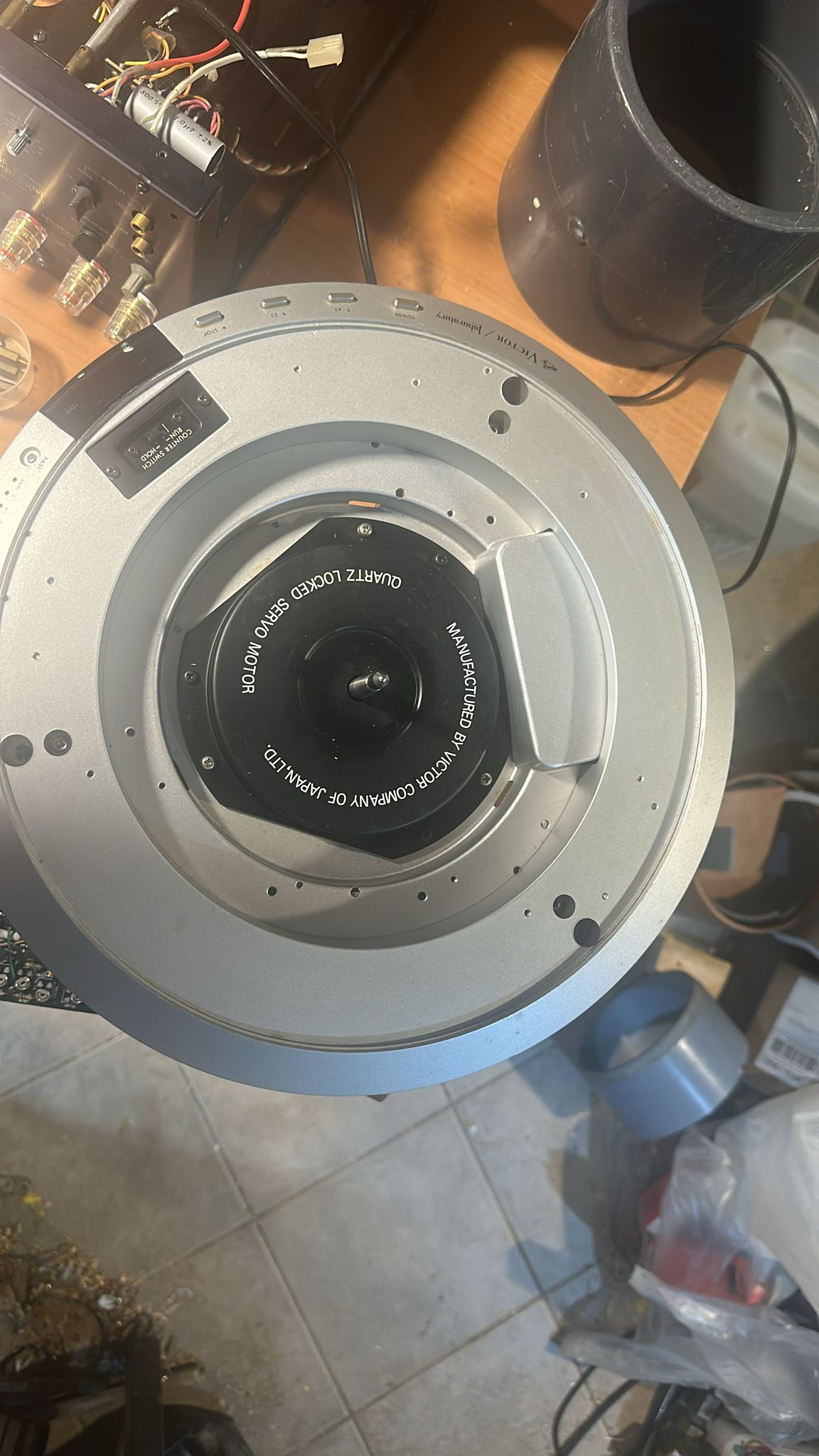

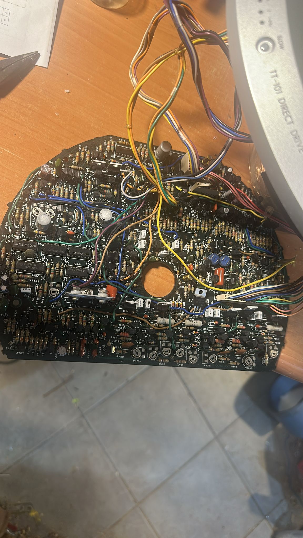

I'm sharing a slightly different kind of post here, hoping it will find its way to the right people. I’d truly appreciate any shares in relevant places.With great sadness, my family and I recently said goodbye to my father after his battle with cancer. My dad was a very special person, and there’s so much I could say about him—but in the context of this group, there’s one thing in particular that stands out: his deep passion for sound and audio.
Over many years, he acquired an impressive amount of knowledge, technical skill, and understanding, which he used to restore, upgrade, and build a variety of equipment—from amplifiers to speakers, turntables, and more. Before he became ill, he had started working on several projects, but sadly had to stop midway, and now they sit unfinished with an uncertain future.
I’ll be the first to admit—I don’t have the expertise my father had. What I do share with him is a deep love for music, which was one of the strongest bonds between us. But unfortunately, he didn’t pass down his technical skills to me.I’m posting here because I feel that my father left me with a mission—his legacy, if you will. And I’ve made it my goal to try and complete the work he couldn’t finish himself.
I’m looking for a mentor, a guide—someone who can help me understand where to even begin with these projects that meant so much to my father. I’ve attached some photos of what he left behind, in the hope that someone might see the value in this and, out of love for this beautiful world of stereo and sound, help me breathe life back into a dream that’s been paused.

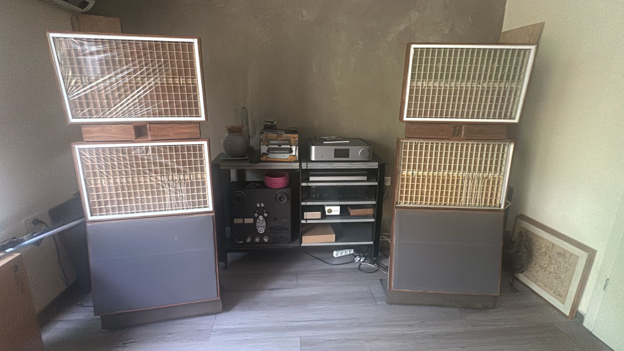

(Just a note: all the items shown in the photos, except for the QUAD speakers, are unfinished projects. The QUADs are functional—I included them to give a sense of the level of investment and dedication my father had for this craft.)
*A pair of Quad electrostatic speakers — rebuilt and fully functional
*Sony's VFET R0 Diy Kit
*JVC TT-101

Hello
Welcome. Your endeavor in your father’s memory is admirable and I wish you the best of luck.
The pictures you posted of the SONY VFET amps look like they were completely assembled, but perhaps they have some issues that prevent proper operation.
That particular amplifier design is considered a bit advanced for a beginner…even if you were starting from scratch and following it’s documentation and build guide found here:
Trying to diagnose problems with circuits that have already been assembled and that have unknown problems is a whole different skill set. Not one I could offer assistance with for sure.
There are some very talented and generous souls on this forum that often help people diagnose problems with equipment or circuits they own or have built.
The Pass Labs forum is the area with all the experts (including Nelson Pass the designer) on this particular SONY VFET project.
Assuming you have the ability to operate a digital multi meter to take measurements for various resistance and voltages, you may be able to start working through basic tests on the circuit with the help if people there.

Nelson Pass testing procedure and instructions for DIY Sony Vfet amp -
Print this out!! 🙂
http://www.firstwatt.com/pdf/art_diy_sony_vfet.pdf

Maybe concentrate on one item at a time to completion before starting the next item.
For the diy sony v-fets, I suggest starting a post in the 'Pass Labs' section, as these were designed and released by Nelson Pass.
https://www.diyaudio.com/community/forums/pass-labs.8/
For the JVC turntable, I would make a post in the analogue source forum.
https://www.diyaudio.com/community/forums/analogue-source.11/

Sorry but there seems to be a non PE power distributor on the floor. Please check if you have Schuko type H wall sockets with PE and if so use a type H power distributor with PE for safety and correct working mains filtering in devices etc. I can very well be wrong but checking will not hurt.

I'd start disconnect VFET amp from power supply and then test PS first. Once its working, check all VFET amp and parts individually. Read Nelson's PDF manual with link above and use the test hints. Learn how to use multi-meter, basic OHM's law, power formula, identify components, soldering skills, electrical safety, etc. and hang on to this forum more often. Everyone was a lamer before they become elite.
