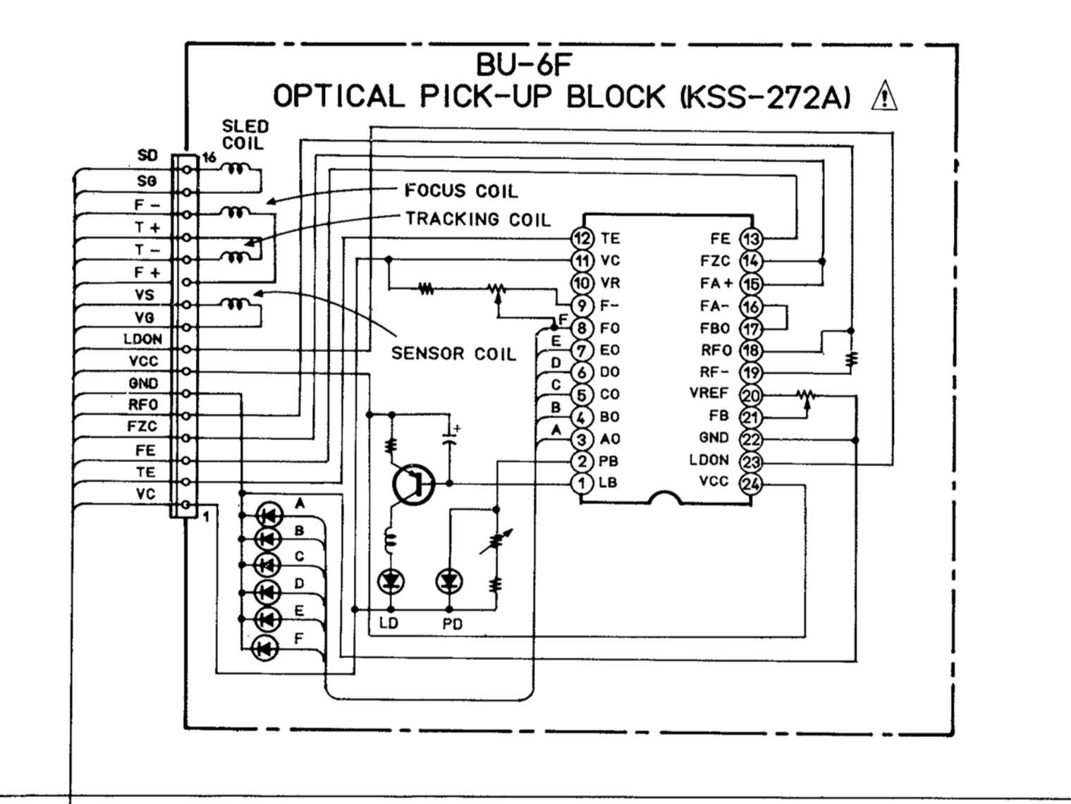

Thanks @NareshBrd - the lens is cleaned (it was clean anyway).
So the pots are on the laser sled for this player, and there are 3 of them - FO, PB, FP - where would you start?

There are 3 pots on the laser sled - FO, FB and APC. I think it is this last one that controls power, but would appreciate a check on that if anyone knows better.
fran
Hi. Power laser is APC. FB is F-E Balance, and FO is Focus Offset. Another thing, for to see RF signal in an oscilloscope, use probe attenuation x10. If you don't use a probe with attenuation, maybe the RF signal showed is low than real, and distorted. 750mVpp is low, you don't have nothing to lose. Move APC potentiometer and do the best you can.
Another tip, these 2k2 potentiometers varies its value throughout time, maybe the problem is not the laser, maybe is these tiny potentiometer. Best regard

The other test you can do is to measure the DC voltage across that emitter resistor that connects to the PNP transistor. The current is then calculated using ohms law and compared to the value printed on the pickups serial number label. The last three digits correspond to the current so 12345596 would be 59.6 milliamps.
The current only flows when the laser lights and extreme care is needed when measuring. One slip of the probe and the laser would be destroyed. Safest way is to tag extremely fine leads across the resistor and connect those to the meter.

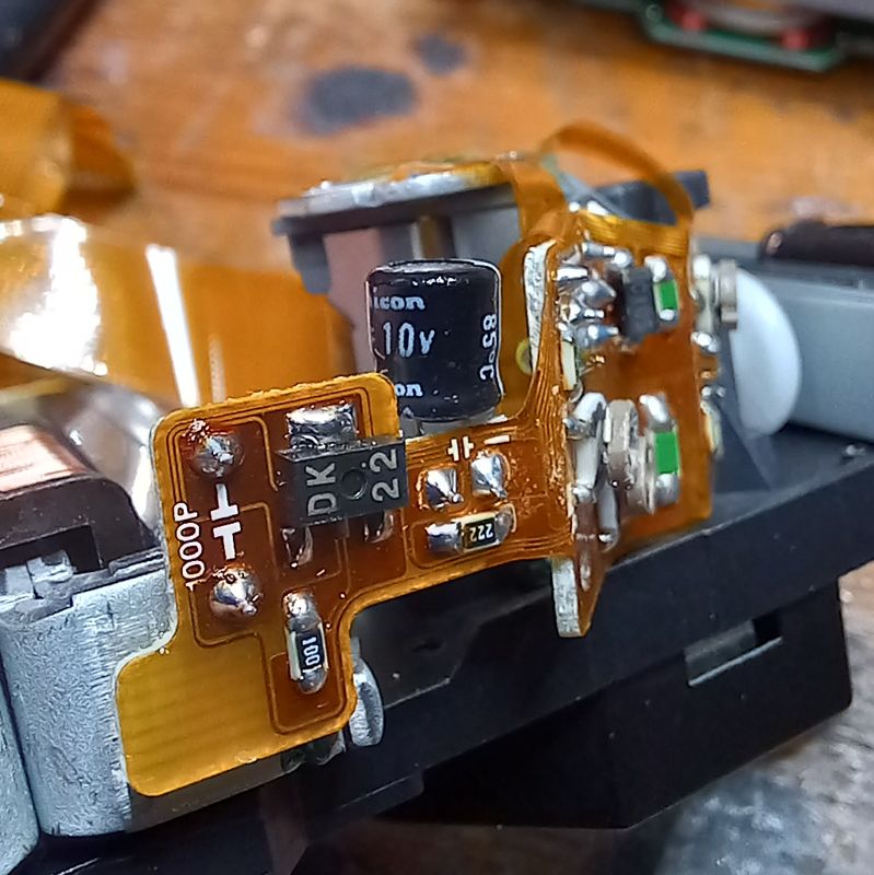

So o got looking at this more closely. I noticed a small electrolytic on the sled board. It had quite a high esr on my old meter. Not terrible, but not as low as it should be for that size (6 or 7r from memory, but on my meter even bigger caps measure less than 1r). Anyway I don't have a direct replacement. It's 33uf, and I only have 4.7uf in the same size. Is it worth swapping and seeing would that work?
Hi. The resistor for to measure laser current is this smd resistor of 10 ohms, it's labeled 100. As you can see, the resistor is in the laser pickup, it is not easy to measure its voltage.
The capacitor should be replaced, but is not the main problem.
This capacitor must be replaced due to its ESR being >10 ohms. Based on my experience, the uF value of the replacement capacitor can be either 33uF or 47uF. But 4.7uF would be too low. This capacitor functions as a low-pass filter for the APC feedback loop. When the capacitor ESR goes way up then the APC circuit will oscillate or become noisy, thus preventing the optical pickup from functioning.
Vintage Philips CD players which have CDM2 or CDM4 optical pickups have 33uF (or 47uF) APC capacitors which frequently fail with excessively high ESR. But these capacitors aren’t located on the optical pickup itself. Rather they are located on the main PC board (CDM4) or on the servo “sub PC board” underneath the transport. This make it easy to replace them because the size of the replacement capacitor doesn’t matter.

This suggests that the APC circuit is oscillating due to the dried out 33uF capacitor.
This capacitor serves as a low-pass filter for the APC feedback loop. When the capacitor ESR goes way up then the APC circuit will oscillate. This oscillation could be the reason why you cannot raise the laser current above 54mA.
You might want to go ahead and try the 4.7uF capacitor which you already have. In my opinion the ESR is more important than the uF. So the 4.7uF capacitor may work OK. However it would be best to eventually get a 33uF or 47uF capacitor of the correct physical size.
I recommend rotating the APC trimpot back to midrange before applying power. Otherwise there might be too much laser current after replacing the capacitor.
With a good capacitor installed then you should be able to adjust the laser diode current to within 10% of the original factory value without needing to rotate the APC trimpot all the way to the end.
