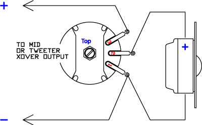

I have my pair of 3-way speakers that I built, and I'd like to add two L-pads to each enclosure (one for the midrange and one for the tweeter).
I tried finding a wiring diagram for this and I did (on another forum), but it confused me because it was combined with crossover components.
Each enclosure has a pre-assembled crossover board, and I have four AT-50H L-pads (two to add to each enclosure - midrange and tweeter).
I know the use of pre-assembled crossover boards and L-pads isn't to everyone's liking, but "it is what it is".
If anyone could provide me with the wiring information / diagram for adding two AT-50H L-pads (one for the midrange and one for the tweeter) to a 3-way speaker with a pre-assembled crossover board, I'd be very grateful.
Looking forward to hearing back 🙂
Does this help?
