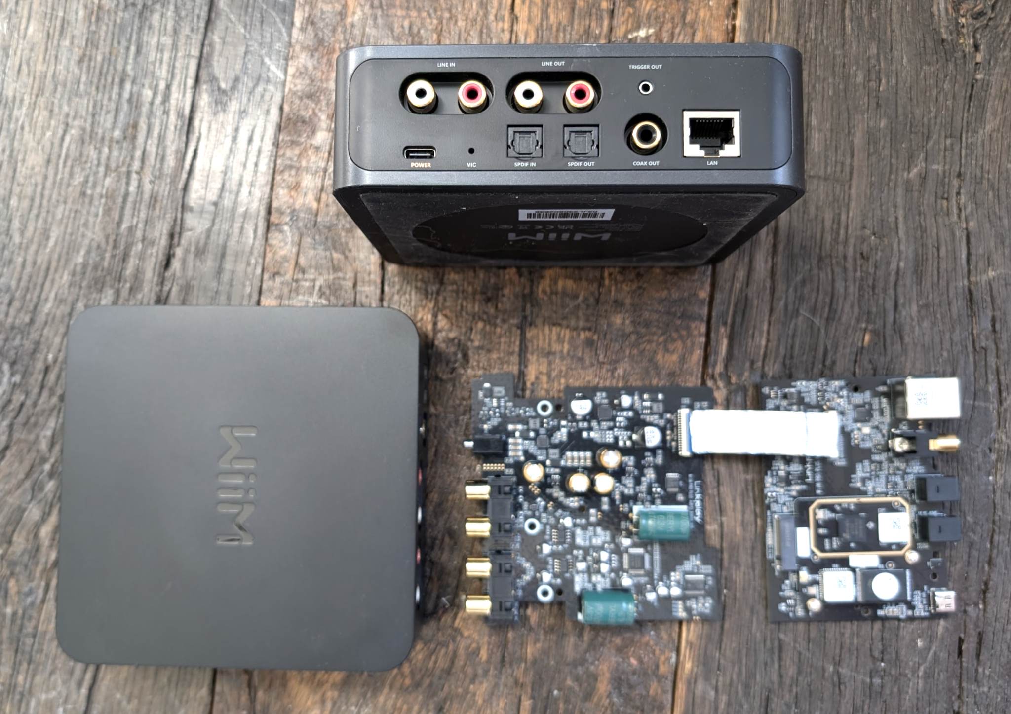

Hi - I'm hoping to build a 1u 4x WiiM Pro Plus case for a CI application, but need advice, so my fingers are crossed that I've come to the right place.
Here are the design goals:
Does anyone have any experience with 3d printing custom face plates for rack-mounted solutions or advice on where to go to get a prototype built?

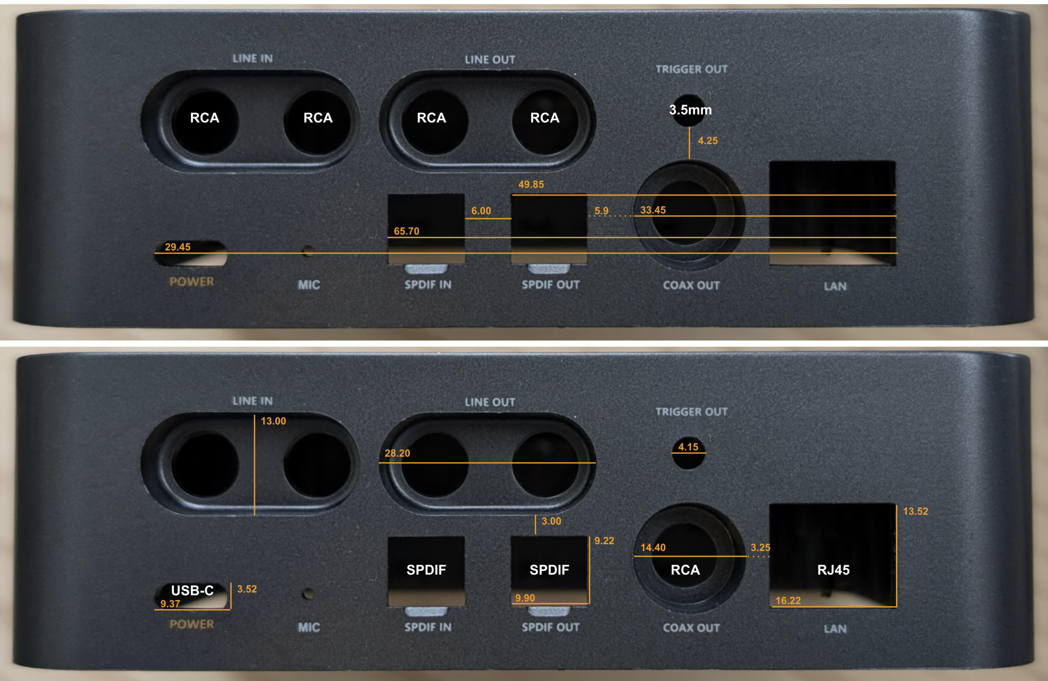

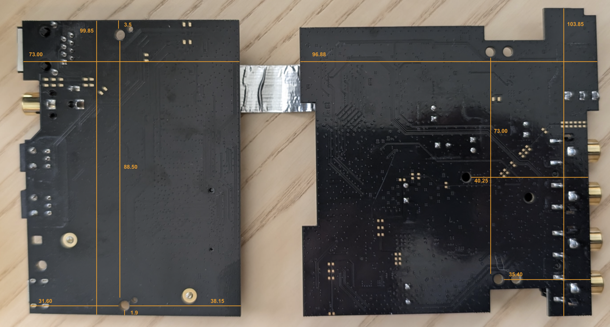

My hope is that we'd just need to replicate the port section of the Standard WiiM backpanel in a 4-wide setup. With a case, the WP+ is 5+ inches, but the PCBs and the backpanel ports are just under 4" wide.
The ultimate setup would be to un-clamshell the WiiM internal PCBs and get 8 WiiMs into a 1U rack setup, as I have no need for WiFi or Analog I/O, so the custom backplate could just expose the bottom half of the WiiM backpanel. Not sure what that would do for heating, though.
Thanks in advance for any help / guidance!

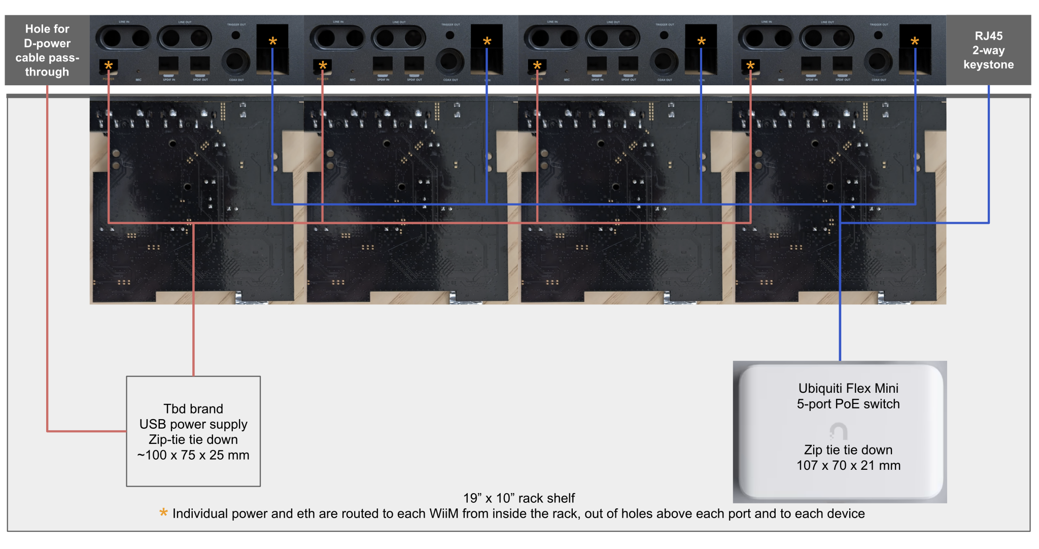

- 1U form factor
- 4x (8ch) WiiM Pro Plus to match a 1U 8ch CI amp
- Airplay 2 support (rules out a possible Origin Acoustic CI 4x WiiM that has yet to pass FCC testing)
- 1 power plug & 1 eth plug to the 1u appliance to minimize rack wiring & save on rack switch port capacity
- Eth-only streaming - no wifi necessary
