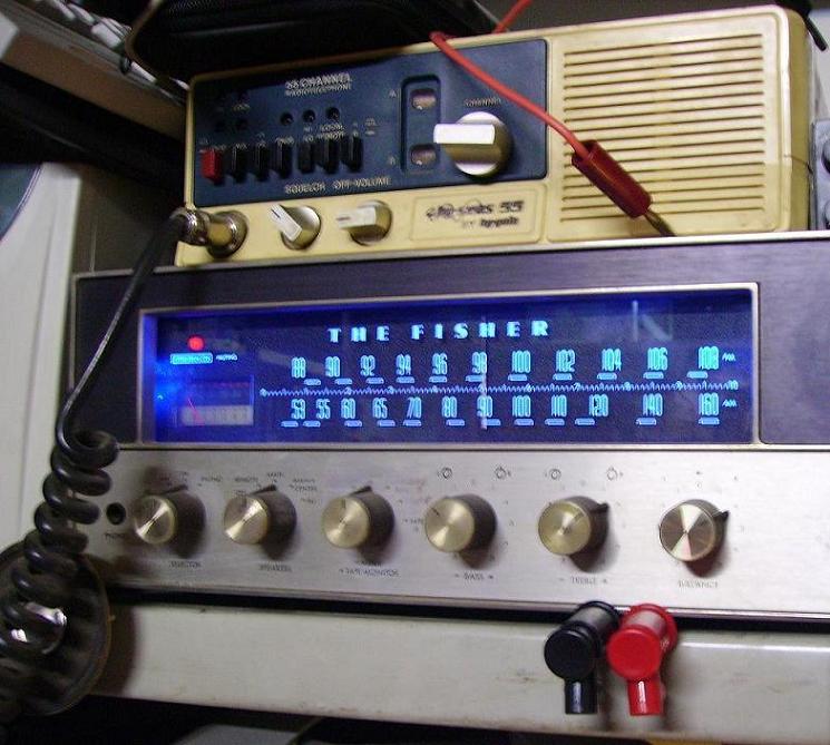

had the exact same problem with my Fisher receiver and here is what i did ....
isolated the voltage ( normaly is a sepearted winding in the trafo , used bridge capacitor to make this dc and then use this wonderfull DC voltage through resistors to drive big nice blue leds !!!!!!!!!!!!!!!😀 😀 😀 😀 😀
trendy .... dont you think ????
