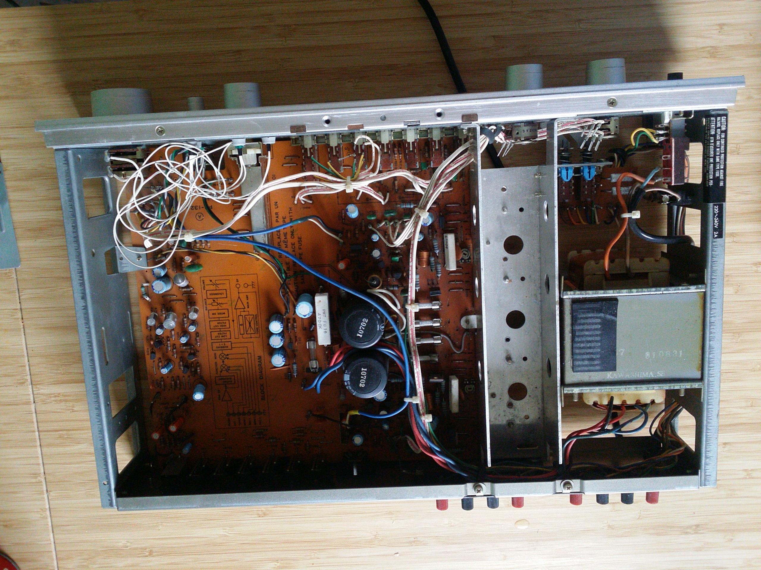

I am attenpting to repair the Luxman A-113A but my knowledge are somehow limited.
The problem is the left channel distorts. when I tried to bias the left channel the current was going up and down like crazy never getting a constant value.
I start measuring some values according to the service manual and notice the NPN driver was mad hot. measuring the base I get 0,8v and in the service manual points to 1,2v. I tried to replace the transistors already but the behave keeps beeing the same.
can you give me any tips here to measure next and identify the cause?

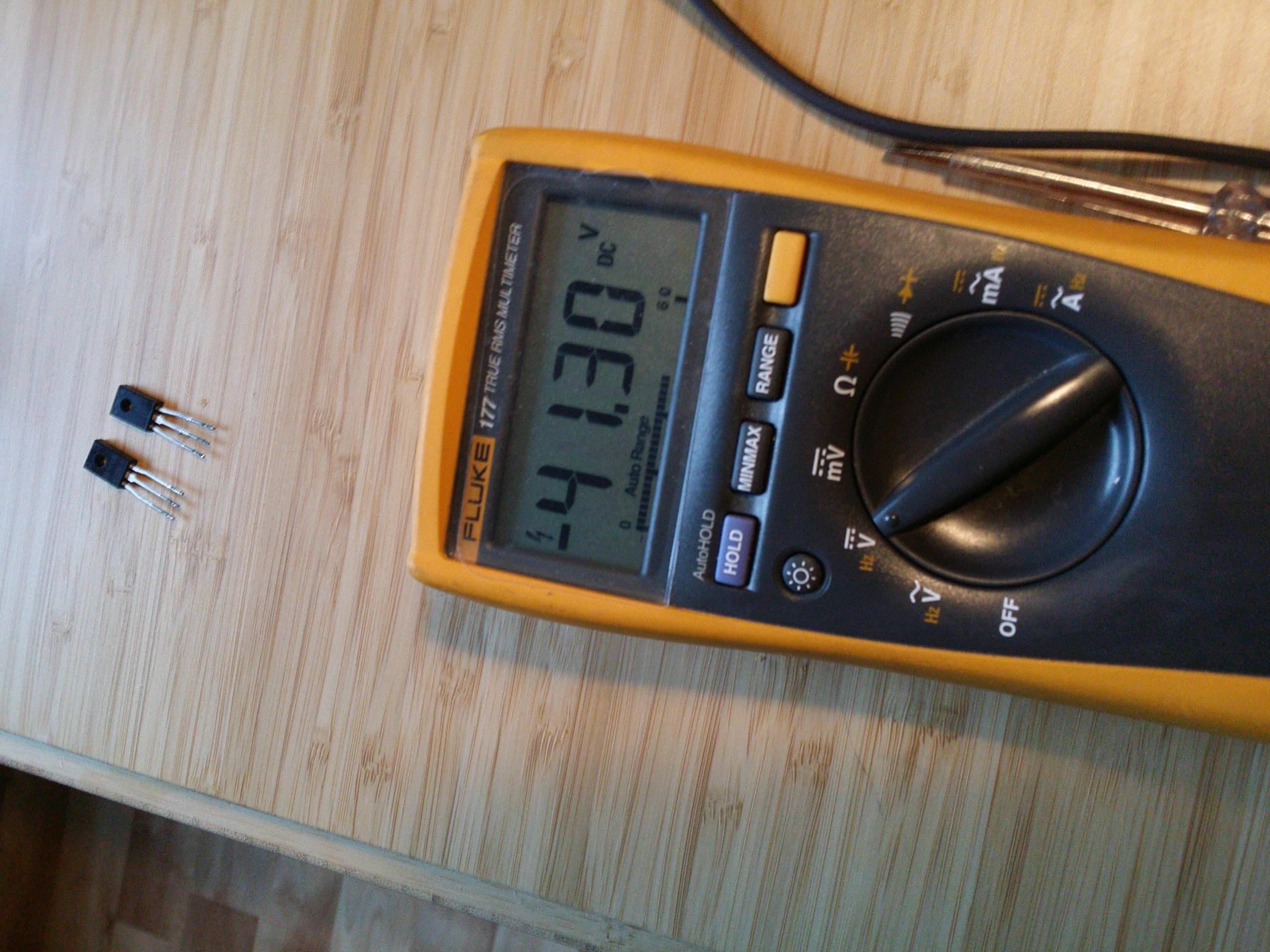

I checked and I have +41v and -41v in each rail (posted some photos). a bit lower than the service manual says ~43v. The ac input is 228v in my grid and before the rectifiers diodes it measures 30v AC.
I talked with the owner of the amplifier and he said that the speaker cable shorted with the chassis of the unit, which made the main fuse blow. After replacing the fuse, the right channel seems to work just fine (although was repaired previous by someone who changed the driver transistors) but the left is misbehaving with a lot of distortion and heating up a lot the npn driver transistor.
I went a bit further and desoldered back the transistor drivers and the power transistors. the drivers seem good when I tested with my diode check function on the multimeter. The NPN power transistor has a short from the base emitter junction 🙁 the PNP seems fine with around 0,6 drop voltage between be and bc and no short on the ce pins.
Is there something more I can check before finding a replacement power transistor?
