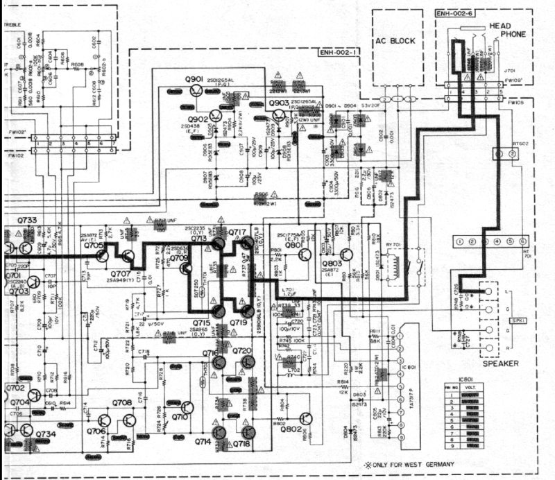

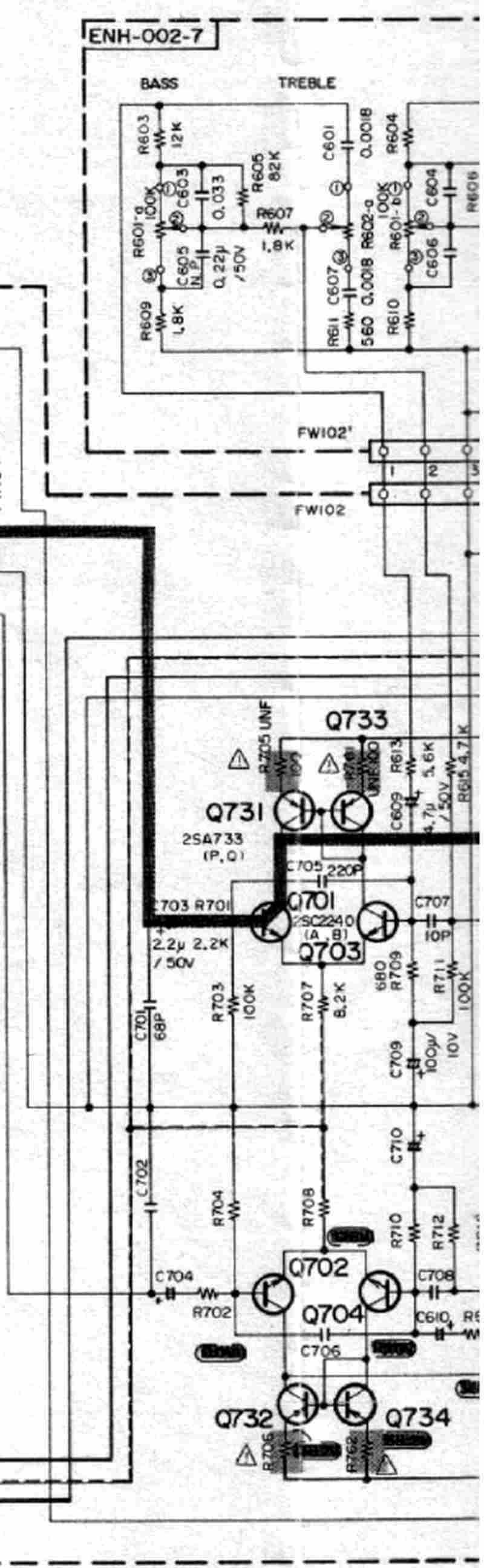

of course, please find attached, maybe you downloaded only 1 file?

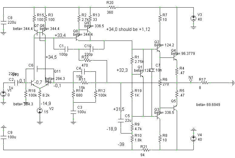

Hi
I am going mad,
all of the parts are ok...
Please look at simplified schematic with measured voltages (with output transistors unsoldered).
At VAS collector is far more voltage than needed.
Is it possible that the transistor when unsoldered measures ok and under certain voltage is broken?
What part should I check one more time?
