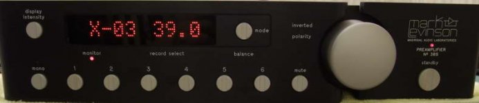

hi,
my ML 38s preamp damage by wrong voltage, i check it the line part is good, problem is on logic control, the logic have three programable ic, if once damage must cant power on, one is cpu(mc68hc11a) one is eprom 27c512, one is peel18cv8, the problem is on peel18cv8 because its very hot, and cannot read data use my universal programmer, 27c512 is ok and have read the data, the cpu i check ref voltage also is ok
now i have new peel18cv8 but have not the inside data, please help me where can get the data, i have ML 332 also use peel18cv8 to logic control, i use 332 18cv8 in 38s, the panel have respond but not proper work, i think 18cv8 is differ version because the label code is differ

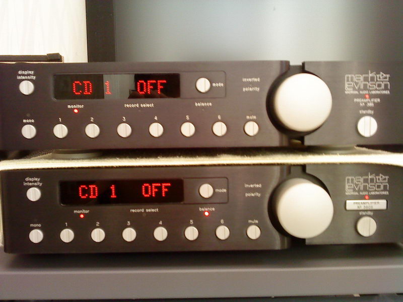

I know this is an old thread but I have a failing 380s that I believe is starting to have a problem with the PEEL 18cv8. Does anyone have the code off of this chip or know if the security bit is set or not?
PM sent. Also have you looked at the 68HC uP? Do you know if there is any custom config in the processor. When I get some time I will investigate. Trying to keep my 380s alive as long as possible.
