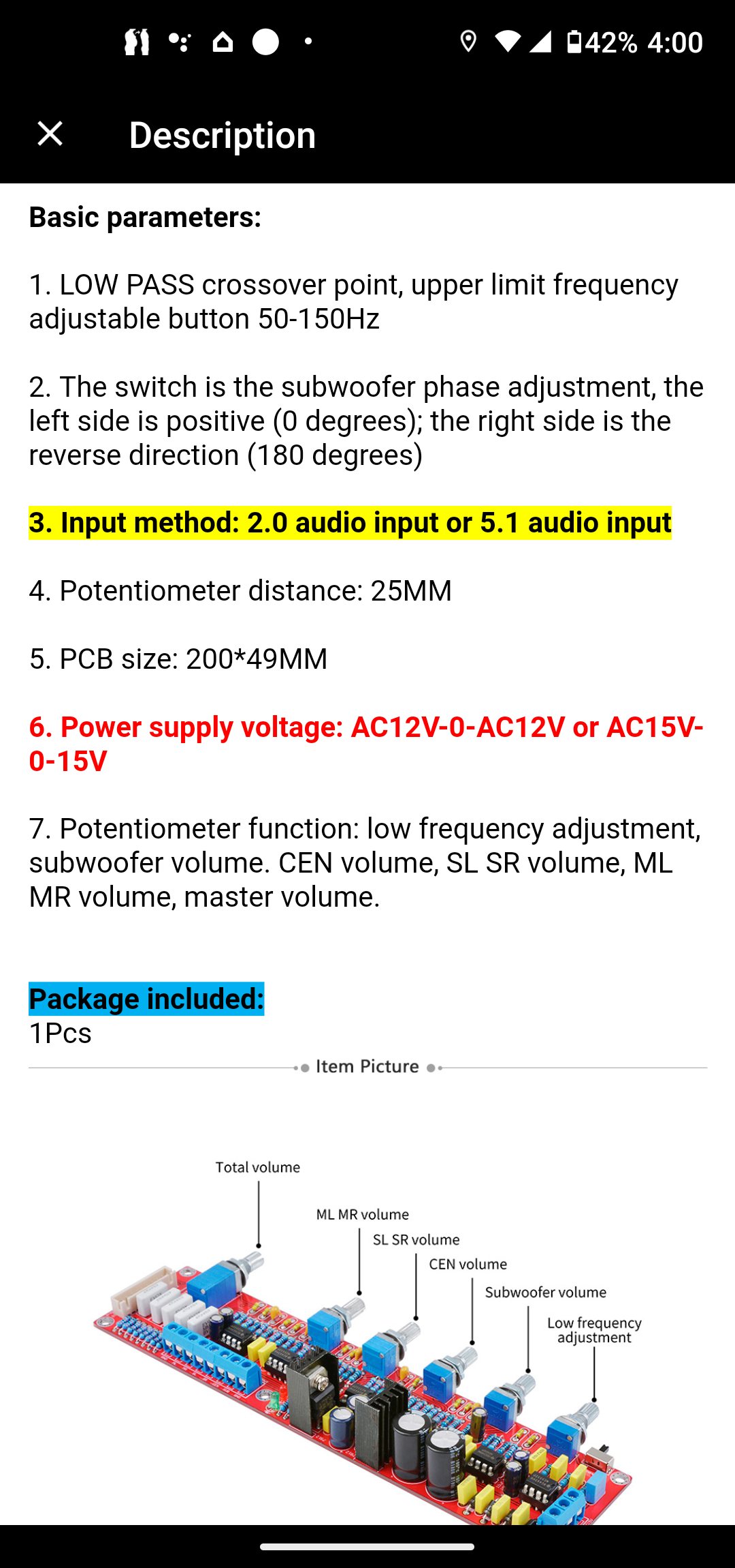

I've found some cheap Chinese boards (AIYIMA NE5532, AIYIMA NE5532 5.1 Tone Preamplifier Board HIFI 5.1 Preamp Volume Tone EQ Control Board DIY for 5.1 Amplifiers|Amplifier| - AliExpress) that look good, they have 5.1 and 2.0 inputs, but I don't know how do they behave with the 2.0 input. Can somebody that knows this kind of preamp tell me what happens if I connect a 2.0 input to the aux-l and aux-r? I see no switch to switch between the inputs, and my concern is whether this input would only be played in the stereo speakers, or the bass would go to the sub?

12 V ac will be ok
This is my opinion, without the schematic, hard to say, as the "manual" from the seller is not completely clear.
Not familiar with the unit, but it seems that it will do 2.1
with a with the tunable filter
I don't quite understand the purpose of your extended stereo, but all it may need is to feed the left into the left and left surround inputs on the amp.
