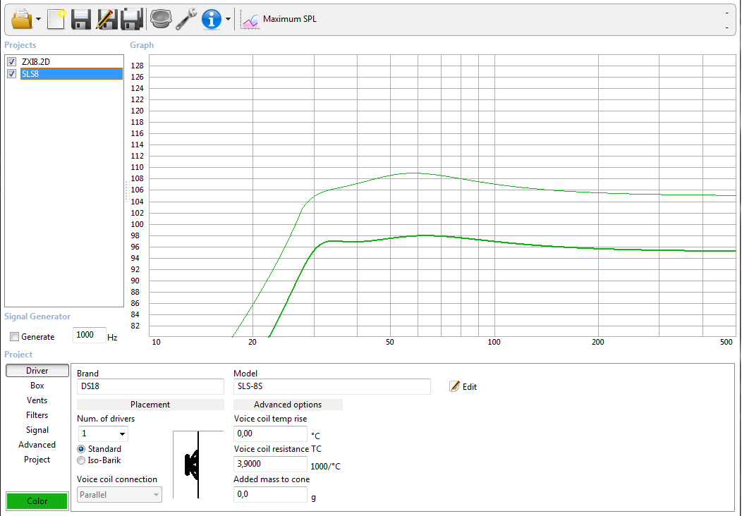

Guys, any help with interpreting this modelling data for the two drivers, please. I have set the boxes to the smallest I think I can get away with for each driver and f3 below 30hz and set input signal to driver wrms rating. Will be running stereo subs, so building two identical units. The ZXi8.2 shows way higher SPL, but I don't know if that is showing good clean output or distress. If it really is showing a massive improvement over the SLC8 then that what I will build. If in simulation, it's showing that the difference is not significant and drivers are not stressed then I would prefer to build the smaller boxed SLC8

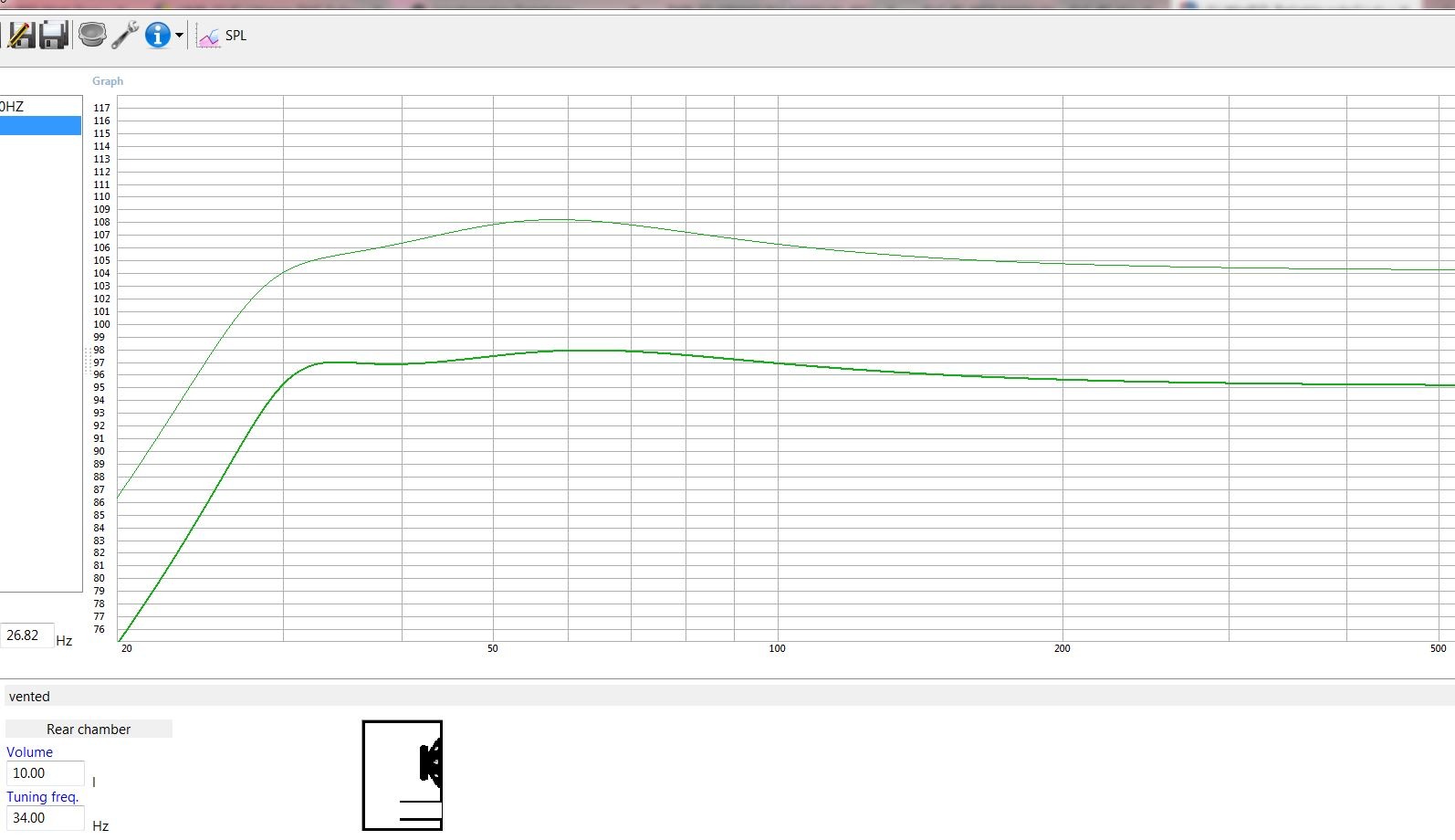

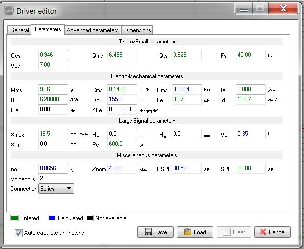

Dark trace is SLC8. I can draw a pretty line and make a pretty box, but honestly I don't know how to interpret this modelling data to know how much more prodigious clean output will I get with the larger and more expensive ZXi8.2 boxes. Hope I have entered the ZXi8.2 coil data correctly

The ZXi8.2 shows way higher SPL, in fact a single ZXi8.2 with 600 W seems to outperform two SLC8 cabinets with 200 W each.

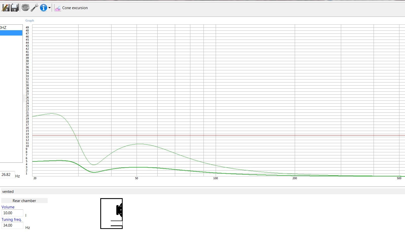

Looking at cone excursion both drivers are well within their Xmax in the intended frequency range, the ZXi8.2 goes beyond Xmax below 28 Hz and thus could use a high pass when driven with full power, the SLC8 doesn't need a high pass.

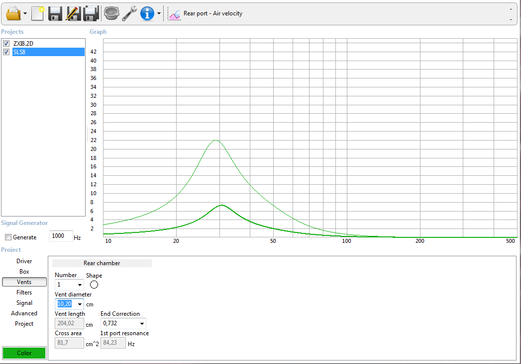

Looking at rear port air velocity, the ZXi8.2 has a decent sized port, the SLC8 has an oversized port (and thus could be made smaller).
RademakersThe ZXi8.2 shows way higher SPL, in fact a single ZXi8.2 with 600 W seems to outperform two SLC8 cabinets with 200 W each.
