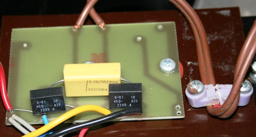

Hi All! I recently acquired an older Linn LP12 and I can't figure out if the power source is original or a non-Linn replacement. I know the unit is older (i.e. probably pre-1985) but I do not know when exactly it was purchased.
Any advice on what you see in the pics attached would be most appreciated. I will gladly answer requests for further info.

Go to the vinylengine library link which shows the history of how the LP12 evolved and the serial number sequence. This should give you a pretty good idea of when your table was produced.
Here is the Analogue Addicts LP12 FAQ page for more info.
I have an early wiring diagram in pdf format that I can email to you if need be. It looks like what you have in the pic.
Jeff
Many thanks,
CC99

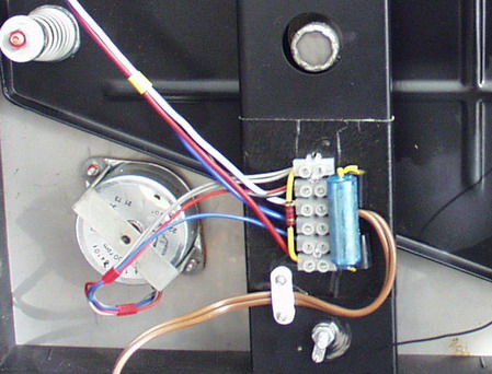

Once i had an even older Linn. There has to be a phase-splitting cap and a votage dropping resistor. The two extra cap are indeed to filter switching on/off noise.
