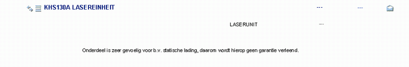

My supplier confirms what Nick says: Be extremely careful with static discharge on a KHS-130A. In normal alignment procedures
this shouldn't be a problem but when disconnecting cables you should take utmost care.
Keep us posted.
/Hugo 🙂
