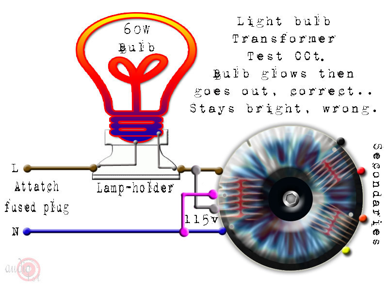

See this thread: http://www.diyaudio.com/forums/showthread.php?postid=1710752#post1710752

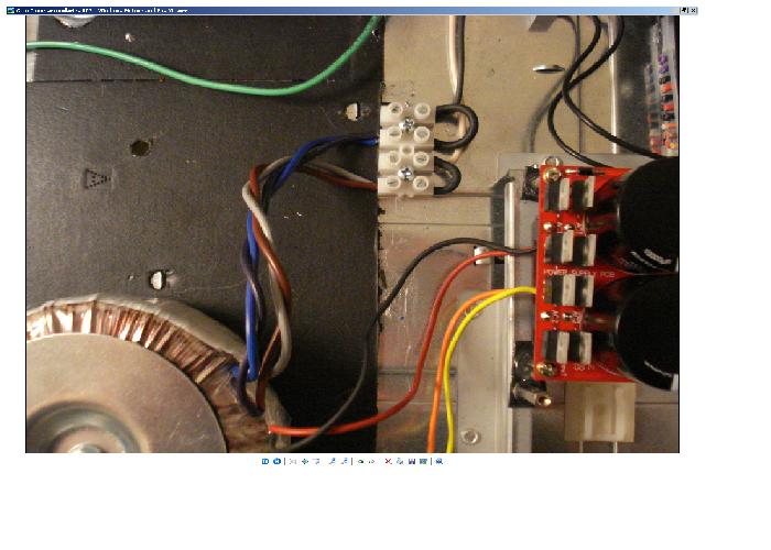

Thanks for all the help.
I think my xformers must be toast. I have a slow blow fuse rated at 250V at 5A with secondaries disconnected.
I'm getting measurements of 1.2 ohms to 3.2 ohms between all of the Primary wires doesn't matter which ones
Disconnect the xformers and the fuse holds. Connect either one of the xformers and "poof" goes the fuse.
This project was really fun. It is really close to being finished. I powered up the xformers to test the secondaries and now I'm $75 in the hole and 3 days waiting for new parts.
Oh Well chaulk it up to being a noobie and being too anxious I guess.
I'll order up another set.
thx -BB

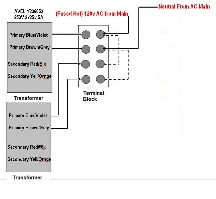

I miswired my mains switch where the AC(hot) from the fuse shorted to the neutral when the switch was flipped. I'm a dumbass as I looked over the switch 2 times verifying the correct wiring.
When I flipped the switch with the xformers connected the lights dim, xformers buzz then the fuse blows.

1.5 ohms is not short, it's normal reading for primaries impedance.
The only problem I could imagine is when you connect single primary to 115V mains and not two in parallel. Then the fuse would blow, but that still shouldn't damage anything.
Connecting the primaries (115V) , you connect the Brown/Grey to Hot and the Blue/Violet to neutral..
I wired brown/grey together and connected them to the AC (Hot) from the Sw.
I wired the Blue/Violet together and connected them to the neutral from the main. My neutral is not switched.

the two 110/120Vac windings must be in parallel to run from 110/120Vac mains.
BUT,
you can wire them in phase or out of phase.
One powers up and allows you to check the secondary voltage.
The out of phase acts like a near dead short across the mains. If the primary resistance is 2r8 for each winding then 110V across 1r4 (2r8//2r8) is about 8.6kW.
It does not take long for the winding insulation to break down with this heat input to the primary winding.
Always use a light bulb tester for first power up of any new or modified project.

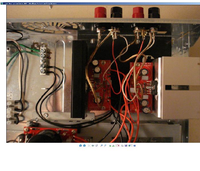

pic of the amp brds hooked up. I currently running with one transformer in stereo mode. hooked it up to some old speakers for testing then on to my Klipsch RF-62's. I think I have some tweaking to do as it sounds a little too laid back. It has probably 5hrs on it so it may need to be burned in.
Here is a pic of the amp brds.
