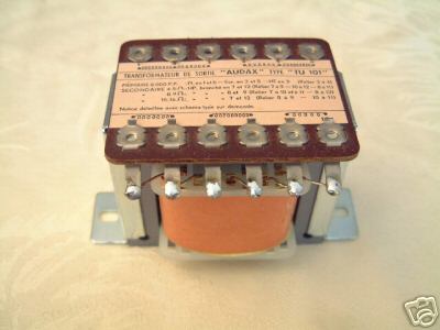

Hello again !
I asked a question about output transformers. Now I found on ebay 2 French transformers Tu-101 AUDAX, "universal" output transformers. They are push pull, primary impedance is 2 x 2000, 6000, 8000 ohms, max. poxer 27W at 25Hz, bandwith 15-40000 Hz+/- 1dB. Primary inductance 200Hy.
The selles says they can be uses for single ended too.
So, please, could I use them for SE ? It is true ?
I mean with the same good bandwith.
The tubes I have:
3 x 6L6GC
3 x 807
8 x EL84
I could make a push pull with EL84, but They are not matched.
What to choose, please?
many thanks
