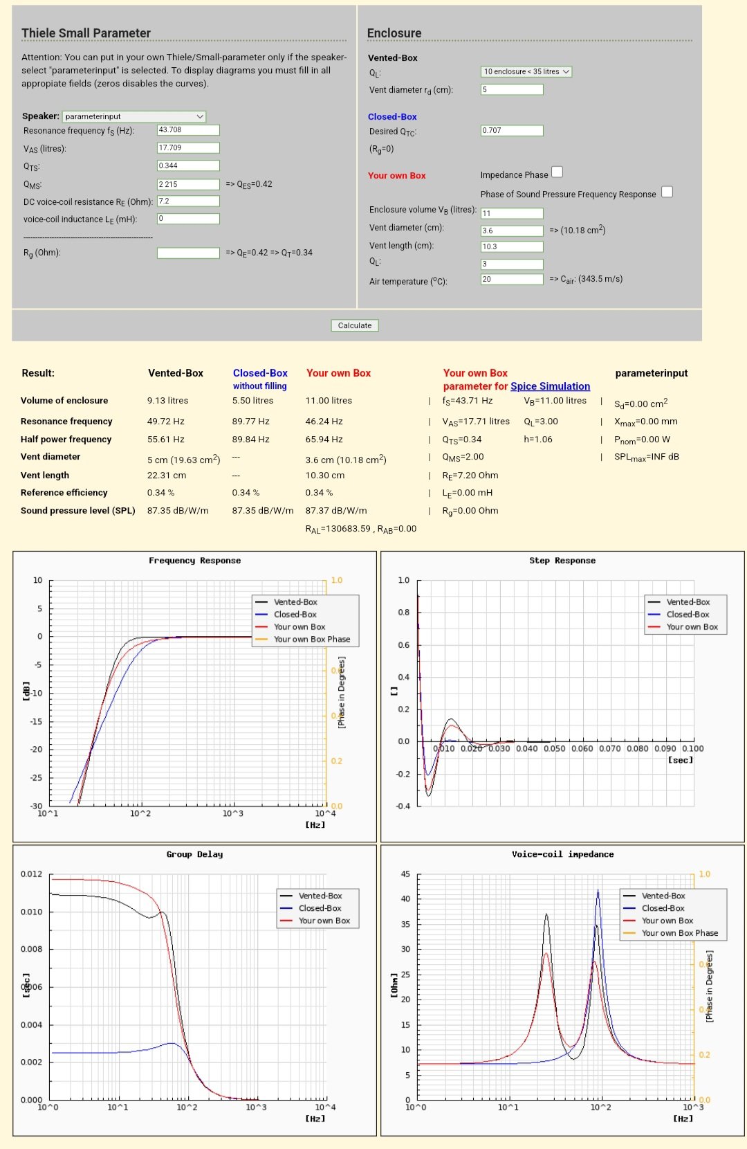

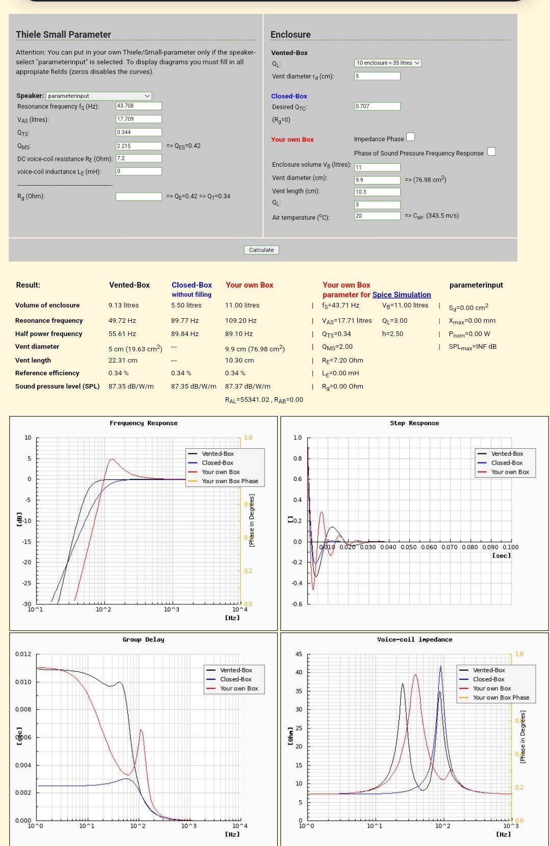

I have used the vented calculator you gave me a link to - THANKS! I used all specs for the alpair 11ms that looked correct.
Please see attachments. The first looks a mess, having left the vent as it is. The second I played around with the vent diameter, until I achieved the smoothest graph plots I could get. This meant reducing the vent from 99mm to 36 or 37mm.
The resonant frequency dipped to low 40s, which must be better, and the plots looked quite clean.
What I don't know is if these results, on paper, are otherwise any good!?!
Please can someone tell me 🙏

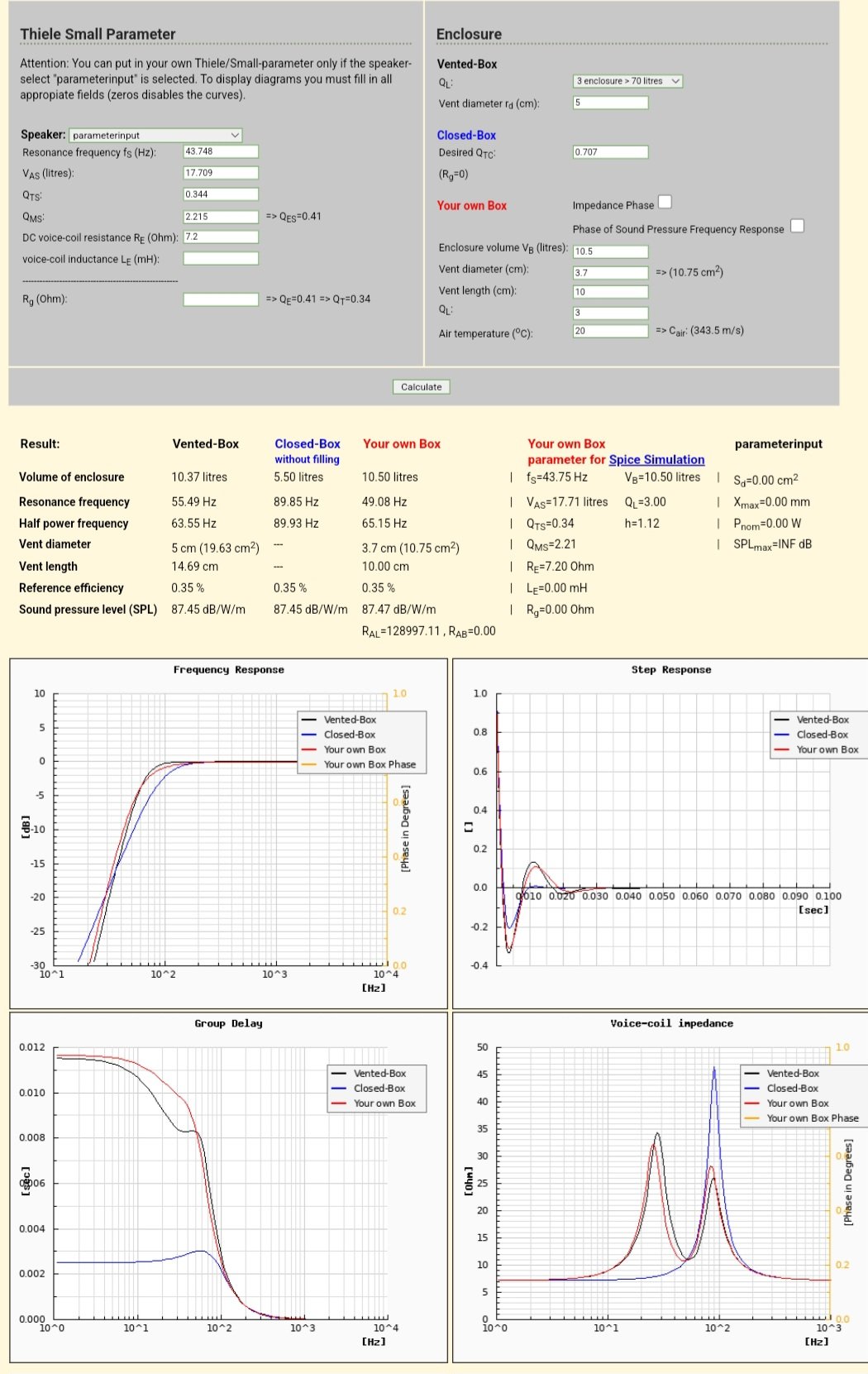

Well first, I don't know a lot more than you about designing speakers, but I figured I could point you in a general direction if no one else was around.
You want the area of the port to be no less than 1/3 of Sd (the cone area of the driver) as a rule of thumb. You don't want the air chuffing back and forth in a small port. I think the 3.6 cm diameter for your sims port is too small. The graph of the default cabinet that the calculator gives you looks better than your sim. You want to try to get the graph max flat like that or close as you can. Yours doesn't look bad though. The cabinet volume is smaller for the default cabinet (minor issue, if you need a smaller volume than your cabinet, you can glue styrofoam blocks in to reduce the volume), but the port is way too long.
High ratio diameter x length ports have a resistive effect that isn't what you want here. Ports are scalable for the same tuning as long as they have the same aspect ratio diameter x length, so making the port shorter you will need to make it's diameter smaller. So, increasing the diameter of your sims 3.6 cm port will lengthen the port, probably too long for the cabinet also.
I think you might need a slightly smaller driver with this cabinet, 5"? or maybe a different driver of the same size. But maybe someone who knows more than me has a better idea.
It will most likely be worse than your plot with the stock port dims. Don't forget the subtract the driver motor & vent volume, so the actual internal box vol. will be closer to 10 litres.
Otherwise I think you're on the right track. 👍

Taking all of the above on board, I've tried to be more accurate with estimates. For the record: Internal dimensions are: 368mm H x 226mm W x 135mm D = 11227cm3 or 11.2 litres.
  • Volume of Alpair 11ms = 0.627ltr.
  • Port Volume (3.6cm x 10.3) = 0.1ltr. = Total volume of 10.5 litres!
Plugging these back into the machine, I've managed by luck to flatten the first graph as attached. Changed port to 3.7 by 10cm
I must confess I dont understand the group delay plot, or step response...
As for the double impedance spike on the voice coil, is this better or worse then a single spike on the closed box plot? Harder work for my amp to drive at those frequencies is my limited takeaway.
But 87 db/w/m seems decent. I prefer sensitive speakers as some of my fave amps only push 14-18watts per channel 🙂
