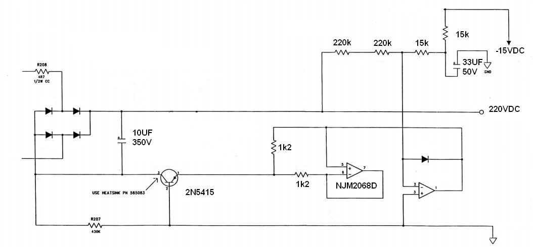

i've got a problem with an amp here that i can't figure out how to fix..
i've changed every single part (except the NJM2068, which i replaced with other opamps like the TL072 or 4558D), and i can't get the problem to disappear.
the problem is hum on the 220VDC output.. which is very audible through the tubes it feeds.
the whole circuit starts to oscillate.
-15VDC is stable, 10UF is also new..
the circuit did work for 15 years and i thought the 10UF or the opamp would do the job, but no.. anybody have any ideas?

the input is from the transformer, not directly from the wall.
i built a conventional power supply with a 3k9 Resistor after the 10UF and a second cap 33UF, but taking the ground from the power supply i get a ground loop hum. not nearly as bad as the hum from the voltage regulator, but audible.
