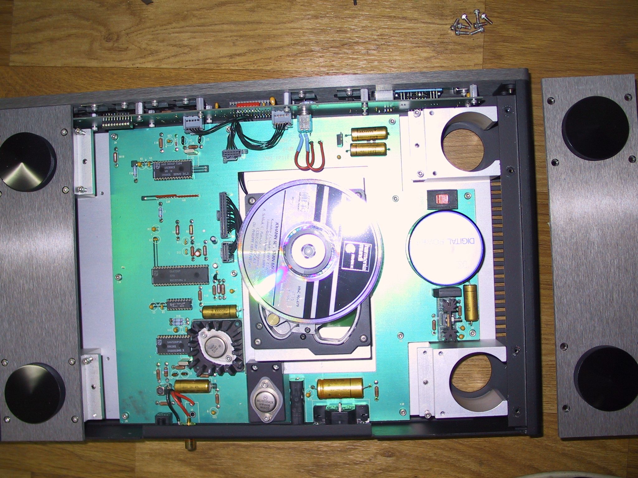

😕Hi Guys,
I have a Krell CD-DSP and suddenly the remote control stopped working basicly the mainboard contains all vintage philips like the cdm1mk2 and the following chips:
mab8461,mab8441,saa7210,saa7220,and one chip i don't know called lattice gal 16v8a.
Krell made its own da converter board with its own audio output circuits wich is on top of the mainboard.
Everything works ok also when i use it as a separate converter. The rc receiver gives a signal on the scope and this signal seems to go through the lattice gal 16v8a but nothing happens, some other strange thing i noticed is that the safety ir eye (omron) wich sees that there is a cd on the table and switches the laser on is also not working, i tested this and the ir led and photo transistor are ok and the player play's the disc normal.
Another thing i noticed that when putting the mains on i have to switch the power button two times to get the player reading the toc and i can press play. When i let the power on and the player is in standby i reacts normally when i press play.
All the front buttons and the display work normally and all voltages from the ps are correct as far as i can measure without a sevice manual.
Anybody an idea to help me out i really love this vintage machine with it's beautifull perspex cover.
Thanks alot Rene.

This requires the service manual or quite some reverse engineering.
On the GAL, this is programmable logic. So you can put in whatever you like (e.g. AND, OR etc gates. Outputs can be latched). So you can't just replace this chip with another one as it will be either empty, or worse contain the wrong logic.
I've got these chips and a programmer, but can't help for now.
MAB's are the micro controllers running the player.
First check your powersupplies, start with the gal i guess.

The sticker on the GAL shows which revision of software is inside, i guess.
I guess you tried to connect in and outgoing pins opposite of each other of the GAL? Problem is that you can define anything inside, so the opposite output pin could well be driven by not the opposite input pin. Or many of input pins, etc. Why it is used will remain a mistery untill you find the service manual or do severe re-engineering. Take it out and see what output reacts on what input, assuming the gal is o.k...
One of the GAL pins is a clock input to latch other outputs (if programmed to do so). You might check if there's a clock on that pin. Which would explain maybe a bit why the gal is there. Another option would be that it blocks certain signals towards the mab's during reset.
Swapping the MAB's is not a good idea.....! Yes, controllers contain code. Which sets certain i/o pins to input and certain to output. So you might have connected a controller output to other logic also set as output by swapping. And it's easy to destroy something....

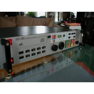

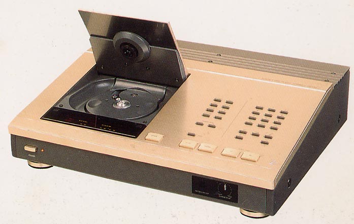

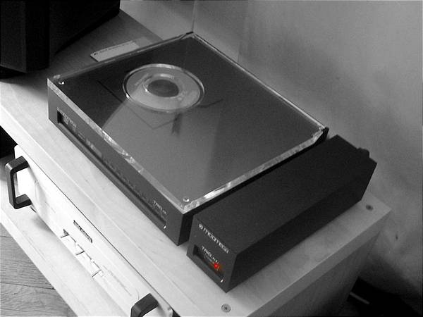

CDM-3 was used additional by only few models:
Studer A730
Luxmann D-500x
‚c-‚T‚O‚O‚w�f‚r
Micromega Trio (first edition, MK-I)
http://www.diyaudio.com/forums/digi...ega-solo-trio-cd-f1-first-edition-wanted.html
Barco-EMT 982 (not sure)
The most used swing arm philips drive are CDM1-MKII and a wide range of variation CDM4.
Barco, mmm: http://www.review33.com/m/forum_msg.php?db=1&topic=58090730085102&number=16&sort=1
