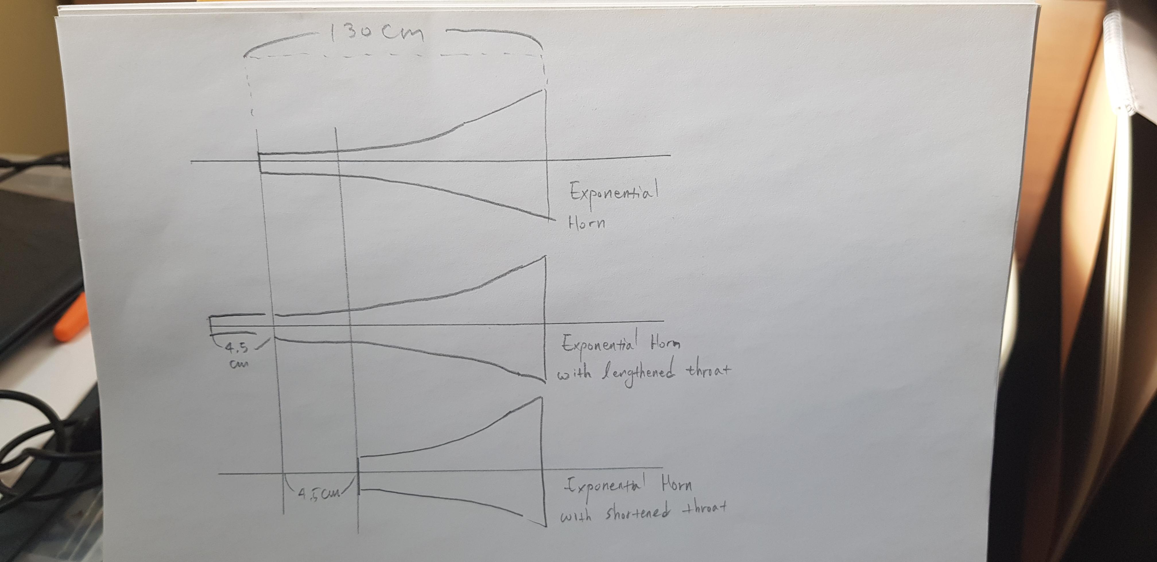

I am trying to build a folded exponential horn with a collapsible throat, for a mechanical phonograph project, which will also be used with a tiny fullrange unit.
Would a throat lengthened/shortened about 4.5cm have any audible difference in a 130cm horn's sound quality? 😕
The horn will have a throat of 16mm, a mouth of 75cm in diameter, thus reaching down to 228.8hz...
