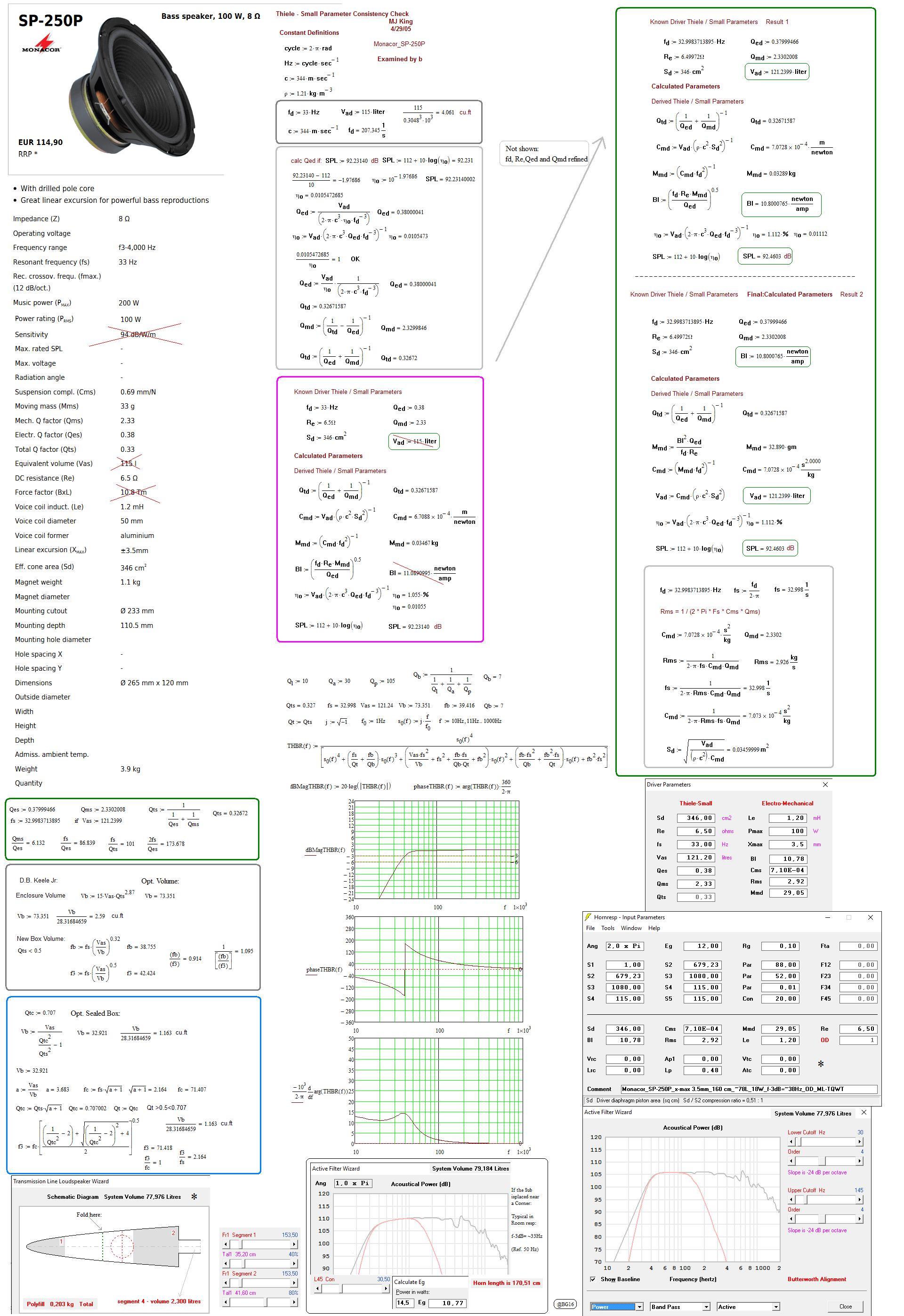

I can't decide which type of box and measures to choose for this 10 inch woofer (Monacor SP-250P)
Can anyone make a good suggestion?
It will be used for Home Cinema, room with some conditioning, LowPass Active Filtered@24db/oct, freq. selectable.
I think it's good for Bass Reflex or Bandpass Box but I don't reject other arrangements (I'm still learning how to calculate and/or simulate Horns:snail:)

OP, You already have a TL type project from bjorno.
For a different app. large reflex type, look at enclosure and alignment VB = 94.0 L, FB = 33.0 Hz with 2x 6cm (diam) x 10cm (lenght) type vents.
(it's a good idea to protect the driver under 25Hz)
