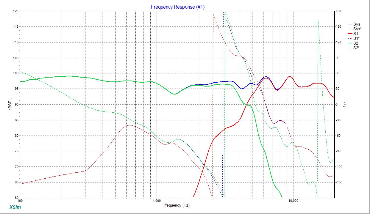

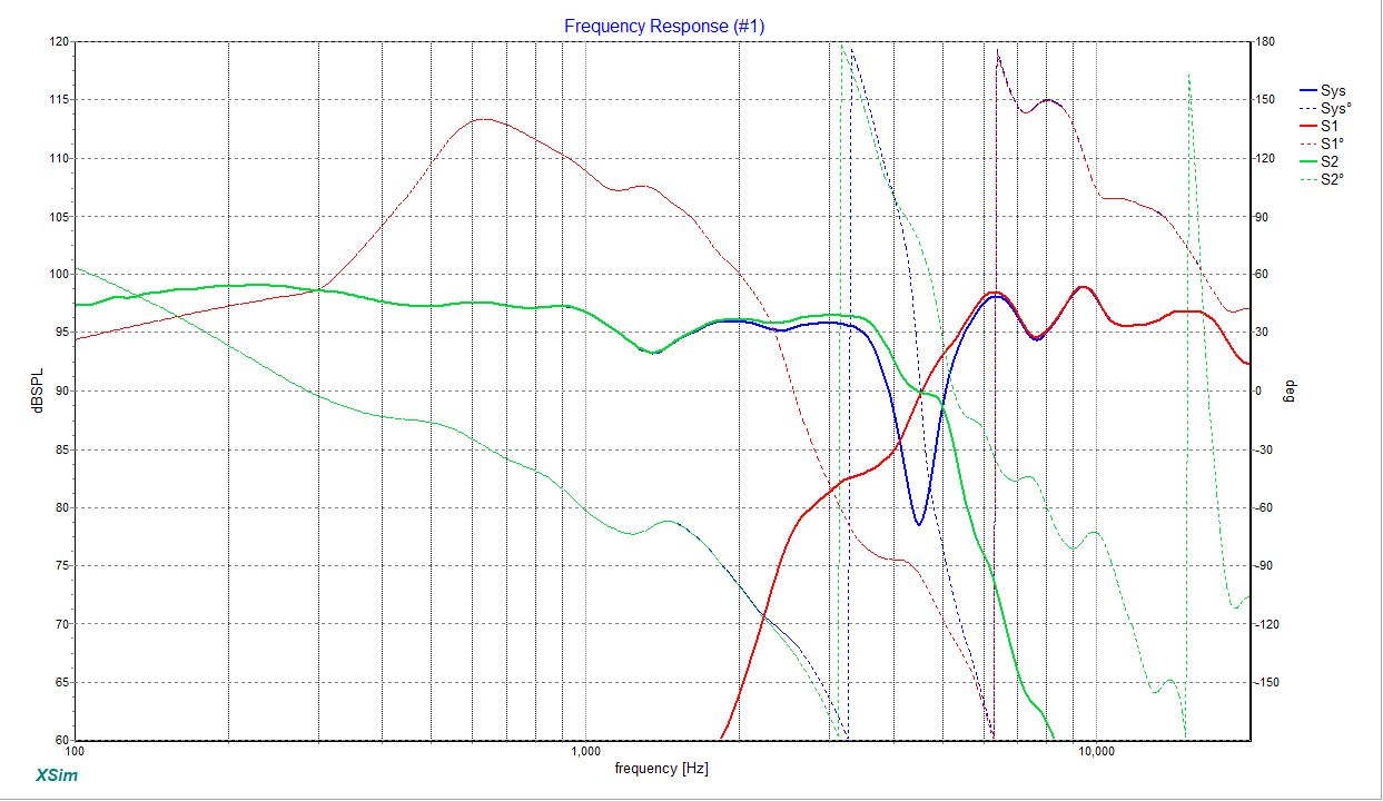

So I'm building some compact-ish bookshelf speakers and some input on my crossover design would be very much appreciated.
I get a deep null but there is phase overlap only on one side. Would that be a problem? Is there any way to fix this and make the phase responses match better? I've played around with the components, changing values, adding or removing parts, but nothing so far has fixed it. Am I overlooking something?

Firstly, I notice that by the time phase is 90 degrees apart near 2k3, the tweeter is down by almost 30dB. So it's not the end of the world.
I can see your slopes are a little different, you might consider working to a target slope.
Are your measurements clean?
I don't think that looks too bad.
When you get into something like this keep your expectations realistic. You can't achieve "textbook" results in the real world.

A target slope means same slopes on both drivers?(dumb question, sorry)
I got my FRD and ZMA from the dayton audio website which probably isn't optimal.

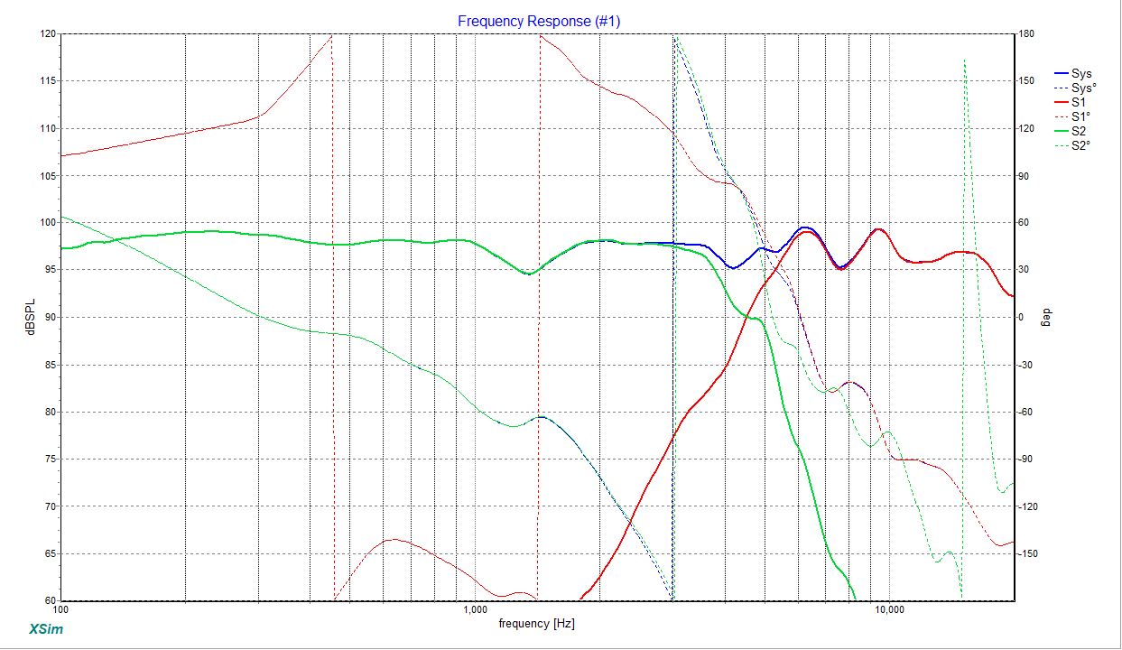

Ok yall so this is where I'm at currently.
As you can see the new FS is not as flat with 6db amplitude between highest and lowest point(used to be 4). The reverse null is not as deep as before. The phase plots look a lot better though.
So I guess my question is, is this set up generally better? Should I prioritize phase matching or reverse null depth/width etc. Also what is a good reverse null depth and is this enough?

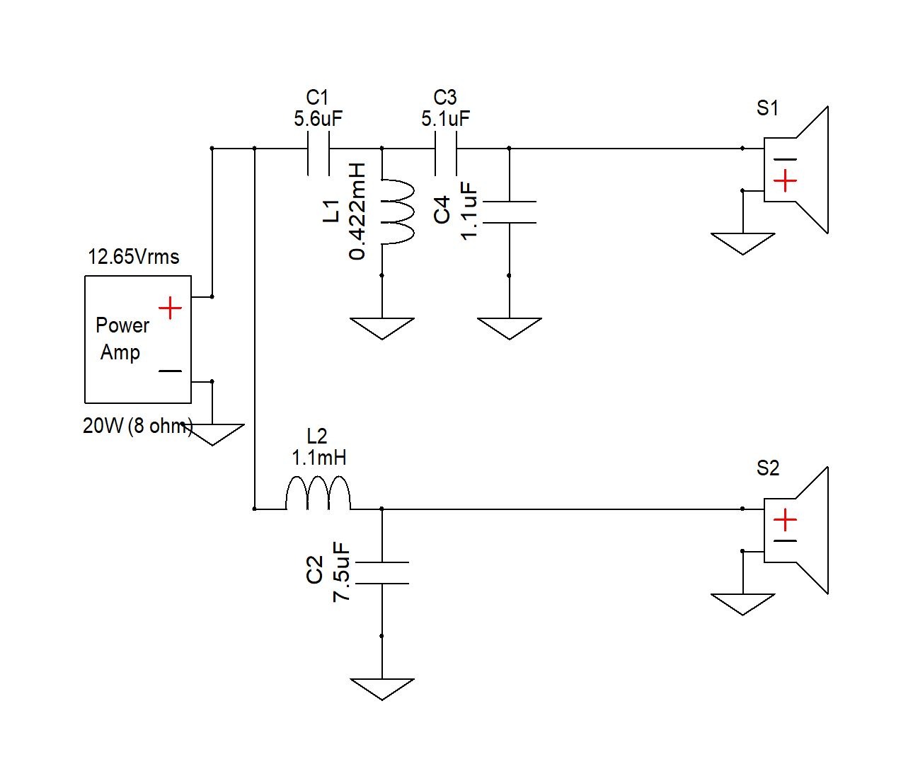

Firstly, you need to get rid of C4. It is a short circuit hazard for your amp at higher frequencies.
Secondly, the reverse null test is not necessary. This is something people use when they don't have phase information.
Soooo I don't have to look for a reverse null?Firstly, you need to get rid of C4. It is a short circuit hazard for your amp at higher frequencies.
No, but if it makes you feel better 😉 You see the information is in the phase plots. If the phase lines up where the responses cross then there would be a null, it's as simple as that. In fact some crossovers aren't even supposed to line up that way, there would be no null for them.
